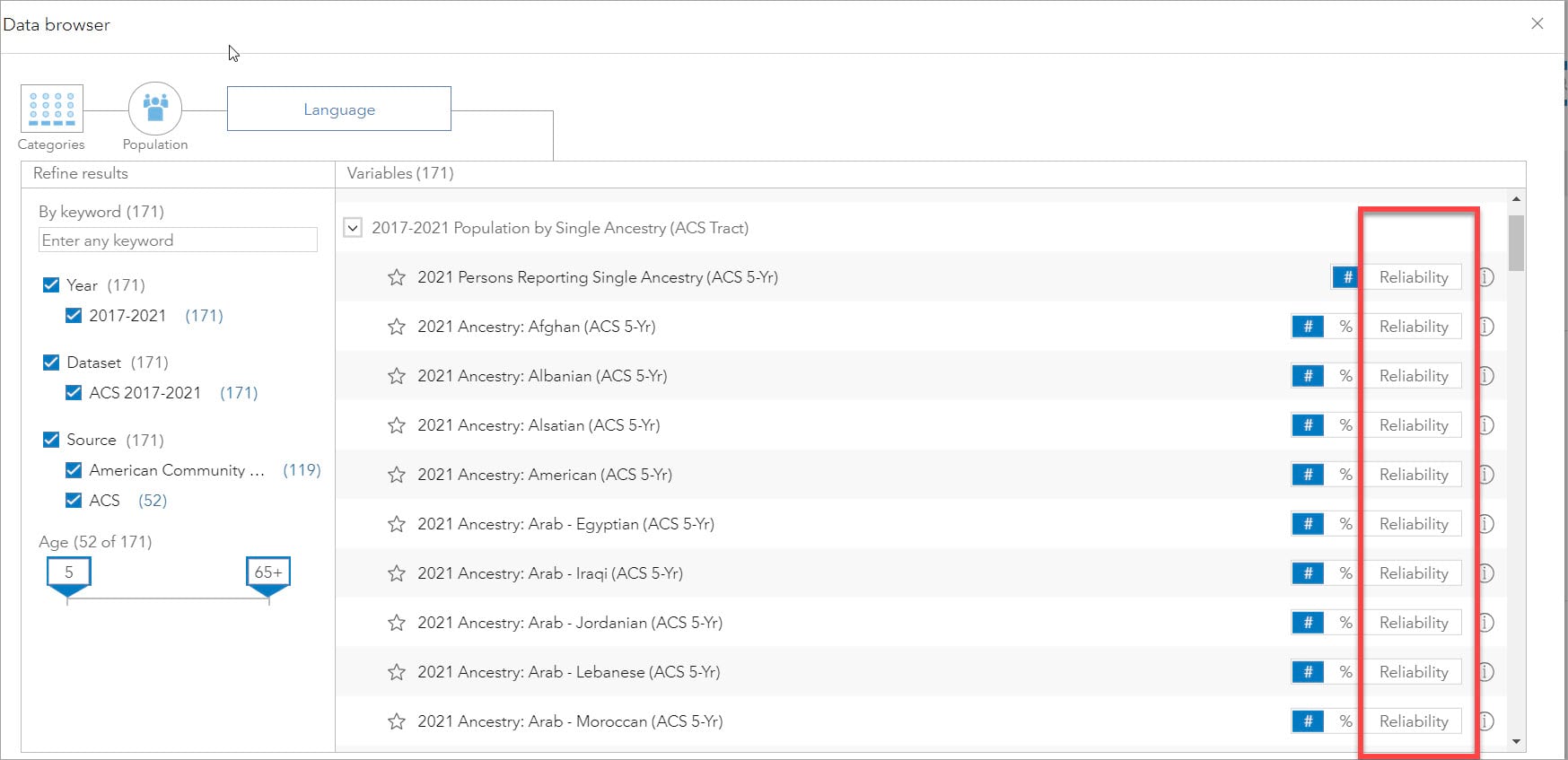

Have you ever wondered about the Reliability button located next to the count and percent options in the data browser when searching for a variable in ArcGIS Business Analyst?
Variables that show the Reliability button in the data browser have—in addition to other calculation options like count and percentage—a reliability score.

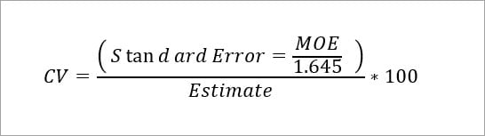

The coefficient of variation (CV) is calculated as the ratio of the standard error to the estimate itself, expressed as a percentage. We can calculate it using the following formula:
Using this formula, we first obtain the standard error by dividing the margin of error (MOE) by 1.645 (for a 90 percent confidence interval) and then divide it by the estimate. The result is then multiplied by 100 to express the CV as a percentage.

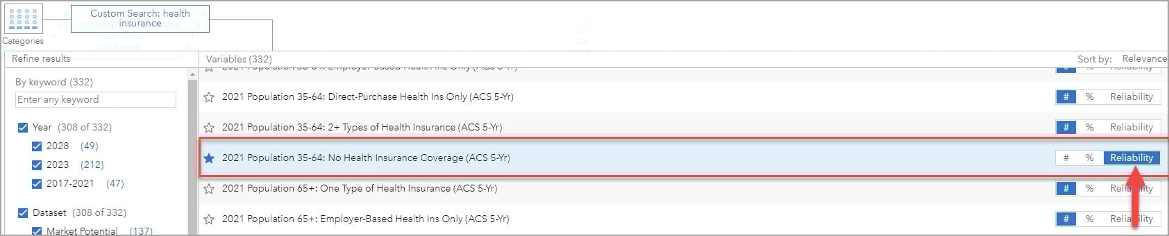

Suppose you are a business analyst working for a healthcare company. Your goal is to identify the population lacking health insurance. To achieve this, you utilize ArcGIS Business Analyst Web App, which allows you to access the relevant variable through the data browser. The data browser not only provides the count and percentage of the uninsured population, but also offers the reliability of the estimate.

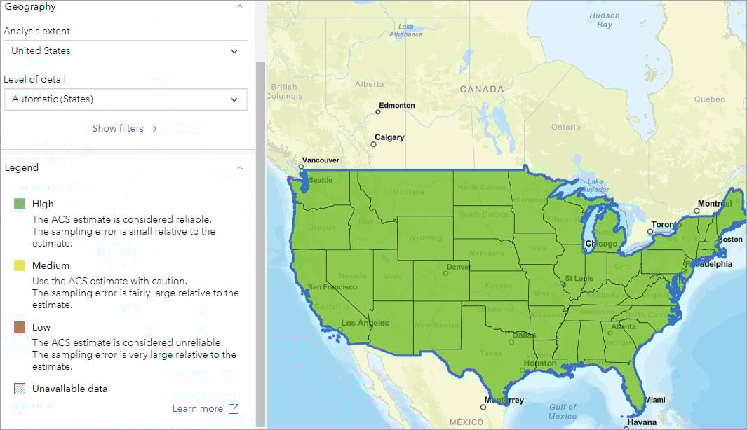

When you select Reliability for the population (35-64) variable shown in the image above, you will get a map that displays reliability of ACS data for population in the U.S. between the ages of 35-64 with no health insurance coverage at the state level. Looking at the map legend on the left panel, we can see that all data is reliable at the state level.

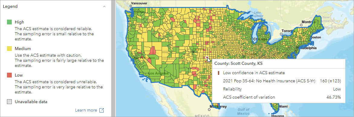

However, when we change the analysis extent to counties instead, we see that there are several counties in the U.S. for which this data is unreliable since the sampling error is very large relative to the estimate.
