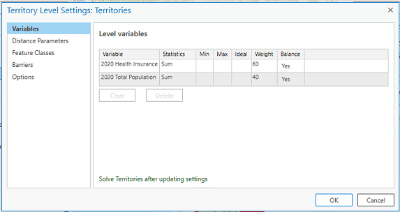

The Territory Design ribbon now contains a new properties dialog that displays the level settings. The dialog allows you to review and manage the territory level settings. Once edits have been made to the level settings, the Territory solution must be re-solved to reflect the changes. The Solve operation can be executed immediately after the modifications or deferred to a later date, when you can manually run the Solve Territory tool.  The level settings dialog is an easy way to review or change the settings applied to your territory solution.
Territory Design level settings
Level Settings

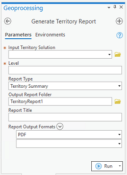

Another way to review and evaluate the territory solution is through reports. A new geoprocessing tool in the in the Territory Solution toolset allows you to create a report for a single solution or a comparison report to compare two solutions. The Generate Territory Report tool is a good way to review statistics of your territory solution and compare how it is similar to or different from another solution.
Generate Territory Report Geoprocessing Tool
