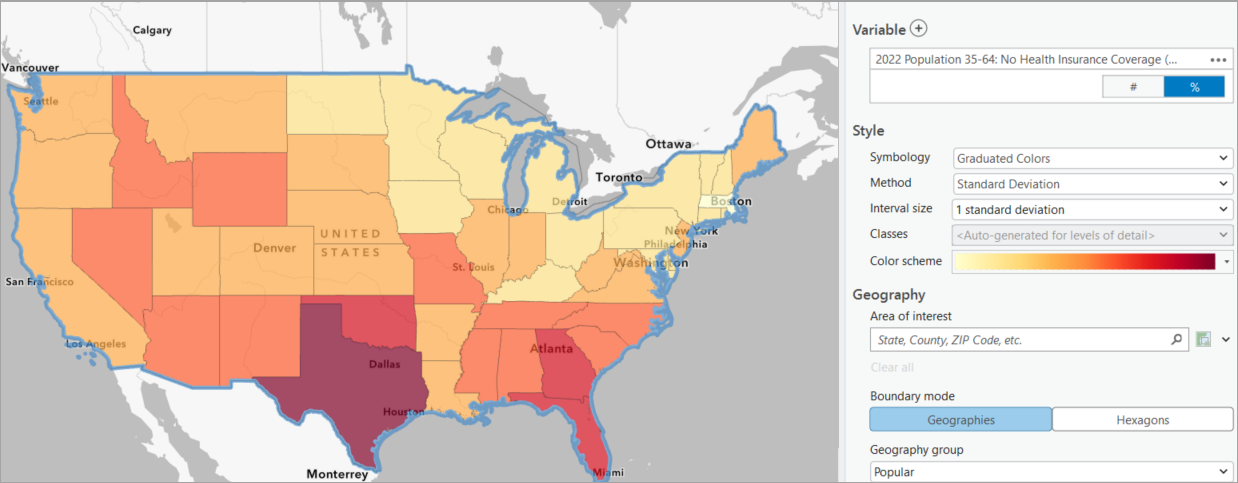

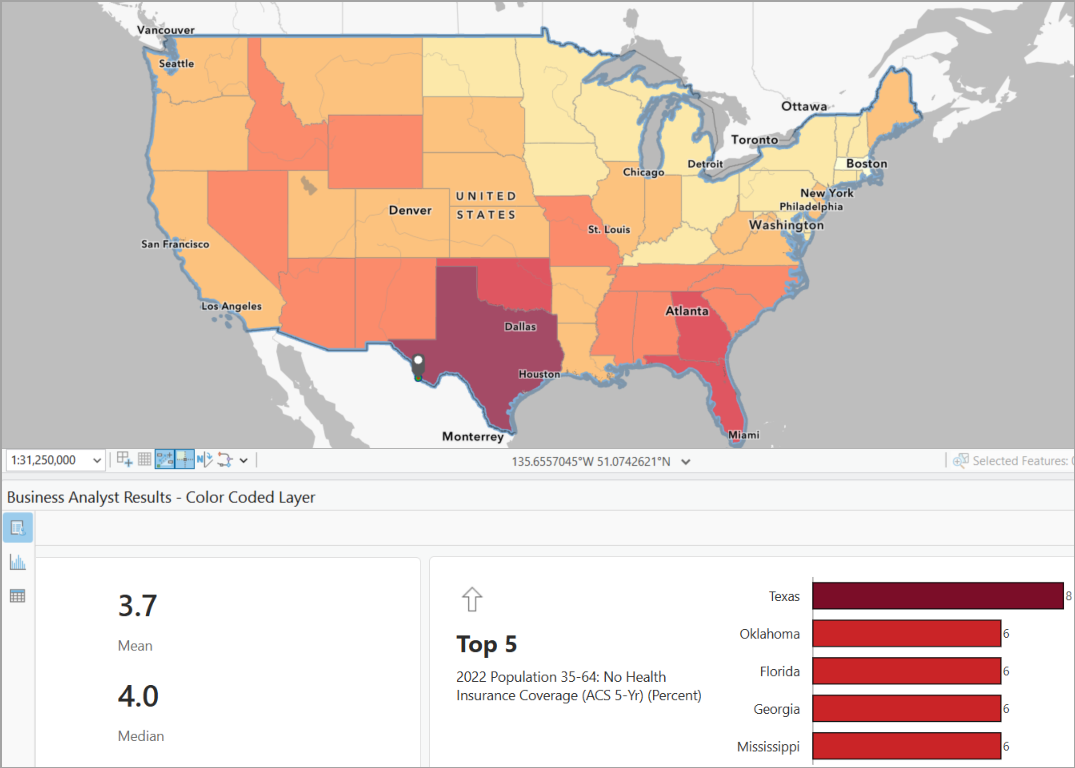

  • In the data browser search bar, type “Health Insurance” and press Enter.
  • From the list of results, check the box for: 2022 Population 35–64: No Health Insurance Coverage. Be sure to select the percent (%) metric for comparability across counties.
You’ll see a single-variable map showing uninsured rates across the U.S., with Texas clearly standing out in a darker shade—indicating a higher percentage of uninsured adults.
Color-coded layer showing a single variable

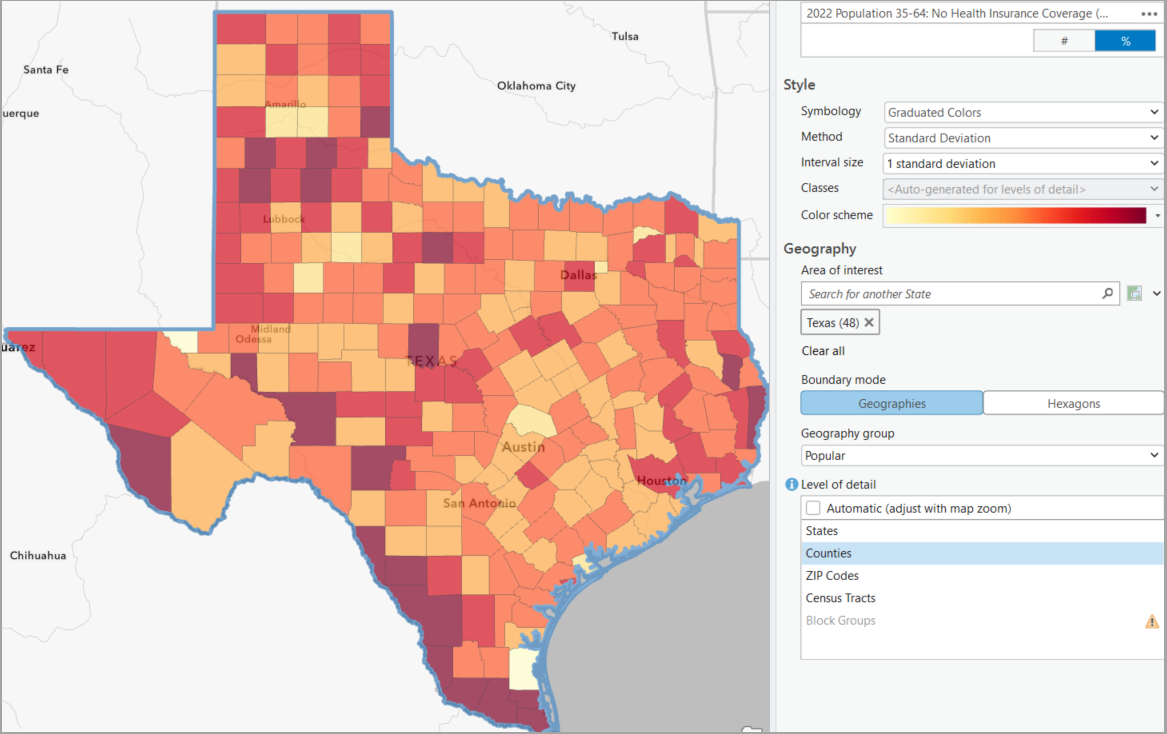

On the Symbology pane, go to the Geography section and set the area of interest to Texas. The map will automatically zoom in. Then, under Level of detail, select “Counties” to display the data at the county level.
Uninsured population by county

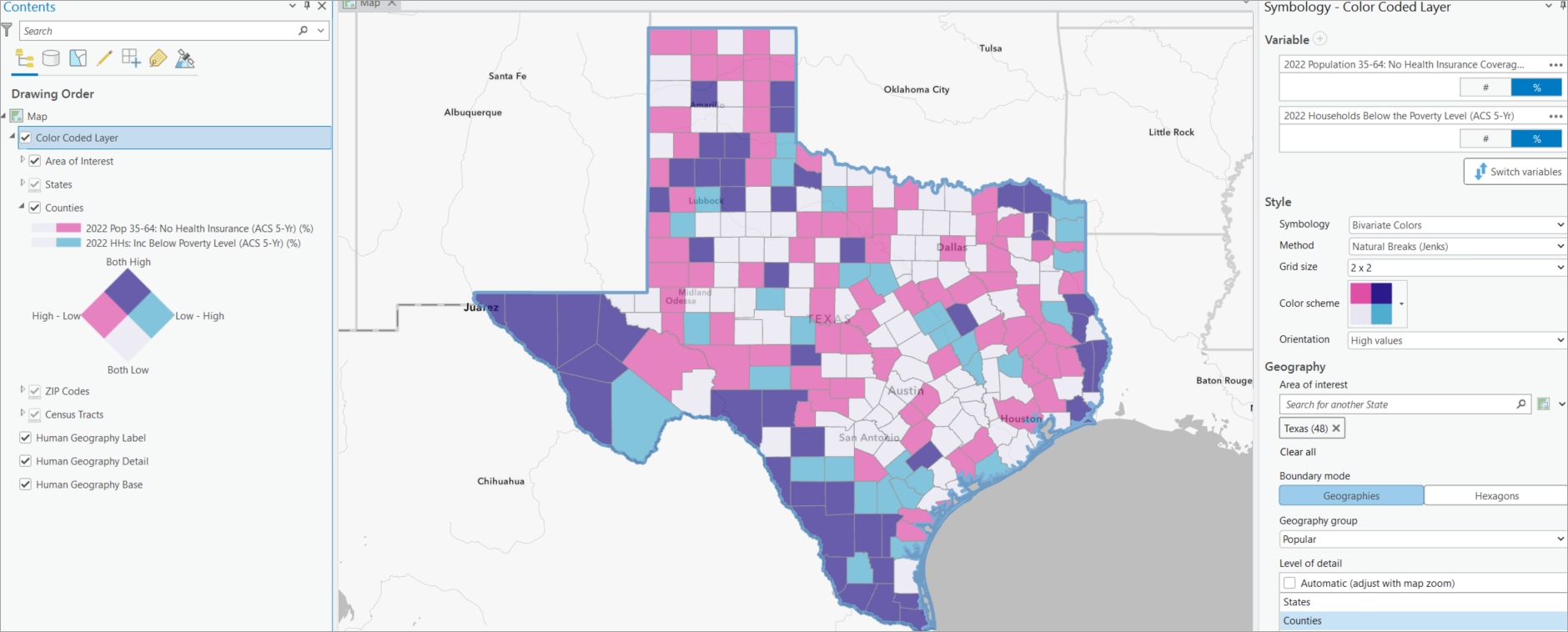

Add a second variable (poverty rate)

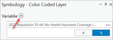

Return to the Symbology pane and add a second variable
Adding a second variable
  • Search for “Poverty” in the data browser.
  • Select “2022 Households Below the Poverty Level” (percent).
Adding this second variable creates a bivariate map where color blends represent the overlap of both indicators. Set the grid size to 2×2 and the orientation to highlight high values. Dark purple indicates counties with both high poverty and high uninsured rates.
Bivariate map in Business Analyst Pro

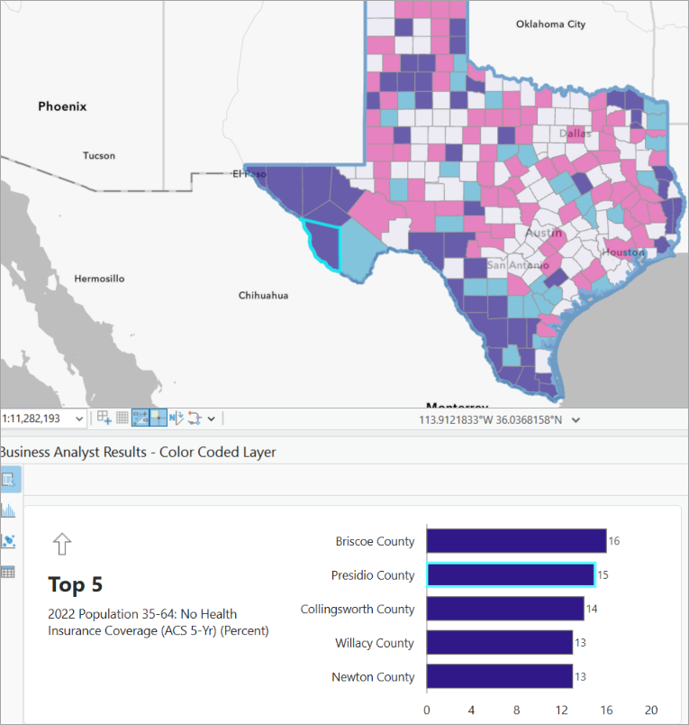

Click View Results to open the Results pane and identify counties with the highest combined burden.
Results pane in color-coded layer workflow
In the Results pane, you’ll see a ranked list showing the top 5 counties for each selected variable. Presidio County stands out in this analysis—it ranks among the top five for the percentage of uninsured adults aged 35–64, at 15%, nearly twice the Texas average of 8% and four times the national average of 3.7%.
Presidio also has a poverty rate of 31%, further compounding the challenge. Its rural, border location presents additional barriers to health-care access, making it a strong candidate for targeted outreach.

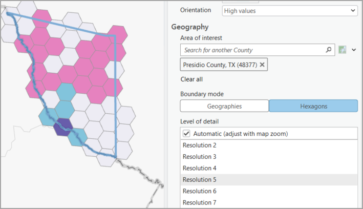

Step 2: Zoom into a target county and apply hexagon binning

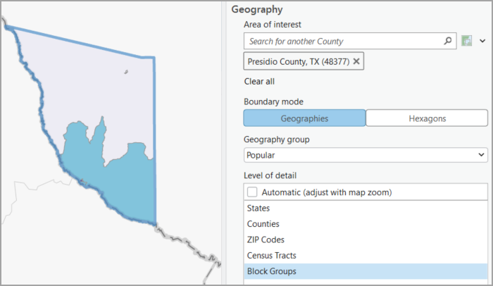

Set Presidio County as the area of interest. While you can use census tracts or block groups, these administrative boundaries are often large and uneven in rural areas, which may obscure important local variation.
Level of detail menu

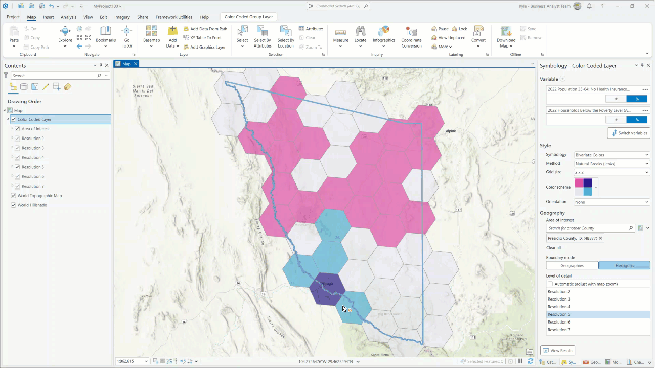

To gain more detailed insight, switch the Boundary mode setting from Geographies to Hexagons. Hexagons create a uniform grid across the map, with evenly sized units that enable consistent spatial comparisons. Unlike census block groups, they are not tied to administrative boundaries, making them ideal for detecting patterns that might be hidden within larger, irregular areas. This level of granularity is essential for identifying specific zones where outreach efforts such as mobile clinics, health navigator visits, or resource distribution can be most effective.
Changing hexagon level

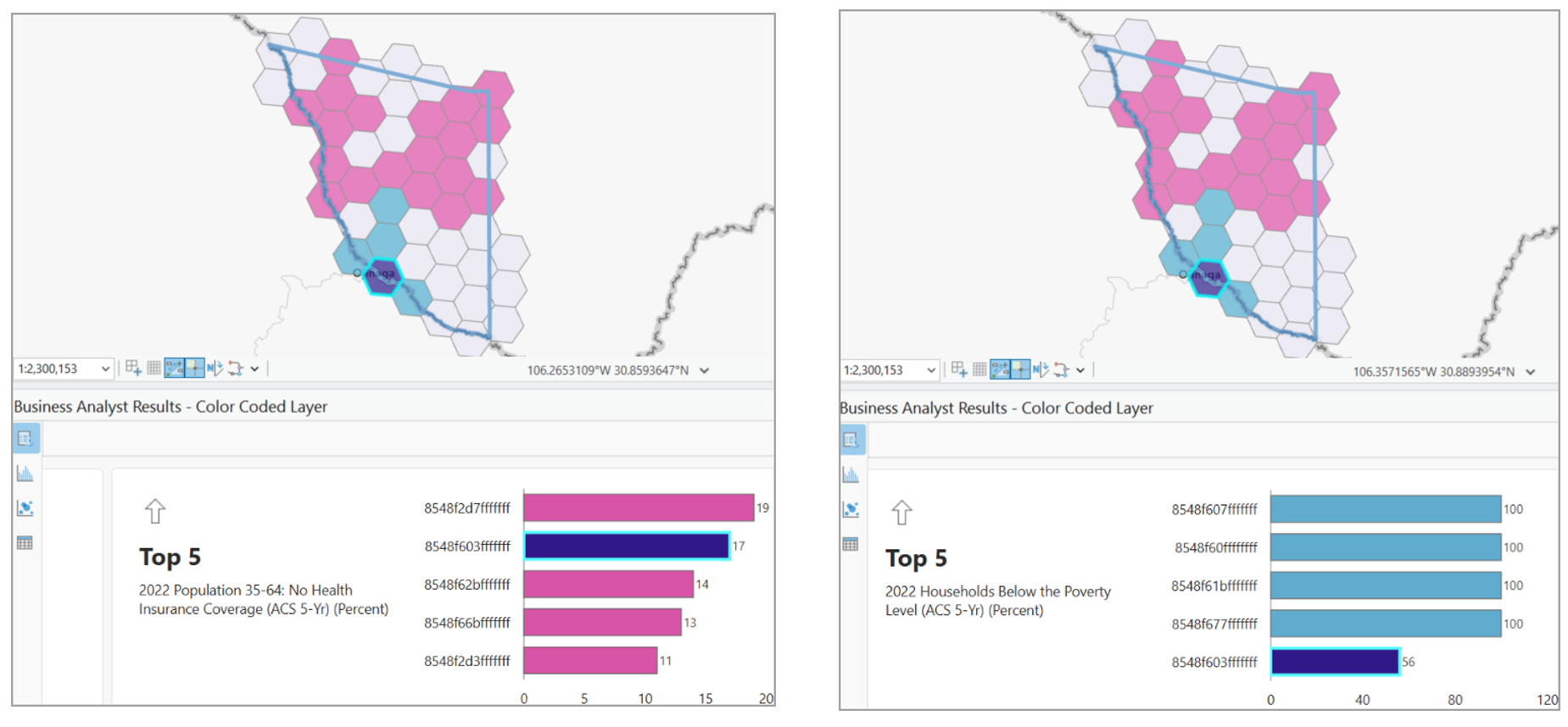

One hexbin in southern Presidio County emerges in dark purple— indicating high values for both variables. The Results pane reveals concerning statistics for this hexbin:
  • Uninsured rate: 17% — more than double the Texas average (8%) and over four times the national average (3.7%).
  • Poverty rate: 56% — compared to approximately 13% statewide and 11% nationally.
