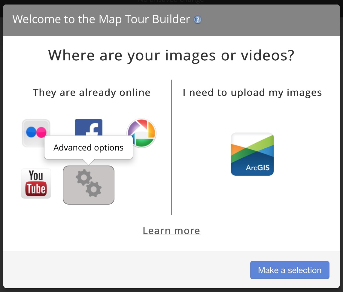

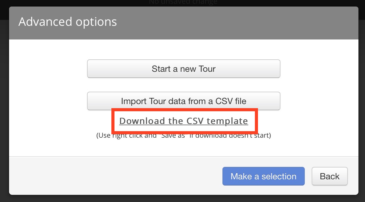

First you’ll need to download a CSV template that has the required fields and field names needed by the Map Tour app. Go to the Story Maps Apps page, click Build a Map Tour, choose Advanced Options, then right-click Download the CSV template.

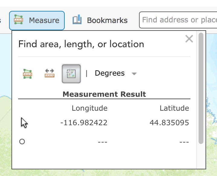

If your photos are geotagged you can get the latitude (Y) and longitude (X) by looking at their Properties on Windows or choosing Get Info on a Mac. If your photos don’t have geotags you can use the Measure tool on arcgis.com to find coordinates for the locations where you want to place your tour points.

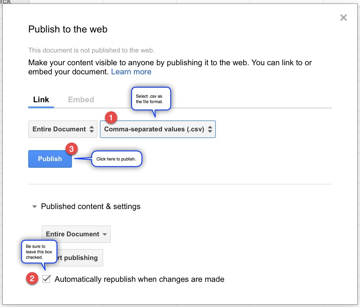

Once your file is ready choose Publish to the web… from the File menu. Then 1) choose CSV as the format, 2) make sure auto-republish is enabled, and 3) click Publish to make the file available on the web for your Map Tour.

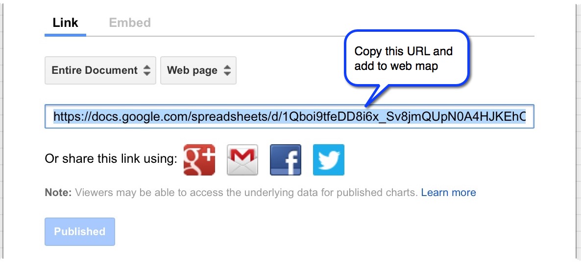

Copy the URL of the CSV; you’ll need it in the next step.

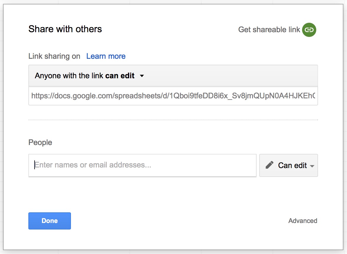

At this point you can optionally invite others to edit your spreadsheet. Just click File…Share… and enter the email addresses of your colleagues and make sure “Can Edit” shows next to the addresses.
Or, to open the editing up to a larger group, choose Anyone with the link can edit under Link sharing. There is the possibility that the quality of your Map Tour will be compromised with this approach, so be aware of the risks of crowdsourcing and be sure this complies with your project goals and organization’s policies.

Log in to arcgis.com and create a new web map. Then add the CSV file as a layer using Add > Add layer from web using the URL you copied in the previous step.
