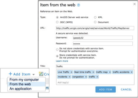

Well you need to embed a login with the layer itself and share it. To do that you need to create a map image layer inside of your content that includes the username and password. Tap “Add Item”, choose “From the web”, ensure the type is ArcGIS Server web service, paste the URL for the World Traffic Service layer (“http://traffic.arcgis.com/arcgis/rest/services/World/Traffic/MapServer”) itself into the URL, add your username and password, make sure to choose the option to “Store credentials with service item” and then just give it a meaningful name.

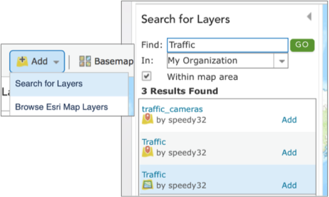

Now that you have an item for the World Traffic Layer in your content, you can add that new Traffic item to your web map and the credentials will be stored within the layer itself. Within the map, click “Add” and select “Search for Layers”. Then type Traffic in the Find dialog. This will search your organization and locate your new layer. Add it to the map and save it!

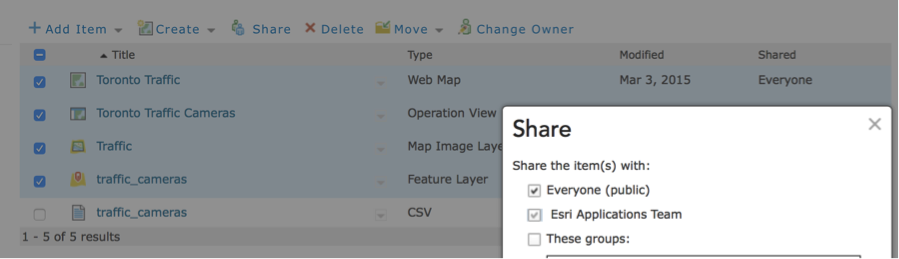

Now that you have your amazing operation view again, you need to share it so you can badge up! First all those items need to be shared with Everyone! Within your My Content view, select all of your items and then click Share. Make sure that you check Everyone so that you ensure public access! You might want to take a look at the editing properties of any feature layers (like the traffic_cameras layer) and disable editing!

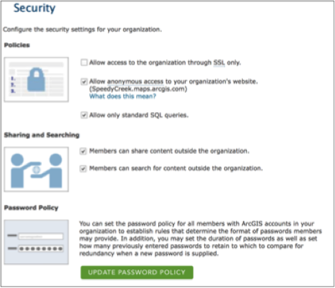

There are a couple of other things you need to consider when sharing stuff publically if you haven’t before. The Administrator of your ArcGIS Online subscription needs to support your endeavors to share content publically. Within the Security settings of your organization, make sure that you Allow anonymous access to your organization. Also make sure that members can share content outside of the organization. Finally, if you have modified the Password Policy so that a user’s password will expire then make sure you remember to update any items that embed credentials!
