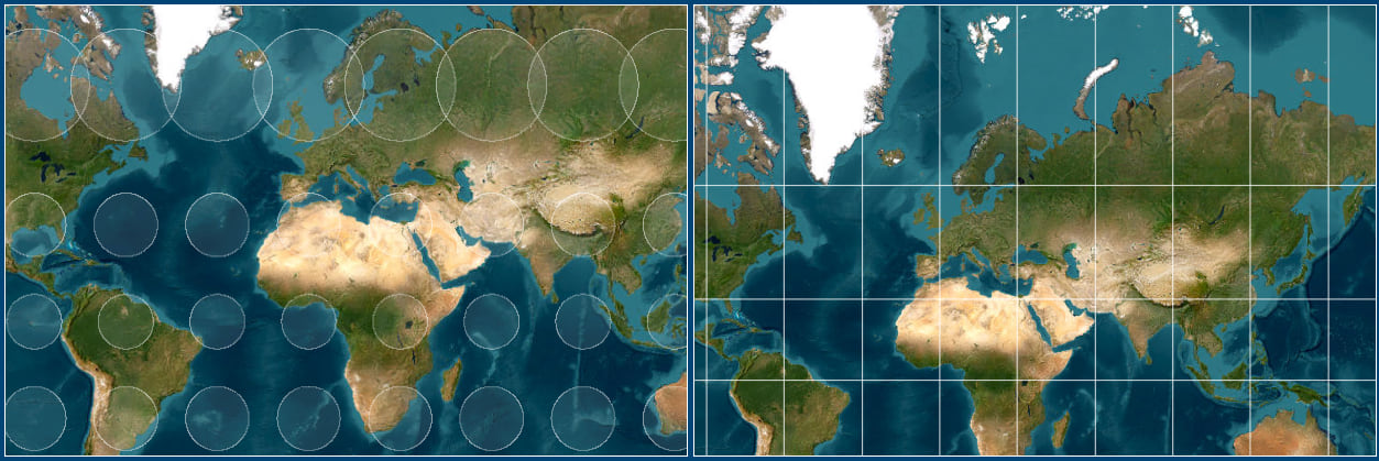

For example, the most common projected coordinate system is Web Mercator. Most online mapping platforms use it, but it distorts the true size of land near the poles. In Web Mercator, Greenland looks about as large as all of Africa. In reality, it’s only about the size of Chad (based on the rough visual reference I just did while writing this).
Map distortions in a world map in Web Mercator.
Map distortions in a world map in Web Mercator. The circles (Tissot’s indicatrices) on the left, and the squares on the right near Ecuador are distorted as they move toward north and south. When a circle is projected onto a flat surface through the map projection process, the result is an ellipse. Source: Esri 2023 https://geoxc-apps2.bd.esri.com/Visualization/Distortion/index.html

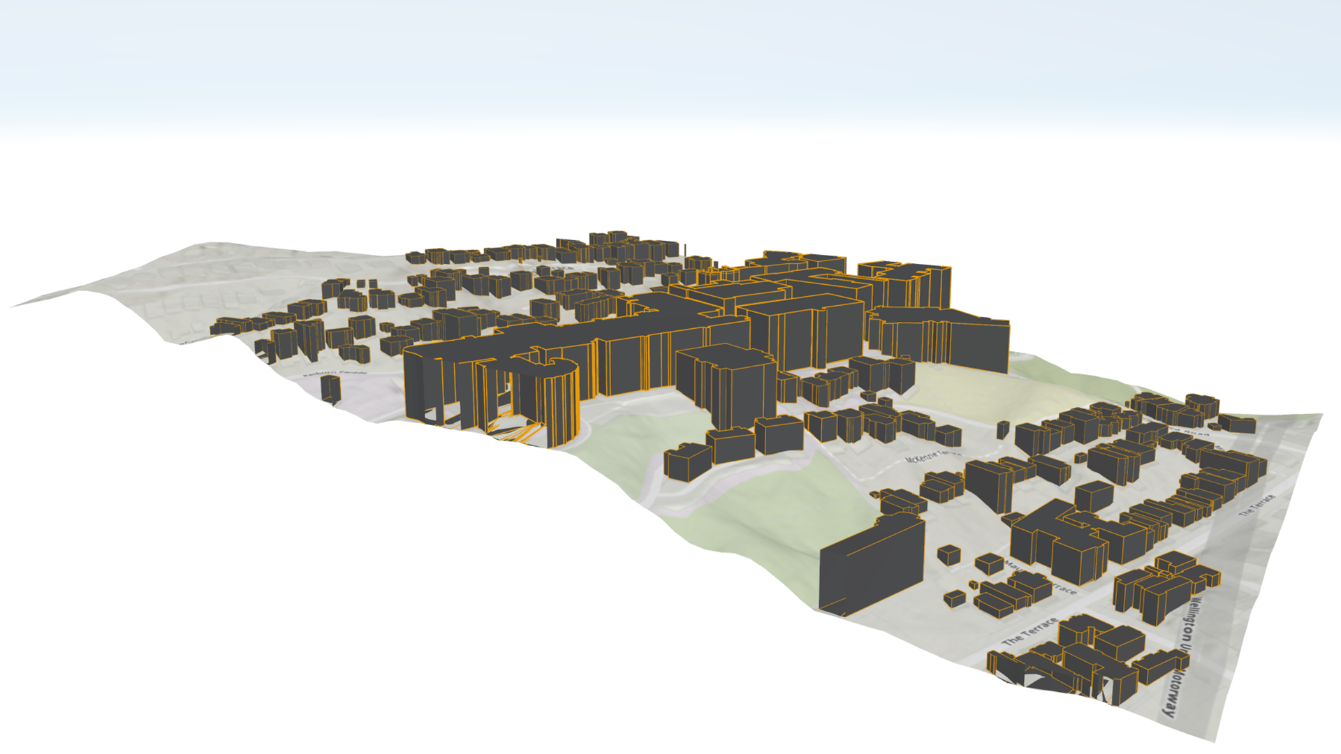

Local scene overview
A local scene, clipped to an extent

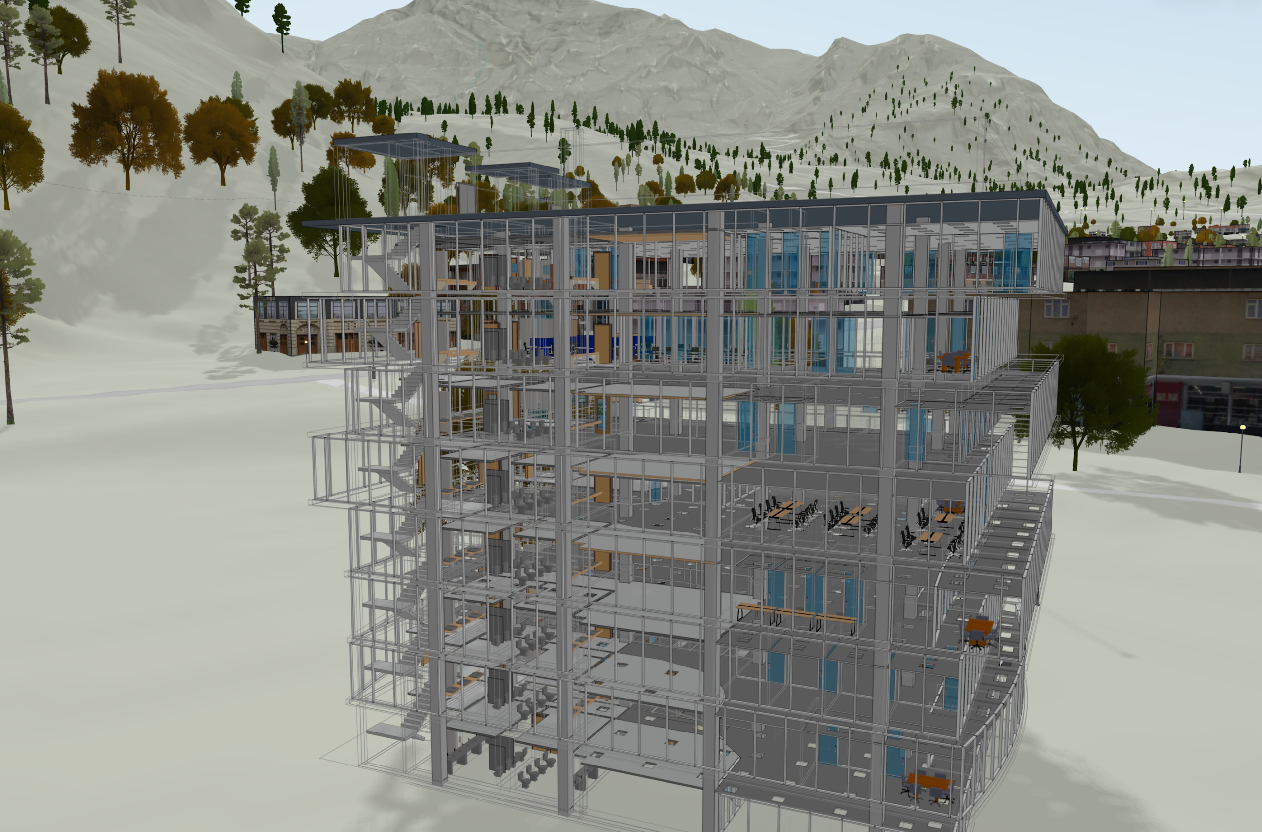

The image shows a highly detailed Building Scene Layer rendered in a local scene. The walls of the building are hidden so that the inner architecture is exposed to the viewer
A highly detailed Building Scene Layer rendered in a local scene
