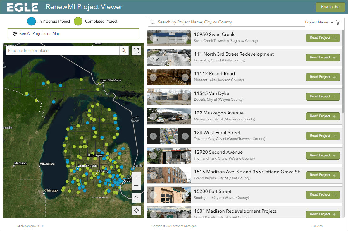

Screenshot of the RenewMI Project Viewer
Open the app in a new tab

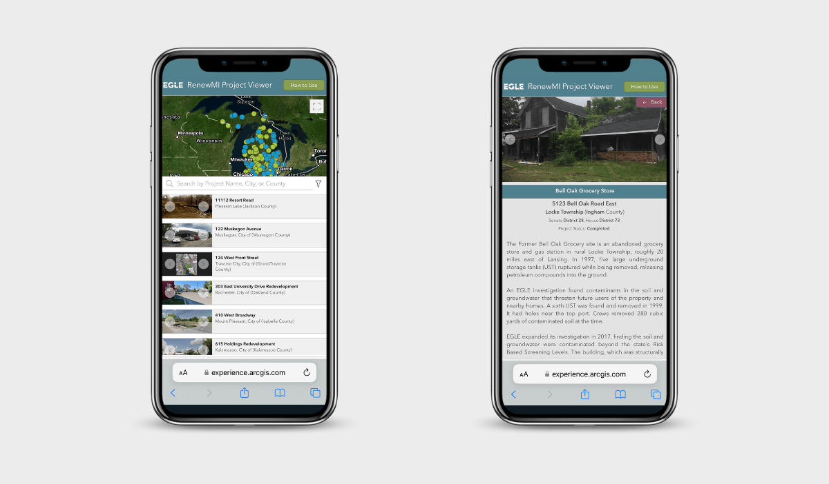

Two phones displaying the project viewer application
The app's mobile interface

Kate: Our goal for this app was consistency and to look as close as possible to what it looked like in the first version (Story Map Classic Tour template). So, we have the map on the left and the list/project descriptions portion on the right.

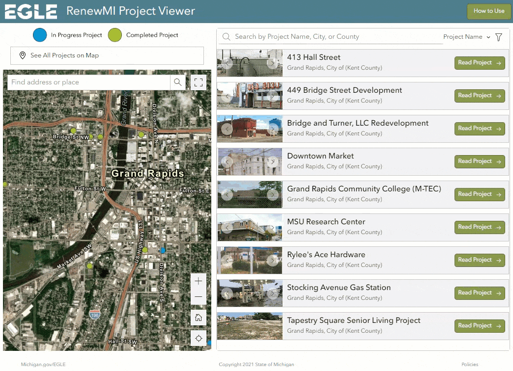

The List widget shows the projects within the current map extent
The List widget updates to only show projects within the current map extent

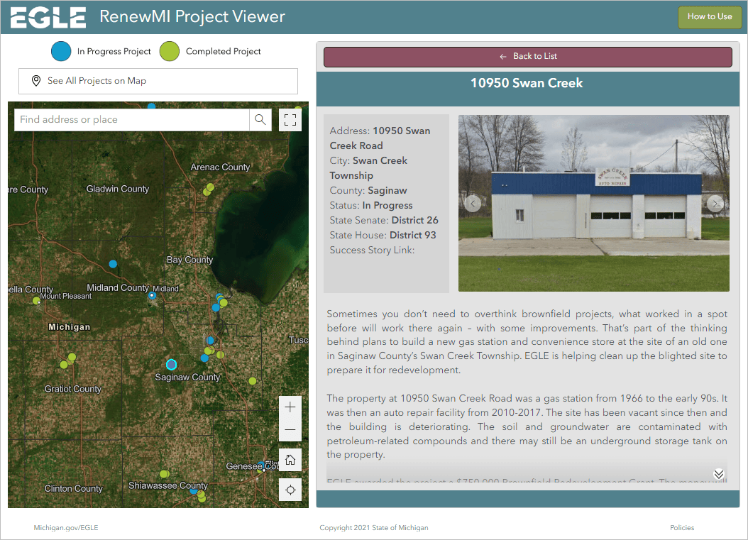

Screenshot of the 10950 Swan Creek site's project details
The right side of the app is made up of a Section widget with two views. One view, shown in the GIF above, contains a List widget. The other, shown here, contains Text widgets with dynamic text that changes based on the selection.
