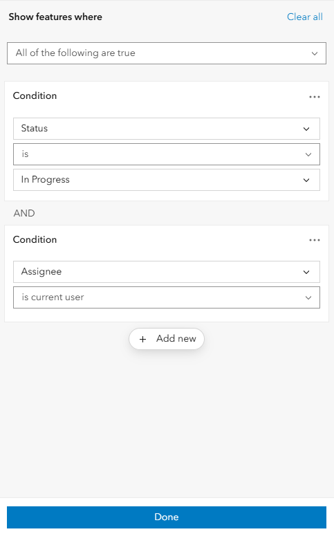

  5. Click the Filter button on the right-hand side of the selected layer.
  6. Add the condition “Status is In Progress“.
  7. Click add new. A new condition box will appear. Set the condition to “Assignee is current user“. The operator “is” should be replaced by “is current user“, and the third condition box should disappear. Confirm the drop-down at the top of the filter panel is set to the default statement, “All of the following are true“.

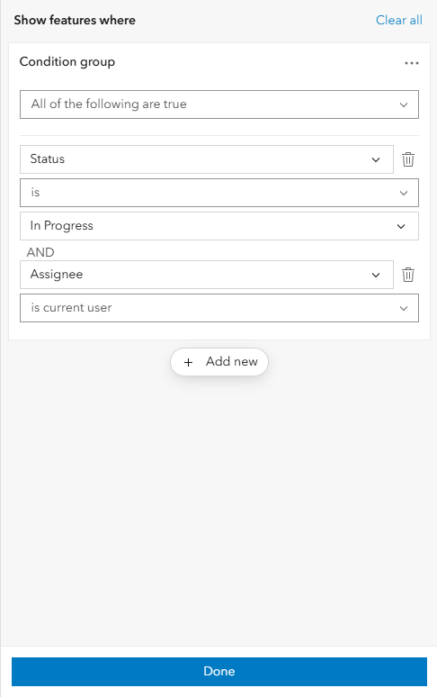

    A different way to do this step is to group the two conditions so that they may act as one if additional conditions are added. To achieve this, click the three dots at the upper right-hand corner of the condition box and select add condition. A Condition group will form. Ensure “All of the following are true” is selected.
    Adding this condition ensures that location sharing will only be activated for the user assigned to the task when the task begins.
Here’s what the final configuration should look like:
Filter configured to show features where Status is In Progress and Assignee is the current user as separate conditions.
Separate Conditions
Filter configured to show features where Status is In Progress and Assignee is the current user with conditions grouped.
Conditions grouped
