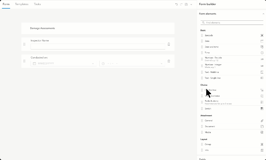

1. On the Form tab in Field Maps Designer, drag the multiple choice form element onto the canvas of your layer.
2. In the Display name, enter your question: “What damage was observed?”
3. Click Create choices.

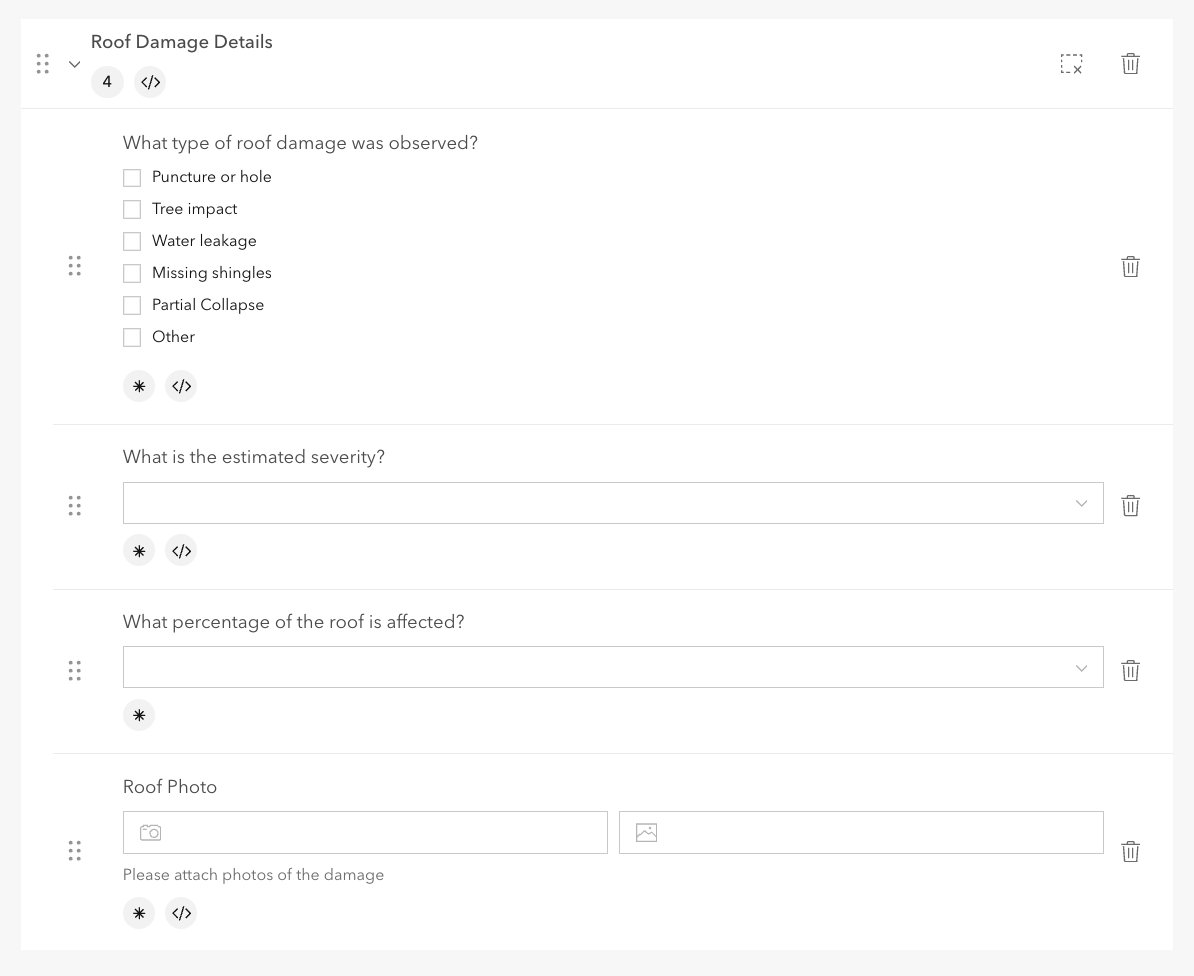

To continue with our storm damage assessment example, create a new group in your form called Roof damage details, and add a few follow-up questions inside it, like the ones below:
“What type of roof damage was observed?” (multiple choice)
  • Puncture or hole
  • Tree impact
  • Water leakage
  • Missing shingles
  • Partial collapse
  • Other
“What is the estimated severity?” (dropdown)
  • Minor
  • Moderate
  • Severe
“What percentage of the roof is affected?” (dropdown)
  • Less than 10%
  • 10 to 25%
  • 26 to 50%
  • More than 50%
Tip: Make the follow-up questions required to ensure they are answered.
Add group of follow-up questions

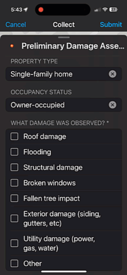

9. Test it in the mobile app.
Expected result:
In the ArcGIS Field Maps mobile app, when roof damage is selected in your multiple choice question, the group of follow-up roof damage questions appears in the form. When it isn’t selected, the group stays hidden.
