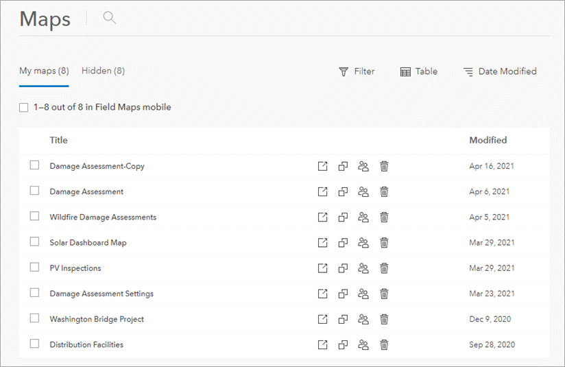

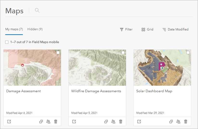

You can view maps in a grid (shown above) or in a table (shown below). Click Grid or Table to switch between the two views.

If you have maps that you don’t want to appear in the Field Maps mobile app, click the checkbox and then click Hide in Field Maps Mobile. This setting is helpful if you have maps made for dashboards or other apps that mobile workers don’t need in the field. You can view maps you’ve hidden by clicking the Hidden tab.
Duplicate a map to create a copy that includes the same layers and settings. This is helpful if you have a map that you want to repurpose for a similar workflow. The map card also allows you to configure the Sharing settings, begin to Configure the map, and Delete the map.

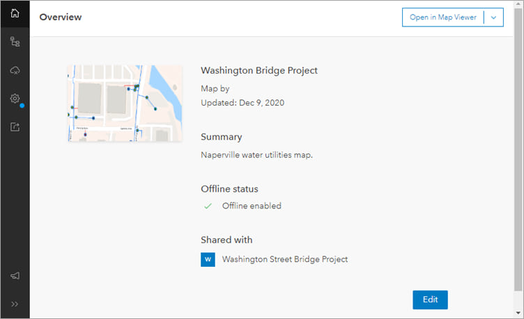

When you click Configure, the Overview page appears. From this page, you can check the offline and sharing settings for you map, and you can edit the title of the map, the summary, and the map’s thumbnail. The changes you make will also be updated in the Field Maps mobile app.

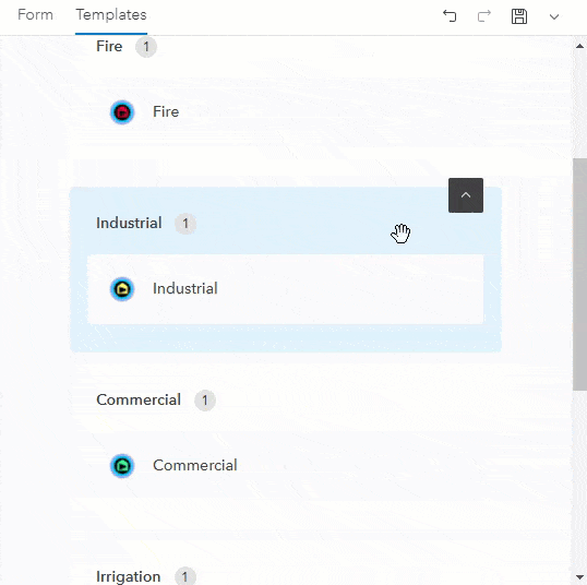

Feature templates help you categorize assets so mobile workers can easily collect specific kinds of data in the field. Feature templates you’ve created using ArcGIS Online, ArcGIS Enterprise, or ArcGIS Pro can be configured on the Content page of the Field Maps web app.
You can configure the display name and description for each feature template as well as its default values. You can also drag feature templates in the order you want them to appear in the mobile app—placing more commonly used templates at the top of the list.

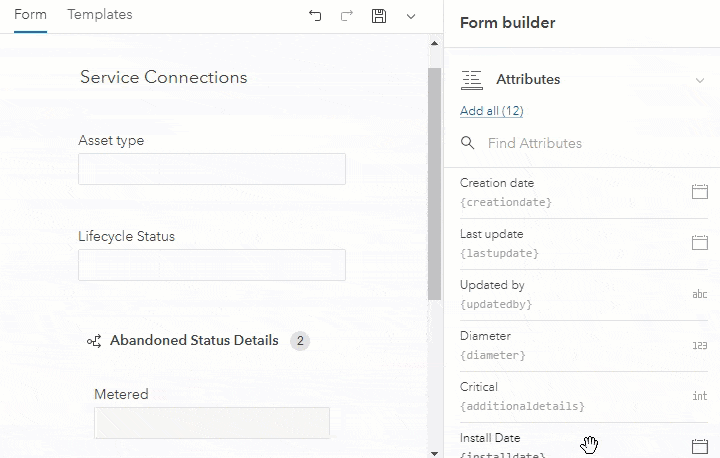

The Form builder in the Field Maps web app allows you to build smart forms that mobile workers use to capture assets and perform inspections in the field. Build a form by dragging attributes and form elements onto the form canvas. Form elements help organize your form, and attributes are used as entries that mobile workers fill out in the field.
Drag an attribute
There are a variety of ways to configure the form—group entries together, add conditional visibility statements, edit display name and input types, and more. Once you’ve saved the form in the Field Maps web app, the changes are applied to the form in the mobile app. See Configure the form to learn more.

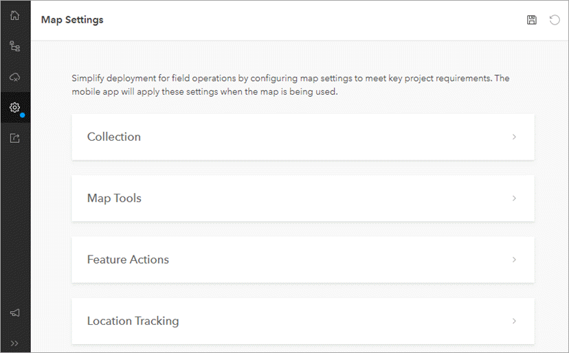

The Settings page allows you to simplify deployment for field workflows by configuring settings for the map.
Settings page
You can configure the following settings:
To learn more about configuring map settings in the Field Maps web app, see Map settings.
