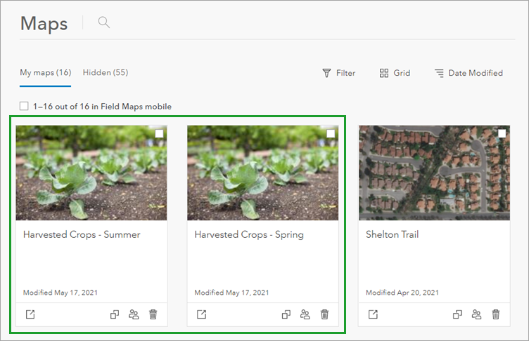

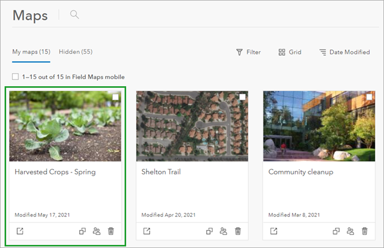

Duplicating a map is a simple way to create a new map based on an existing workflow or purpose. In the Field Maps web app (shown below), I have a map that was used for collecting information about crops in the spring.
Harvested Crops - Spring map card

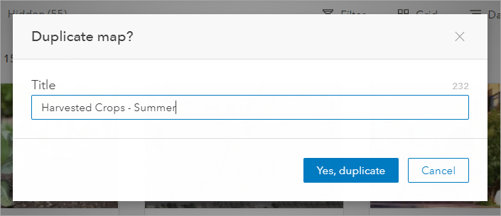

With summer approaching, I want to create a new map with the same settings and form. To do this, I can duplicate the spring map. On the map card, I’ll click the Duplicate button. In the window that appears, I’ll title the duplicated map Harvested Crops – Summer and click Yes, duplicate.
Duplicate map window
The duplicate map is created and contains the same summary, feature templates, forms, and offline settings as the original map. Map areas and sharing settings are not preserved when duplicating a map.
Harvested Crops - Summer map card
Now I can open the summer map and make any slight adjustments needed for the new season. Once I share the map, it’s ready to go. For more information, see Duplicate a map.

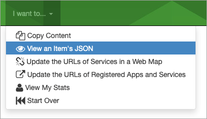

Browse to https://ago-assistant.esri.com/ and sign in to your account. Under I want to, select View an Item’s JSON.
View and Item's JSON

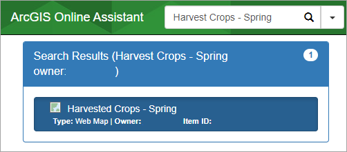

Search for the map you want to copy the form or forms from and select the map.
Search for source map

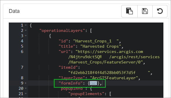

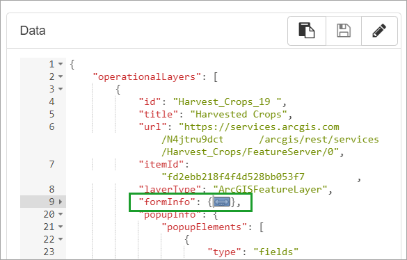

You’ll see two JSON editors, one for the item metadata (top) and one for the map definition (bottom). In the map definition, search for the layer containing the form and copy the formInfo JSON object.
Copy the formInfo JSON element
Now search for the map to which you’ll copy the form. Select that map and click Edit JSON. In the map definition, find the layer you want to apply the form to and paste the copied formInfo object.
Paste the formInfo JSON element
