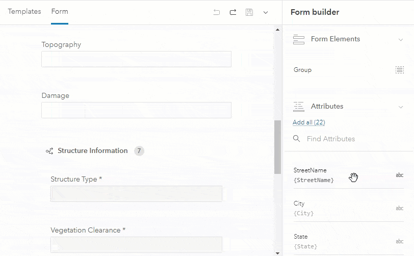

Drag and drop the attributes that need to be visible on the form canvas and order them to match the flow you expect mobile workers to enter data into the form. Where possible, try to keep the number of entries to a minimum, use default values and lists to minimize text input.
Drag an attribute
Drag and drop attributes or use the Up/Down arrows on your keyboard to order fields.

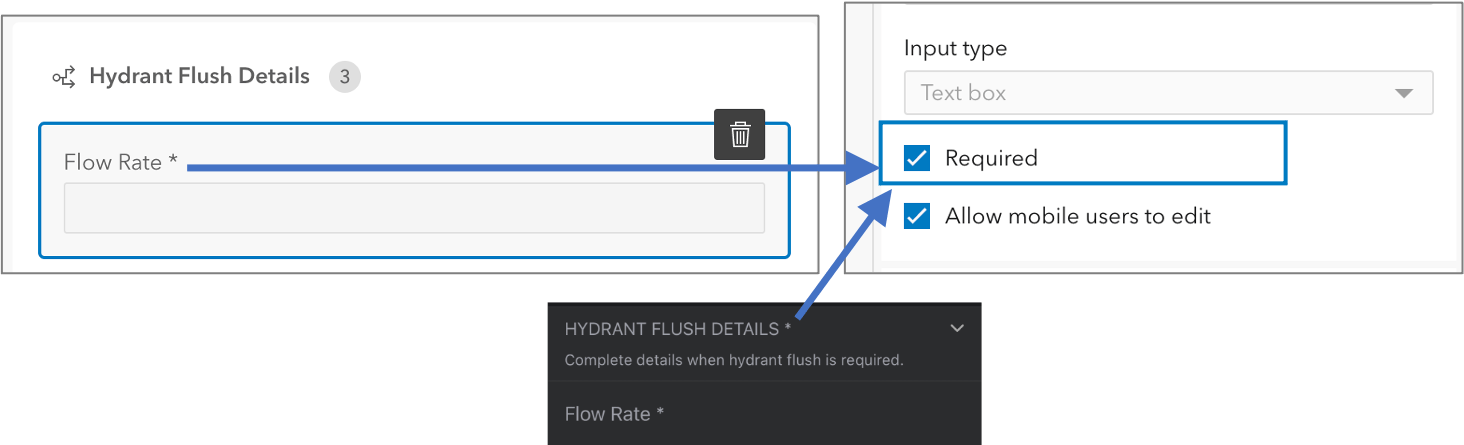

Required fields
Certain fields can be required for data entry when visible. For example, when flushing a hydrant, require that the mobile worker record the flow rate before submitting the form. Required fields will be marked with a * next to their display name. If a group includes a required field, the group name will be marked with a * as well.
Required fields are marked with a * next to the display name.

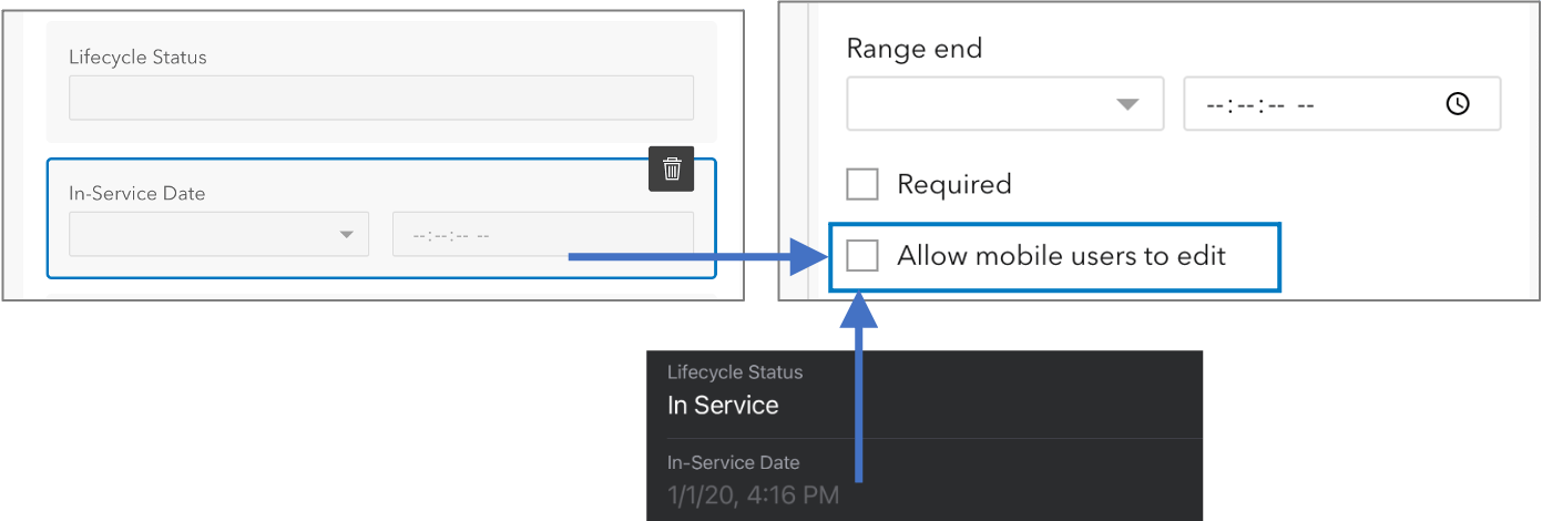

Read-only fields
Certain fields can be visible in the form but not editable for the mobile worker. For example, you may need to see the “In Service Date” for an asset but shouldn’t be allowed to edit it when updating the form. Read-only fields appear grayed out on the form, indicating that they cannot be updated.
Read-only fields are grayed out in the editable form.

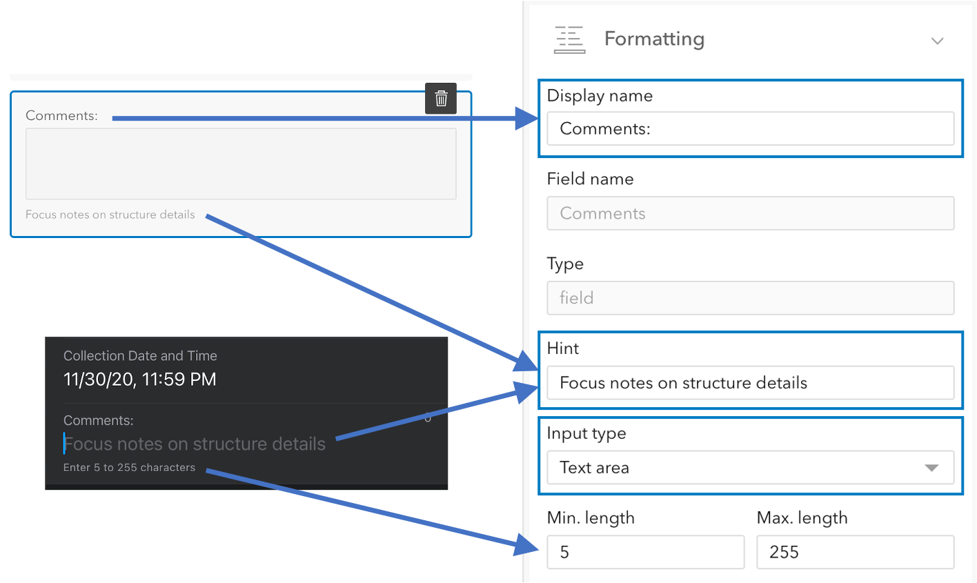

Format fields
Provide additional formatting to fields can improve clarity for the mobile worker and minimize potential of error when entering data. The display name defaults to the field alias, can be short and to the point, or can be phrased as a question when displayed on the form. Hint text can be used to provide informative text for an entry without a default value.
Text fields include a text input control that you can set (a simple text box or a text area that wraps when more than one line of text is entered). You can provide a minimum and maximum number of characters.
Date fields include a date input control that can be set to either a date picker or a date and time picker. You can further refine the date range to minimize error.
Choose a meaningful display name, add hint text, set min/max values.
Choose a meaningful display name, add hint text, set min/max values to improve entry.

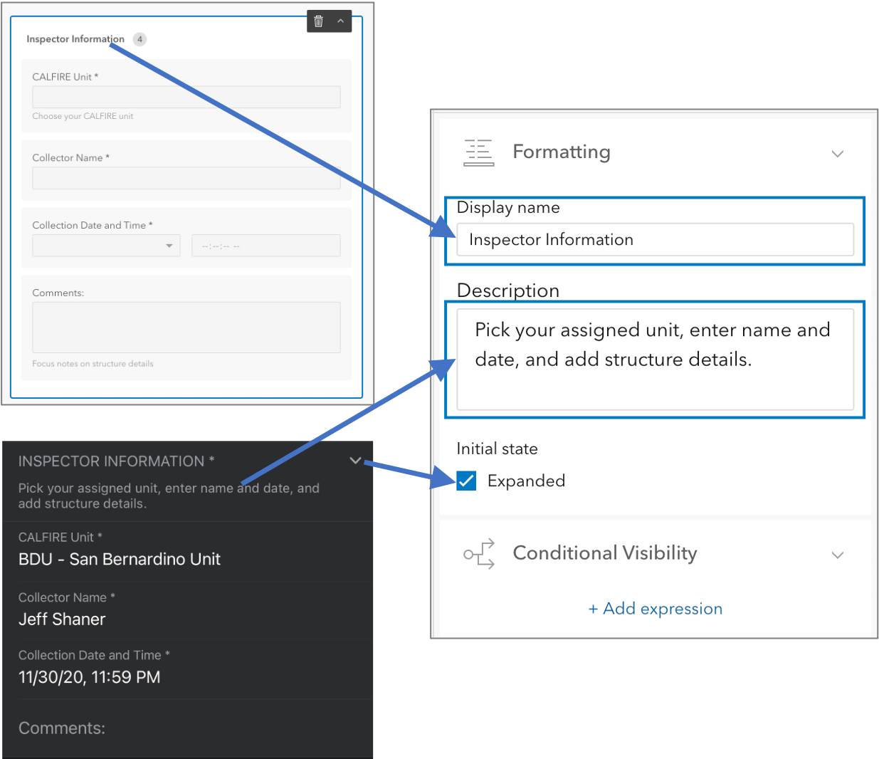

Group fields
Place fields into groups that section common entries together, that can be collapsed when they do not need to be displayed, and expanded when they do. Adding a description to your group can provide context to the set of fields that need to be filled out as well.
Groups, like fields, can be subject to conditional visibility. Consider applying an expression to a group so mobile workers only need to see and fill out fields when needed.
Groups have their own name and description and state. You can apply conditional visibility to them as well.

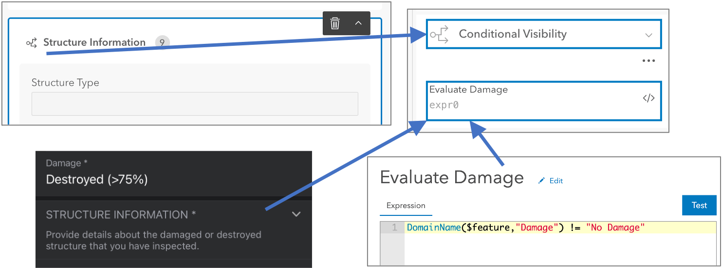

Conditional visibility
If you have attributes or groups that only need to appear if a previous entry has a certain value, you can make those attributes or groups conditional. You can use the Arcade Editor to create an expression using the Arcade Constraint profile. The expression should always be written to return a Boolean value of true or false.
Control the visibility of fields and groups using an Arcade expression.
