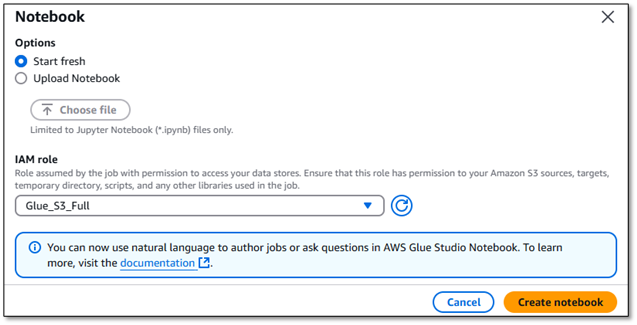

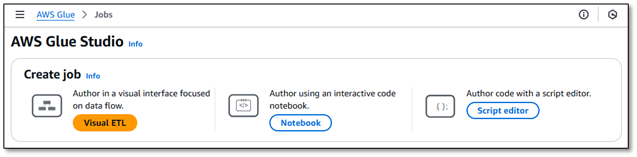

Let’s showcase how you can get up and running with GeoAnalytics Engine in AWS Glue Studio to run geoanalytics workflows  interactively or on schedule. First, follow the guideline here to download ArcGIS GeoAnalytics Engine distribution. Next, sign in to your AWS Management Console and upload those distribution files to your S3 bucket. After that navigate to AWS Glue Studio and start or upload a Notebook with an appropriate IAM role so that it has permissions for data access and ETL job.
IAM Role Configuration for Secure Access:
  • Create a specific IAM role for Glue jobs
  • Apply least privilege principle
  • Required permissions:
    • secretsmanager:GetSecretValue
    • s3:GetObject for GeoAnalytics Engine files
    • s3:PutObject for output locations

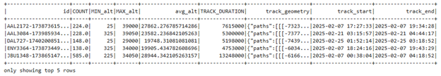

Next, using ReconstructTracks tool, connect all time-sequential points for each flight into tracks and summarize records within each track.
from geoanalytics.tools import ReconstructTracks
tracks = ReconstructTracks() \
     .setTrackFields("id") \
     .setDistanceMethod(distance_method="Planar") \
     .addSummaryField(summary_field="alt", statistic="Min") \
     .addSummaryField(summary_field="alt", statistic="Max") \
     .addSummaryField(summary_field="alt", statistic="Mean",
alias="avg_alt") \
     .run(dataframe=df1) \
     .show(5)

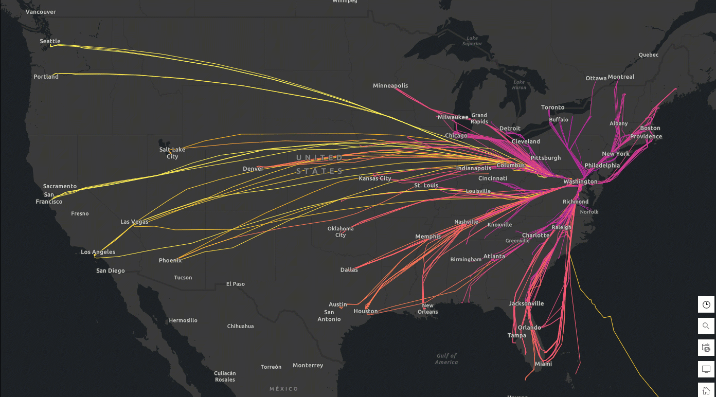

You can export the tracks DataFrame to ArcGIS Online as a hosted feature layer and create a flight track app to visually explore durations of each flight (Figure 1). These near-real-time flight tracks can be further analyzed alongside weather data for hazard detection and alerting. In the event of an aircraft incident or near-miss, investigators can reconstruct flight paths to gain insights into the circumstances surrounding the event.
tracks.write.format("feature-service")  \
   .option("gis", "myGIS") \
   .option("serviceName", "flightAware_DCA_Tracks") \
   .option("layerName", "flightAware_DCA_Tracks")  \
   .save()
Figure 1. Daily tracks and duration of flights (Feb 6-9, 2025) to Ronald Reagan Washington National Airport (Code: DCA). Data source: FlightAware
