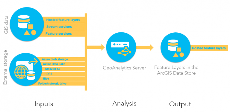

Lists types of input (feature layers, cloud storage) and outputs of GeoAnalytics in a flow chart/diagram for 10.6.1.
Above is an illustration of how data flows through GeoAnalytics Server, with inputs and outputs. Data can be used from external stores to run analysis against your GeoAnalytics server(s). The output is a feature layer in ArcGIS Enterprise that can be used in other areas of ArcGIS Enterprise like web maps and applications.

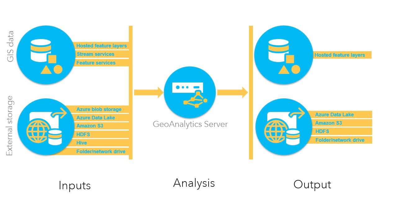

New at 10.7:
At 10.7, we’ve added the ability to write back to your big data file shares.
Inputs and outputs of GeoAnalytics Server at 10.7
The above illustration outlines how your data flows through GeoAnalytics Server at 10.7, with inputs (the same as 10.6.1) and outputs (new options for 10.7). Your analysis output can be a feature layer in ArcGIS Enterprise or – and this is the new part – a big data file share. You can mix and match sources and outputs as you need. This means you can read from one big data file share, write a hosted layer, and then use that as input and write to another big data file share. It’s all up to you where you want your data to go.
