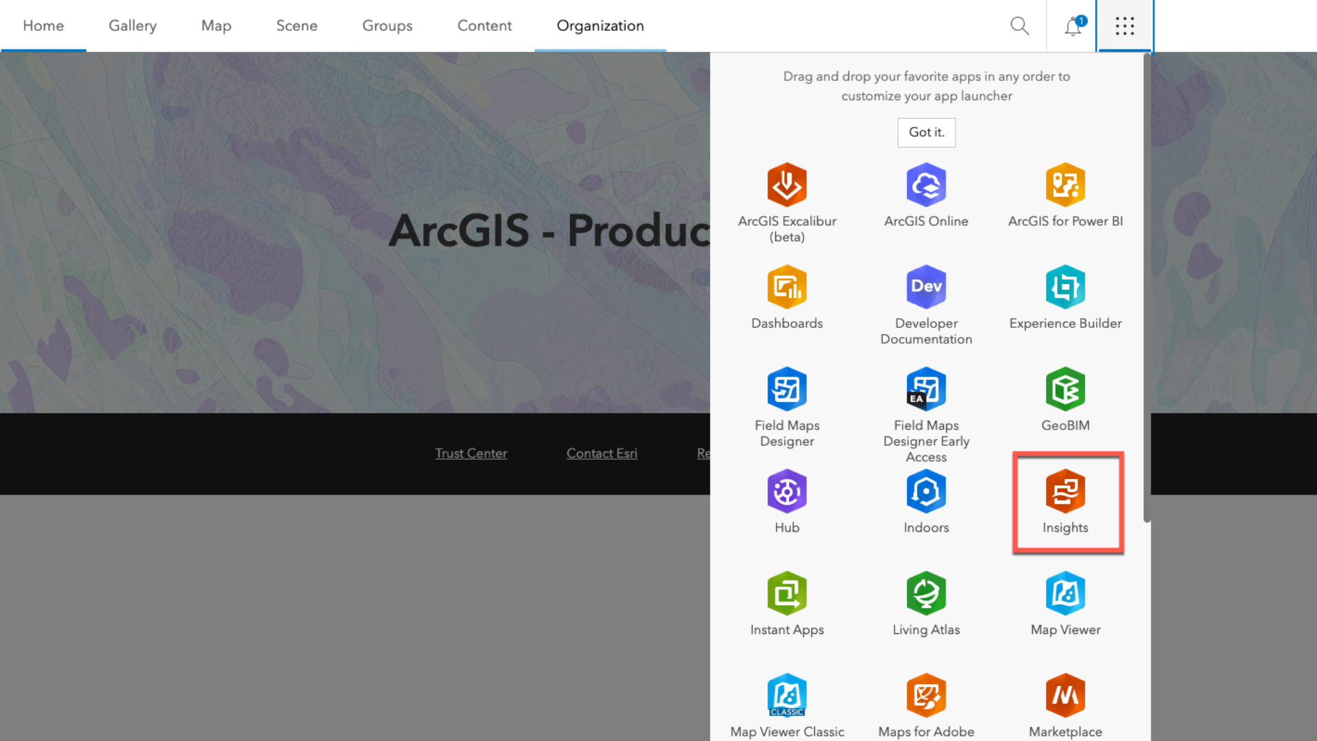

ArcGIS Online app launcher with ArcGIS Insights highlighted
The Insights App will cease to exist in the app launcher in June 2026.

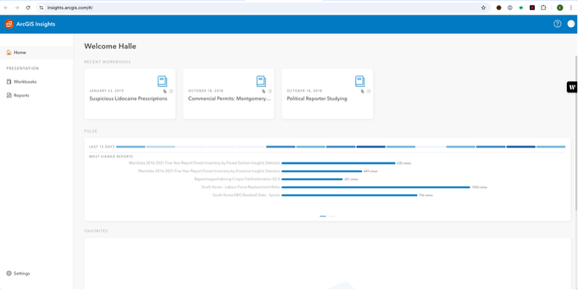

Screenshot of the ArcGIS Insights home screen
You will no longer have access to the ArcGIS Insights app in June 2026.

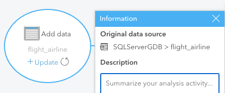

You can find the data source if you switch to the model view from the top right.
Screenshot of the model view icon
You should then select the dataset name, which opens the tools in blue. Then you can use the information icon to open the data source.
Screenshot highlighting the information icon
Select the dataset name and hover over the information icon.
Details in the Information Icon showing the description of the dataset
Details shown in the Information icon.
