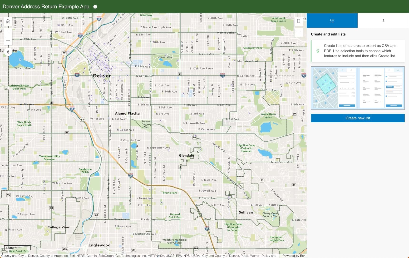

To generate lists of features to export, an input layer must be defined. The pop-ups of the features in the input layer are used in the exported CSV or PDF file. Once the layer is defined, a user can select features to include in a list.
There are two methods for selecting features to add to lists in Public Notification: search and sketch.

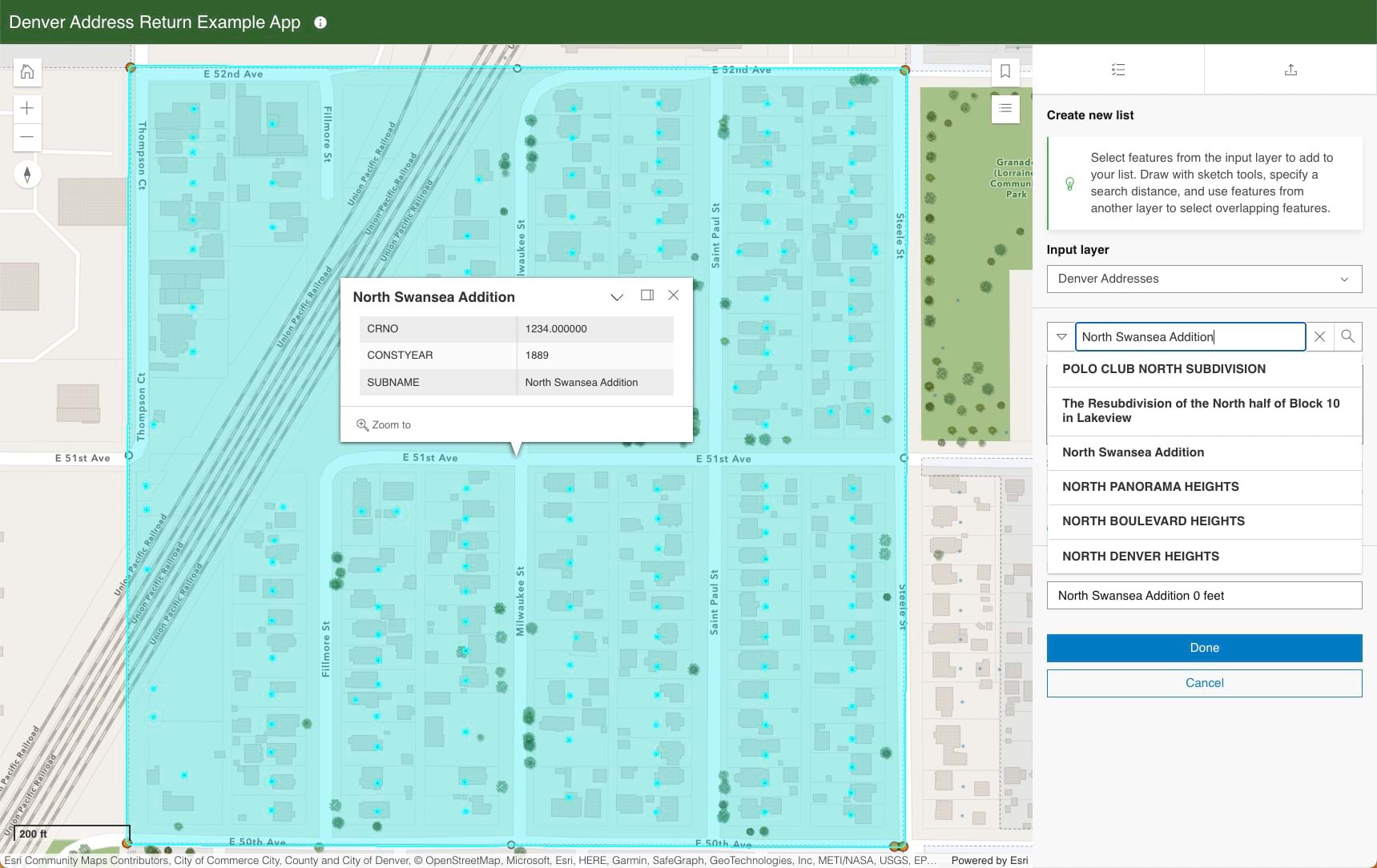

  • Search uses the search widget in the panel where users can enter addresses or points of interest. Once a location is returned, they can create a search radius using miles, kilometers, meters, and feet to add features within the buffer. Set up feature search in the app configuration to use attributes from a layer in the map to search for specific features.
Screenshot of using search in sample Public Notification app

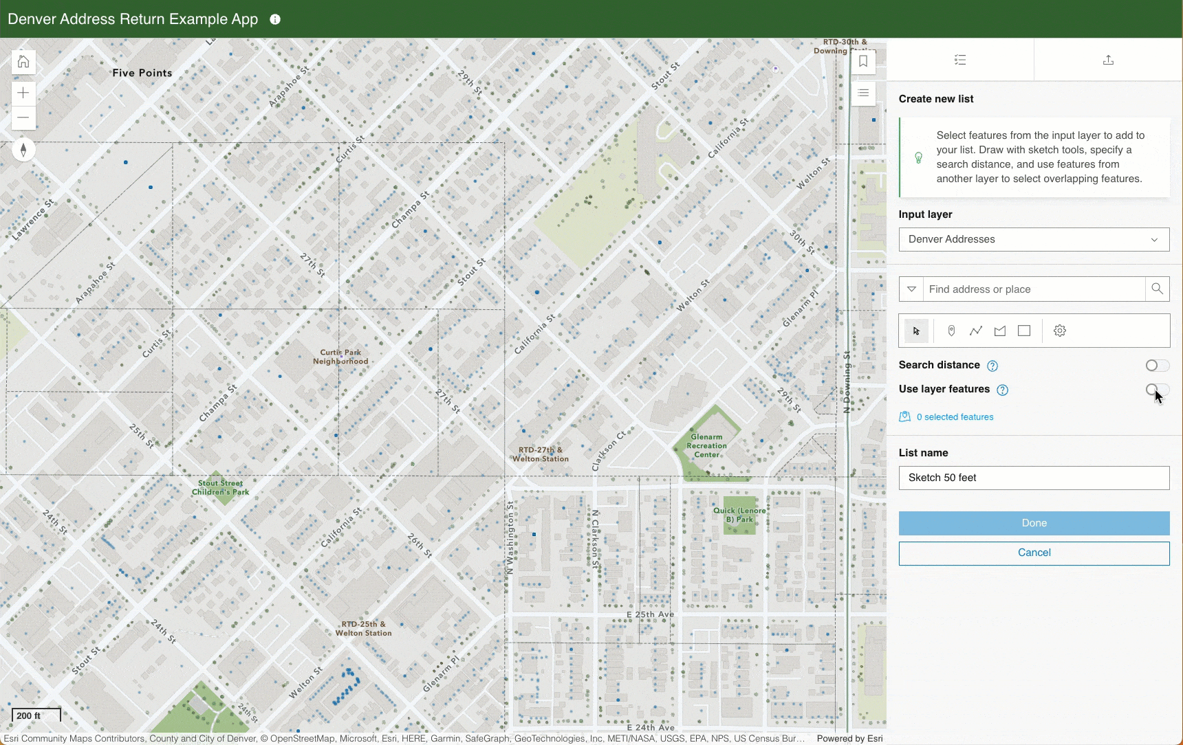

  • Sketch uses a basic set of drawing tools for drawing a point, line, rectangle, or polygon. The drawn graphics are used to select features from the input layer that intersect.
Screenshot of using sketch in a sample Public Notification app
http://Animated%20gif%20of%20a%20feature%20in%20the%20map%20being%20selected%20using%20sketch%20tools

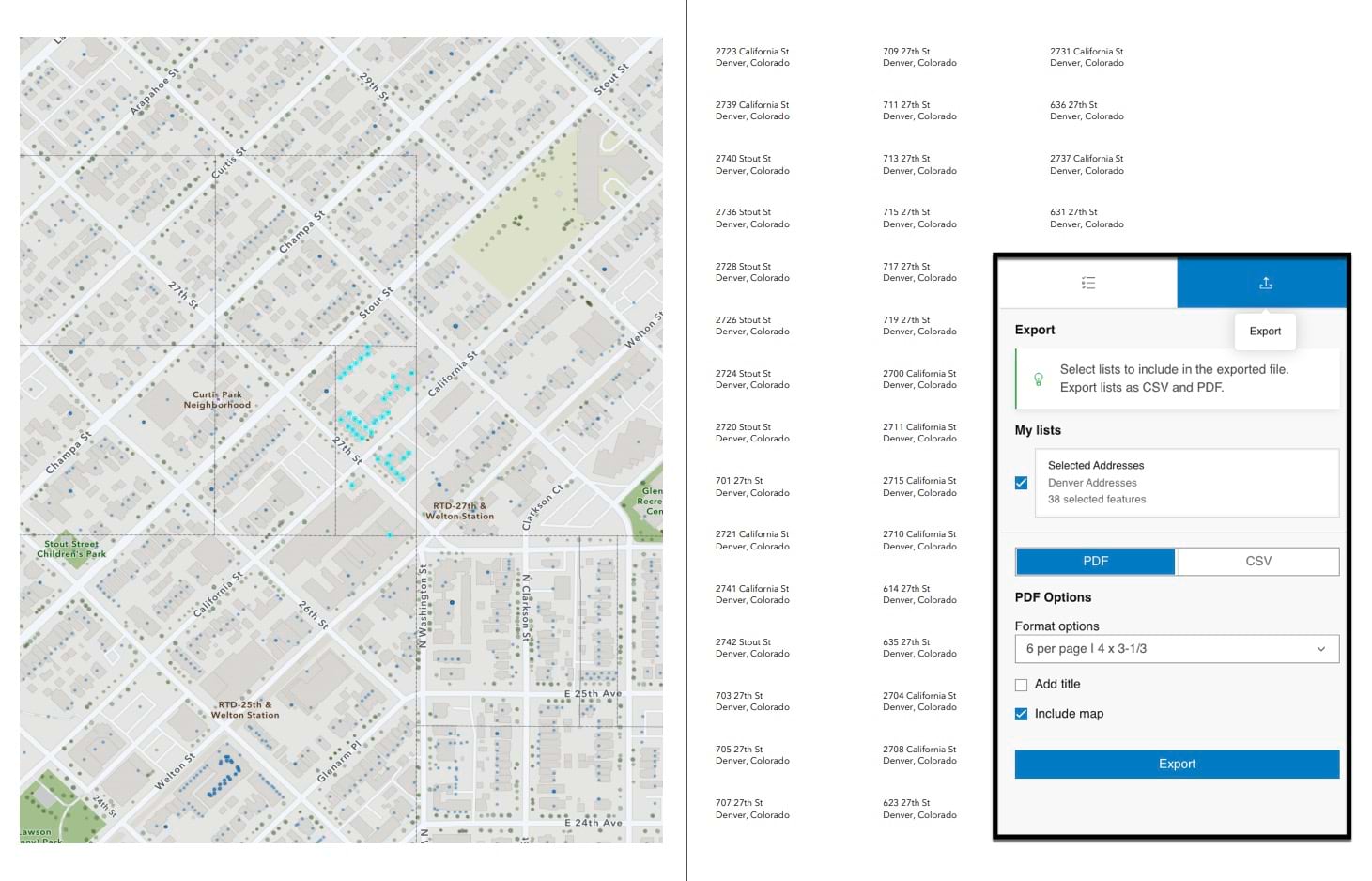

To export the lists of features that are created in the app, use the Export button at the top of the app panel. In the export panel lists can be exported to a PDF or CSV file. If there are multiple lists, users can choose which lists to include in the export and remove duplicates if the same feature exists in the lists. A title and image of the map can be included in the PDF export.
Screenshot of export PDF from sample Public Notification app

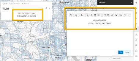

If the goal is to export mailing labels, users can choose a label layout prior to exporting lists to PDF. You must confirm that the pop-up configuration for the input layer is set up like a mailing label would be (full address, city, state, postal code, and so on). Pop-ups for the layer can be authored in Map Viewer.
Screenshots of pop-up configuration in Map Viewer
