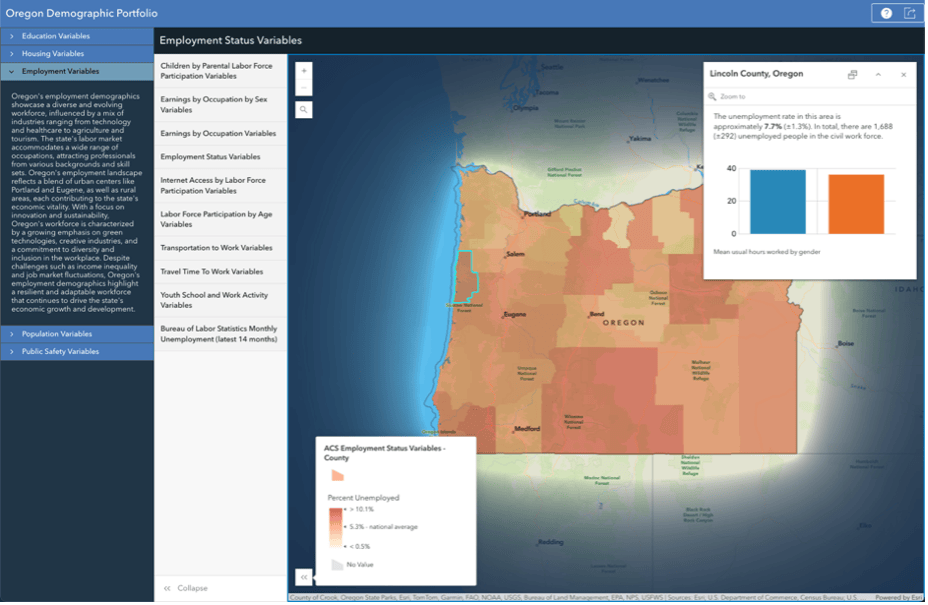

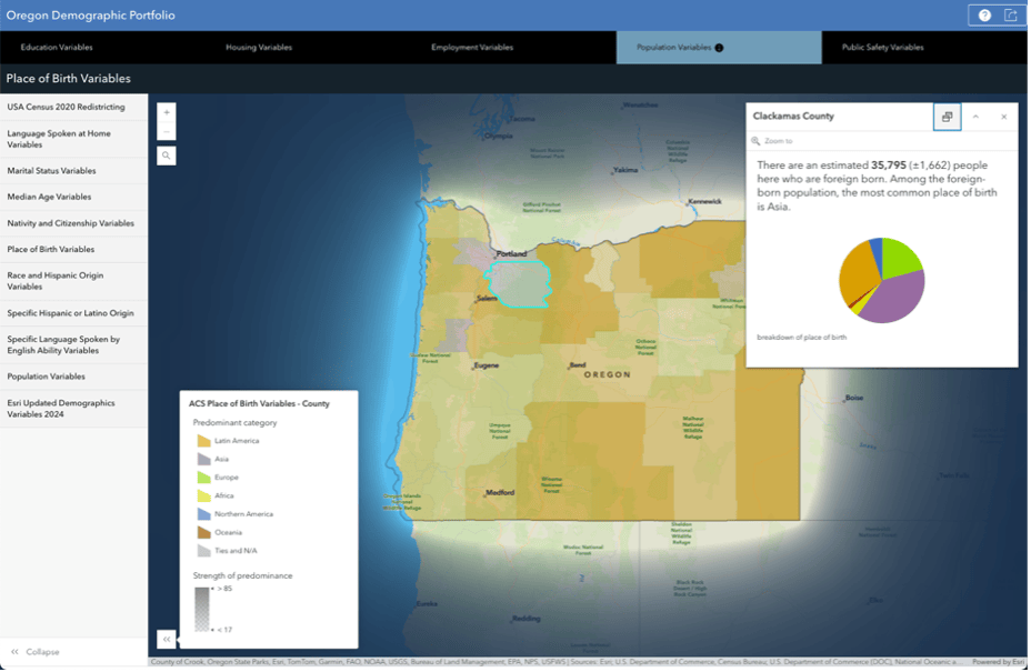

Portfolio app example with tabbed layout
Access example - https://webapps.maps.arcgis.com/apps/instant/portfolio/index.html?appid=af411e9b04004999a702ce6c56c40ec0
Portfolio example with accordion layout
Access example - https://webapps.maps.arcgis.com/apps/instant/portfolio/index.html?appid=0e0ae2694d3d40429c0aaece48d13bcc

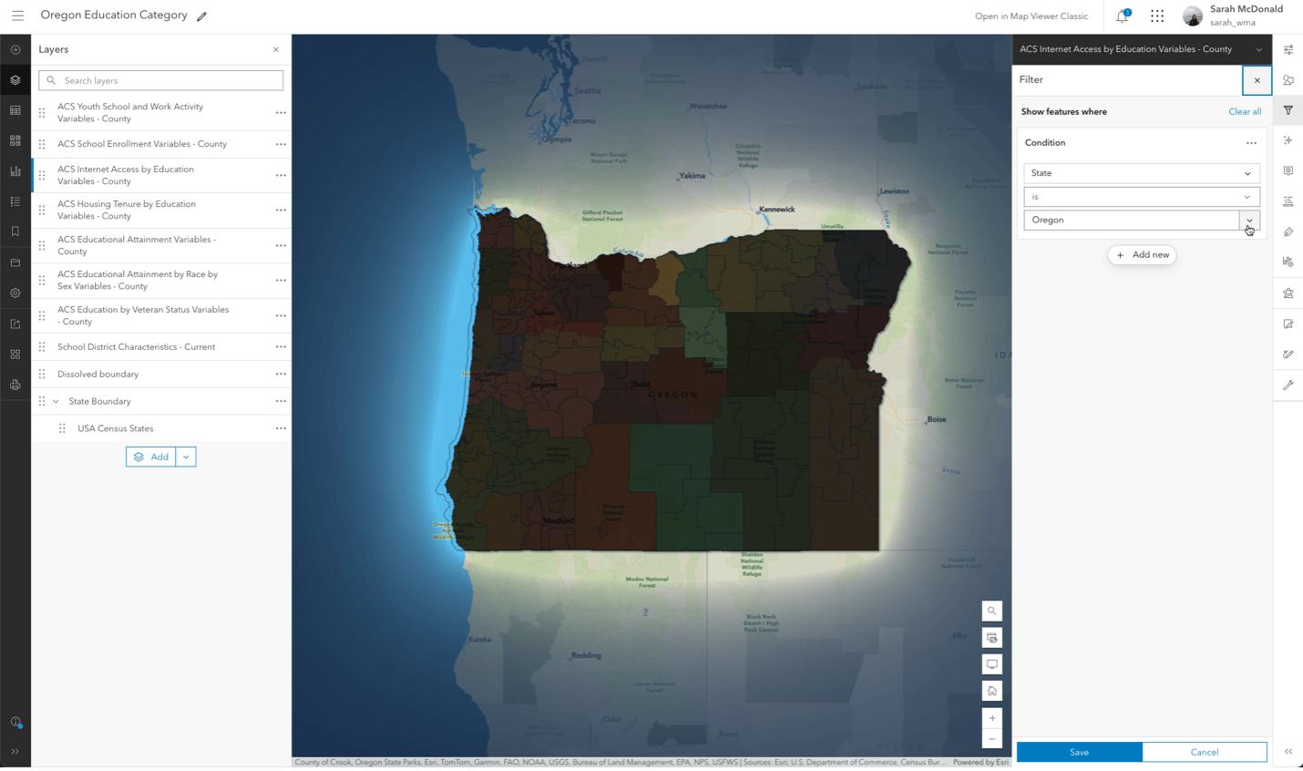

For this example, you have five web maps for each demographic category you want to provide information about: Education, Employment, Population, Housing, and Public Safety. In Map Viewer, you set up each web map with the data for each category, style my layers, configure pop-ups, and set up any filters you might need.
Screenshot of Education map in Map Viewer with filter configuration open

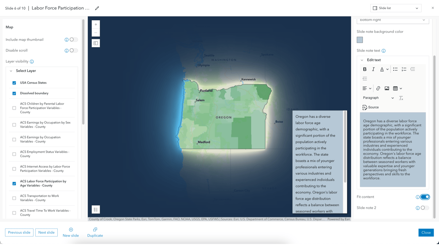

Start by creating an Exhibit app for each one of the demographic categories. In each of the Exhibit apps, set up slides for each layer in the map. To do this, click the Add new slide button to open the slide configuration window. In the slide configuration:
  • Adjust the layer visibility in the slide configuration to focus on a single demographic layer and boundary layers.
  • Add a slide title and slide note to provide additional context for the visible data.
In the Exhibit app configuration, choose the Side Panel layout to display the slides so users accessing the app can see all the slides in the app when it loads. Finally, add any additional tools that might be helpful for users accessing the app like Export, Measurement tools, or Search.
Screenshot of slide configuration in Exhibit.
