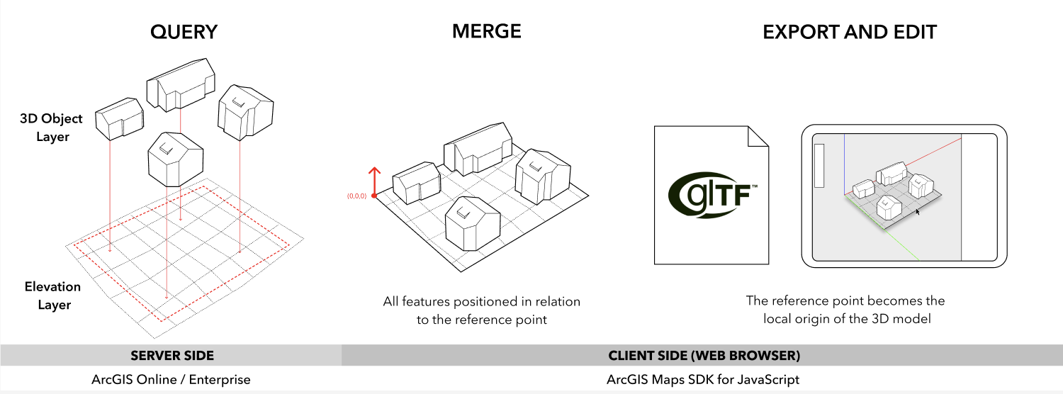

In our City Download Portal we leverage these new possibilities in the following way:
  • Query 3D Building Features: Utilize the SceneLayer.queryFeatures method to select and retrieve Mesh geometries for specific buildings.
  • Create Terrain Geometry: Generate a detailed Mesh geometry for the terrain from elevation data using meshUtils.createFromElevation.
  • Merge Features into a Single Mesh: Create a single 3D model using meshUtils.merge.

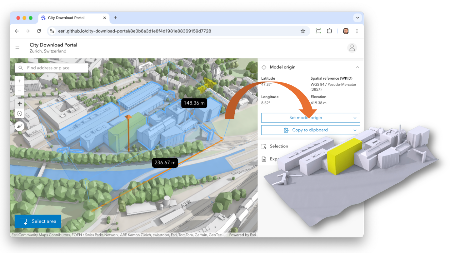

  • Convert to Cartesian Coordinates: Establish a real-world reference point as the local model origin using meshUtils.convertVertexSpace.
  • Export and Download: Convert the Mesh geometry to binary glTF (GLB) with Mesh.toBinaryGLTF for download.
In this workflow, the Mesh geometry class represents GLB models in the JavaScript Maps SDK and provides conversion methods between the two. Queries are based on extents defined by the user and performed directly on the SceneLayer. While textures are ignored in this example, individual features or parts of the exported model can be colored to enhance visualization.

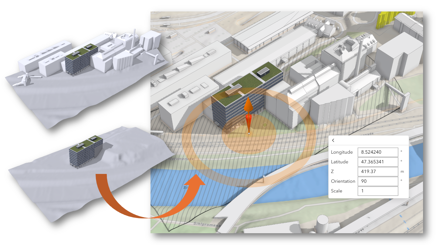

Interoperability and Georeferencing
Because we are moving 3D data between a GIS and 3D modeling software, maintaining consistency in coordinate systems and origins across tools is crucial. By keeping a fixed reference point and orientation, newly modeled 3D data will align perfectly when re-imported back into ArcGIS. While this is outside the scope of our new City Download Portal showcase, it can be achieved with a 3D object layer in Scene Viewer or any other JavaScript Maps SDK powered editing app for that matter.
While some 3D formats store georeferencing metadata directly, others – like glTF – require manual referencing. The JavaScript Maps SDK provides tooltips with exact coordinate data, ensuring accuracy during manual input. Excitingly, support for file-based georeferencing is on the horizon in upcoming JavaScript Maps SDK releases, further simplifying the integration process across different platforms.
