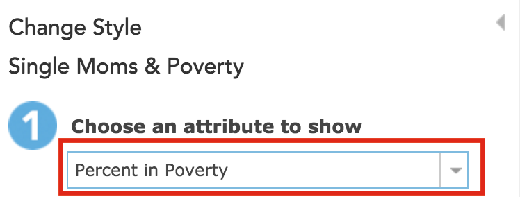

Choose first attribute

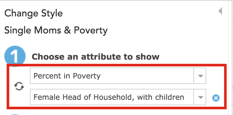

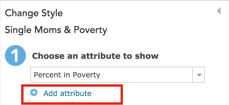

Add second attribute
Explore options for maps based on two attributes
As soon as you choose that second attribute, suitable map styles are suggested:

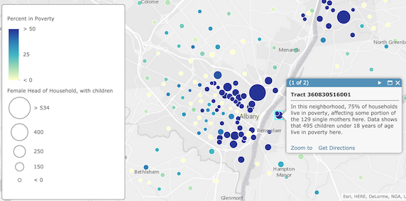

The Color & Size style is a good style to use when you want to show count information and rate information on the map together. The map below shows where large numbers of single-parent households exist within high-poverty neighborhoods. In this example, the point symbols vary in size based on the number of single-parent households, and vary in color based on the poverty rate.
Where are single moms in high poverty neighborhoods?

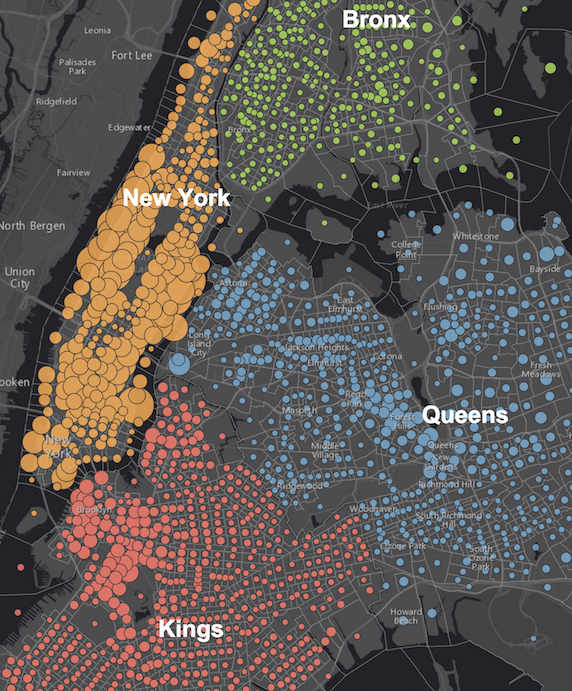

The Unique Symbols & Size style is a good style to use when you want to show count information on the map, in relation to a text or numeric field with unique values (e.g. NAME or TYPE or DISTRICT). The map below shows where large numbers of people with a bachelor’s degree reside in the New York boroughs. In this example, the number of people with a bachelor’s degree is indicated by the size of the symbol, while color is used to show which county they reside within.
People with Bachelors' Degrees in the Boroughs of New York
People with Bachelors’ Degrees in the Boroughs of New York

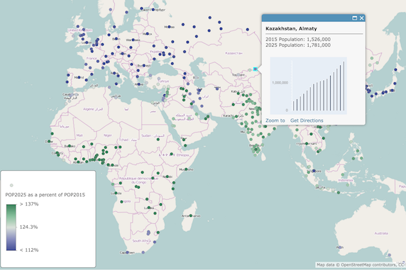

The Compare A to B style is a powerful style to use when you want to understand one number in relation to another: as a ratio, or as a percentage. The map below shows which cities around the globe are expected to grow in population, or shrink, in the coming decades. In this example, the 2025 population is divided by the 2015 population, and shown as a percentage.
Cities Projected to Grow, or Shrink, by 2025
