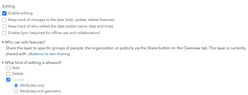

Configure a layer’s capabilities
To have an attribute update workflow in a dashboard, the layer must first have editing (update capability) enabled. If we want to only provide editing capabilities to a subset of users and/or data, we first must make a view layer.
Image of layer editing capabilities

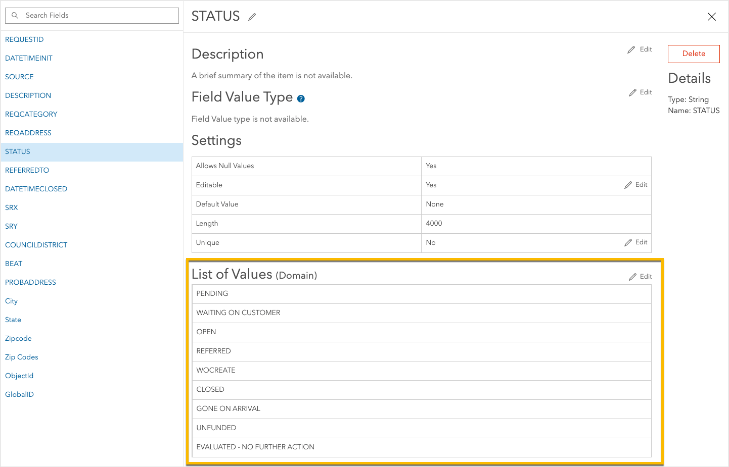

When using forms to update values, we will want to define a schema for our layer that ensures data integrity. For fields representing categories or status, it is often ideal to a have a defined list of categories or range of values to choose from. With it the form will ensure only pre-defined values or ranges are entered by the user.
List of Field Values

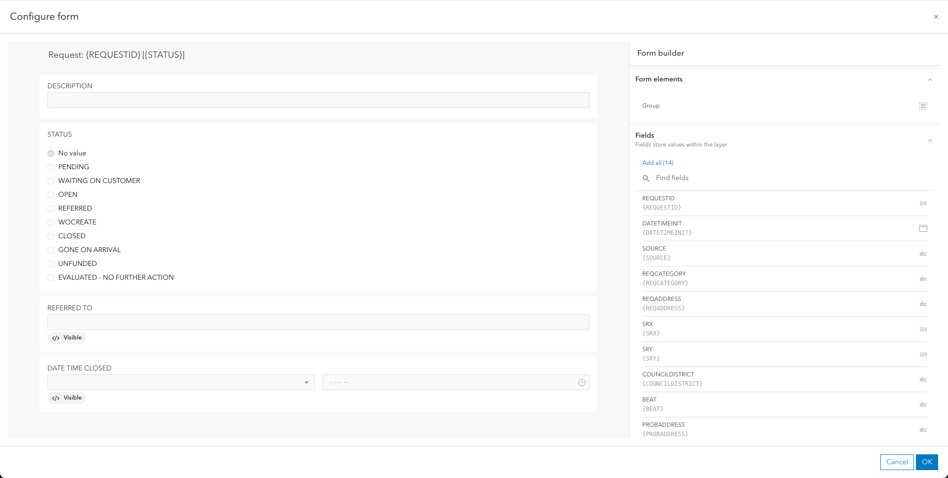

Updating attributes in a dashboard leverages forms. We can configure a form using Map Viewer or Field Maps Designer. If a form is not configured, one will be generated by the dashboard with an input for each field in our layer.
Forms configuration
There are many options to define the form experience. The following are some key capabilities:
  • Choose which fields are included in the form
  • Mark fields as required
  • Control visibility of fields based on other field values
  • Calculate default values
  • Display a field value but block editing its value

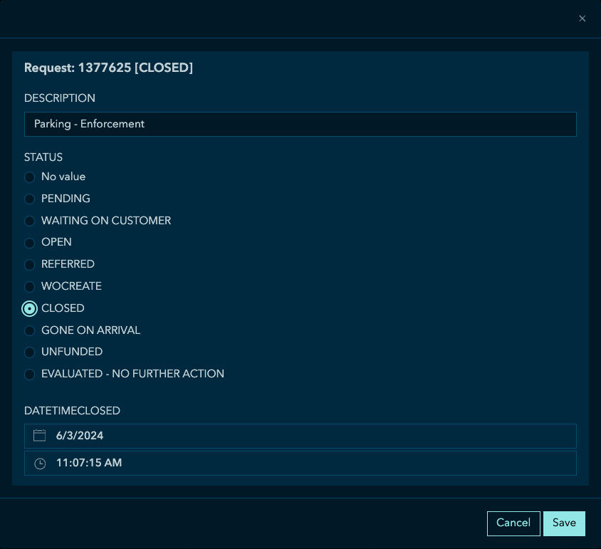

As an example, we could make a form for updating the status of a feature. The form can be configured such that if we choose “Closed”, a subsequent Date Closed field input appears with its default value as the current time.

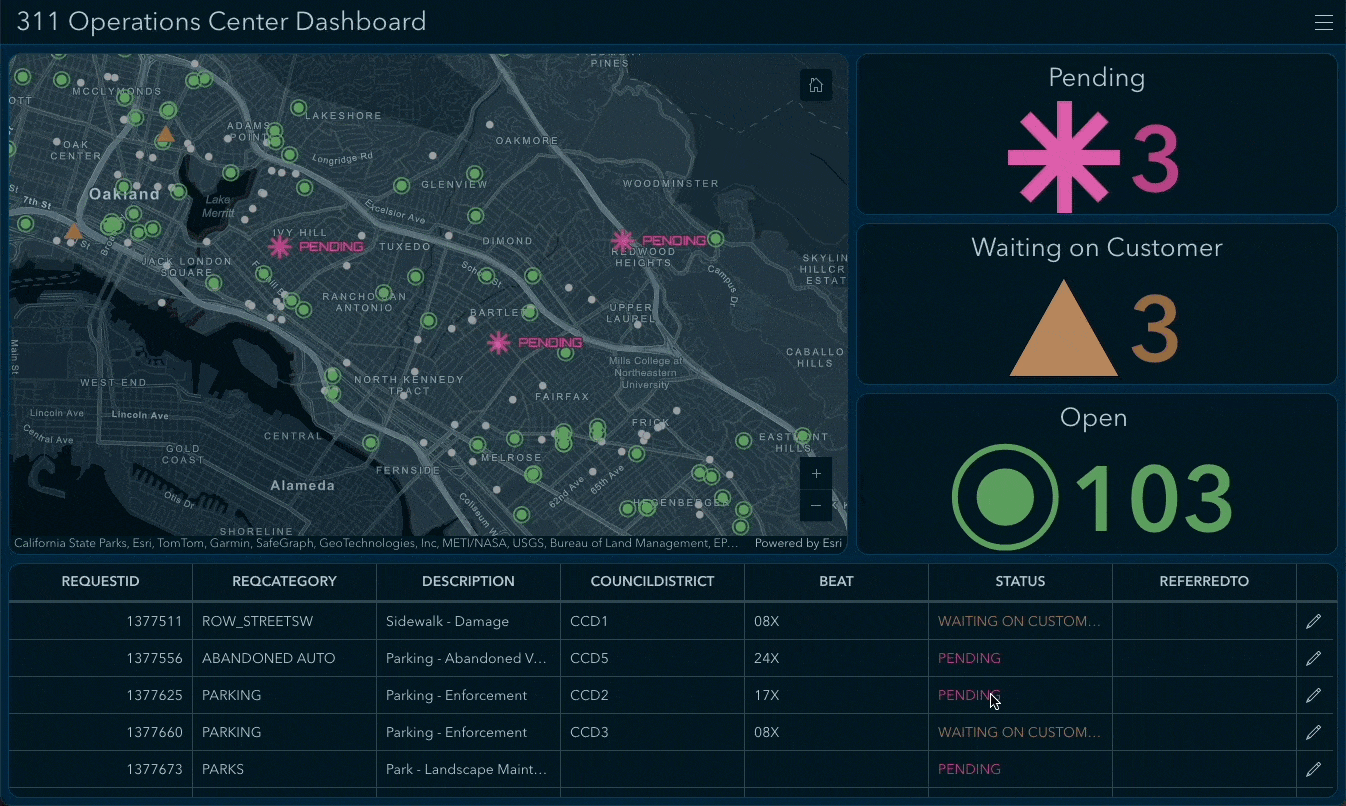

We can enable the editing workflow via a Table displaying features and/or a Map element. In a table, in the General tab, turn on the Allow attribute updating toggle button.
Table - Configure attribute updates

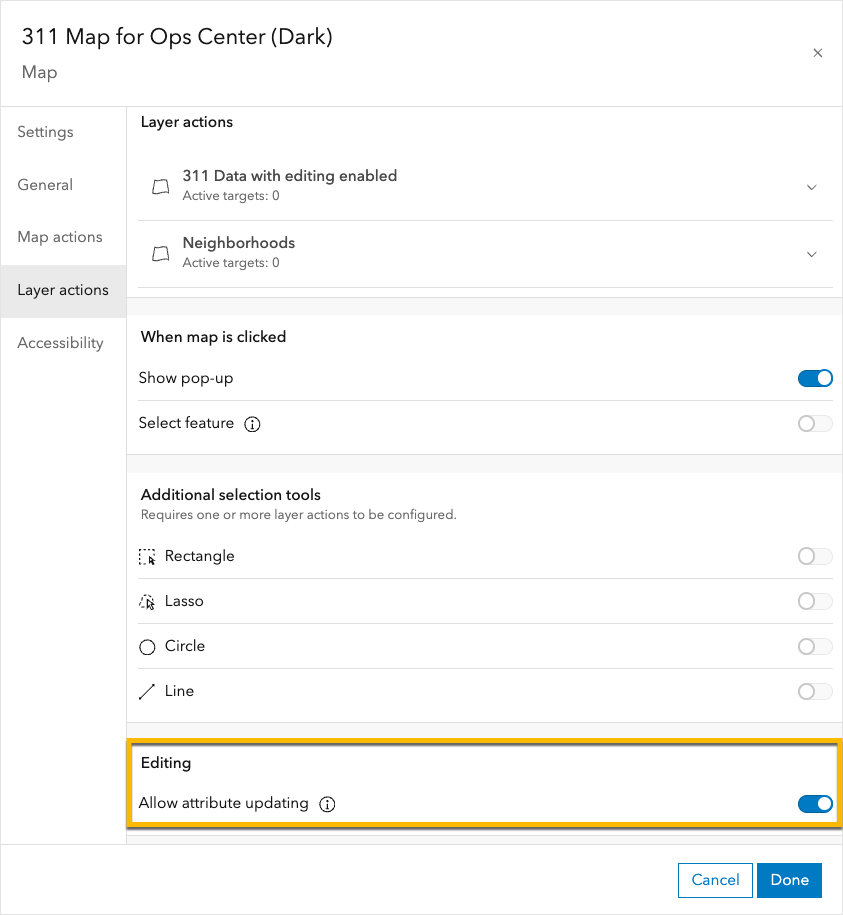

In a Map Element, in the Layer Actions tab, turn on the Allow attribute updating toggle button.
Map - Configure attribute updates

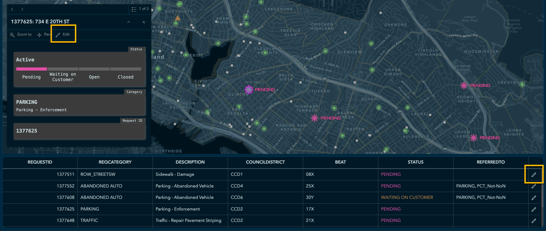

Edit buttons will appear on the table and map pop-ups, respectively.
Clicking the edit button will bring up a form.
Form in dashboard
Upon the edit being saved, the visualizations will update with the current data, even without a refresh interval.
