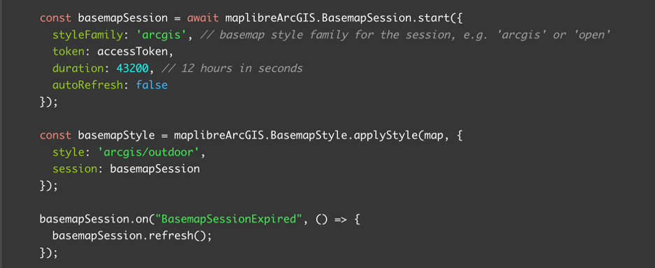

If you’re using MapLibre GL JS, the new MapLibre ArcGIS plugin streamlines the workflow for creating and managing sessions. You can create a session with the BasemapSession class and use the session token to display a basemap style. The class also refreshes with a new session once it expires.
The plugin also automatically updates the tiles with the new token behind the scenes. This means you don’t have to write custom logic to reload or reapply tiles manually.
Here’s what the code looks like:
Check out the full tutorial in the MapLibre GL JS and ArcGIS developer guide.

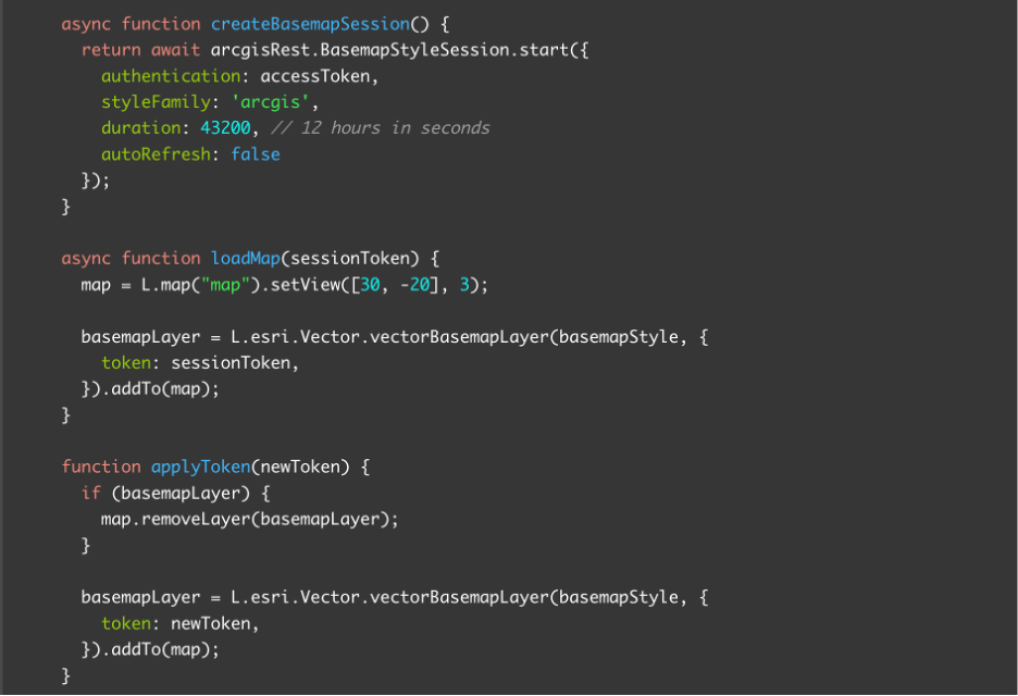

If you are using Leaflet, you can combine the Esri Leaflet plugin with ArcGIS REST JS to create and manage the session. To start a new session, use the BasemapStyleSession class in ArcGIS REST JS. Then, use Esri Leaflet to display a basemap style using the session token.
When the session expires, you remove the old layer and add a new one with the refreshed token.
Check out the full tutorial in the Esri Leaflet and ArcGIS developer guide.

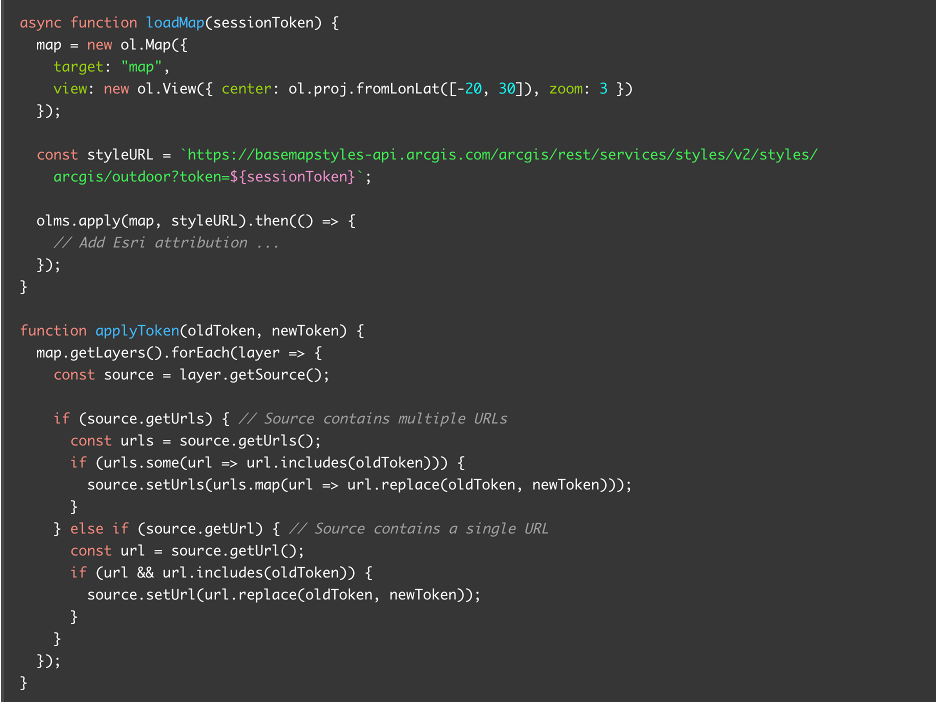

If you are using OpenLayers, you can use it alongside ArcGIS REST JS library to create and manage the session. To do so, start a new session with the BasemapStyleSession class. Next, display a basemap style with the session token using a library such as ol-mapbox-style.
When the session expires, create a new session and update your map by looping through the layers and replacing the expired token with the new one.
Check out the full tutorial in the OpenLayers and ArcGIS developer guide.

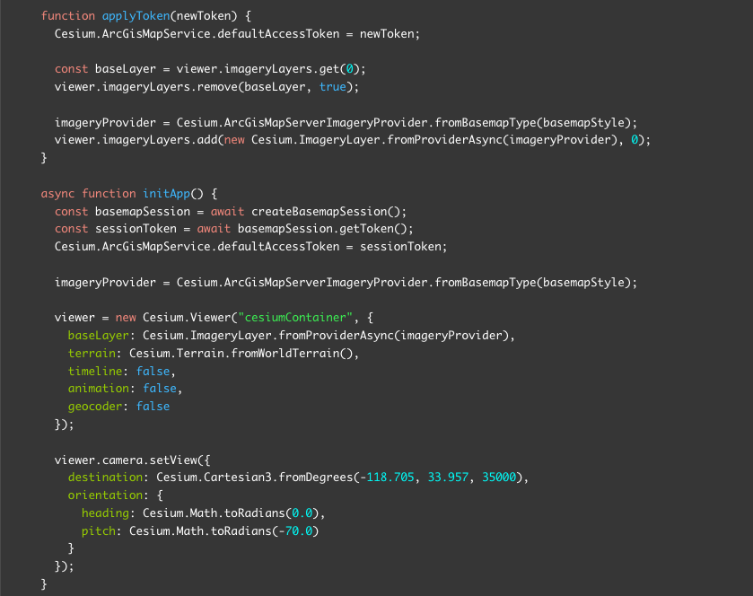

If you’re using CesiumJS, you can integrate ArcGIS REST JS to create and manage basemap sessions for your 3D scene. Start a new session with the BasemapStyleSession class, then apply the session token to ArcGisMapService.defaultAccessToken and load an ArcGIS satellite imagery provider using ArcGisMapServerImageryProvider.
When the session expires, refresh it to obtain a new token and update the default access token property so the base layer continues to load seamlessly.
Check out the full tutorial in the CesiumJS and ArcGIS developer guide.
