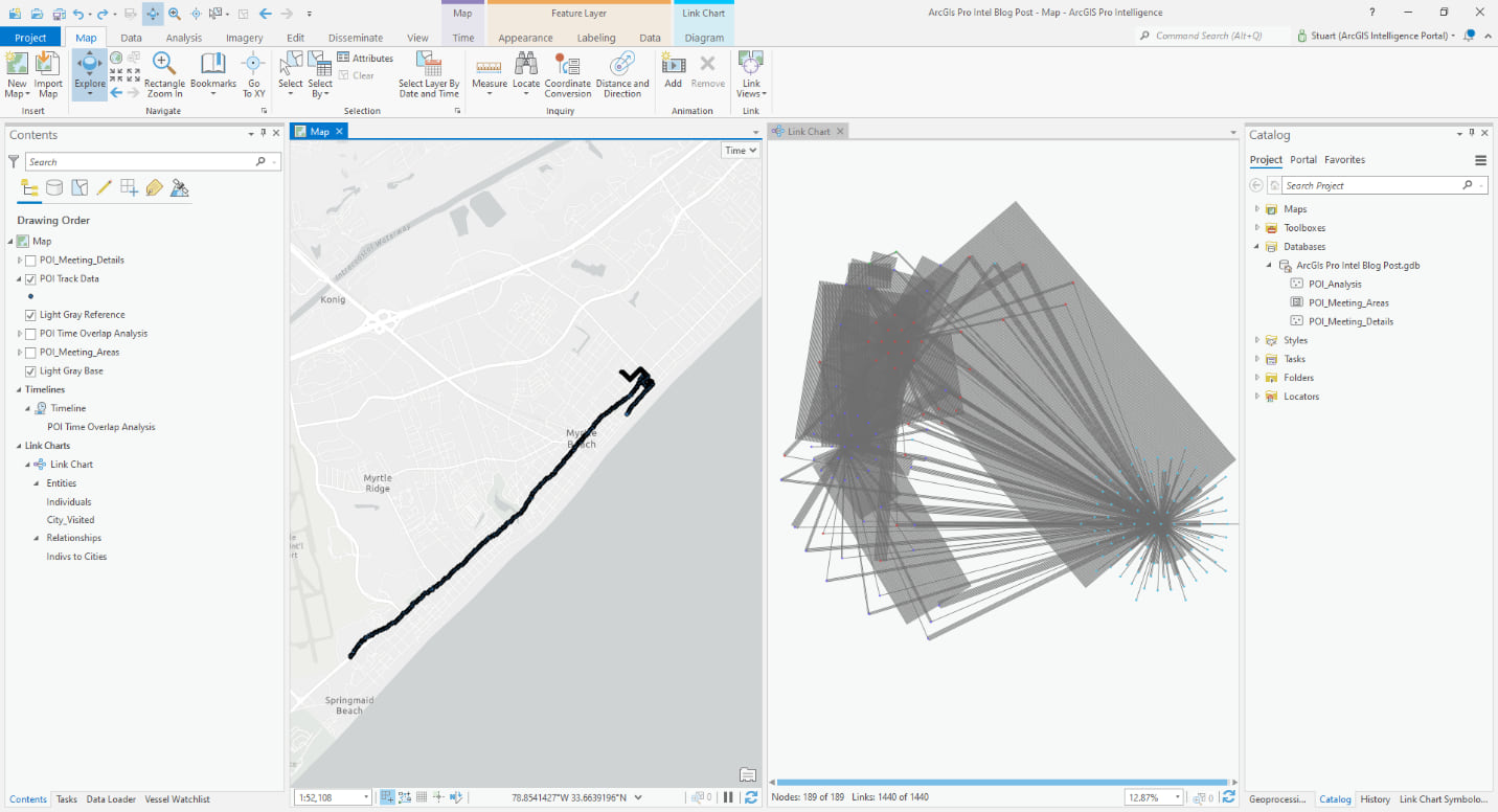

Analyzing tracks in a place of interest using ArcGIS Pro Intelligence.

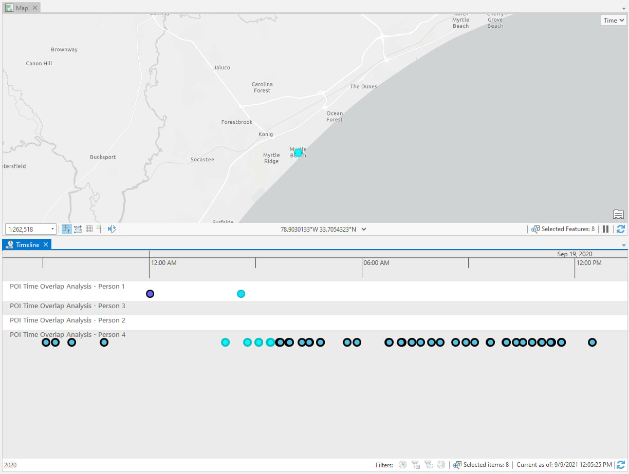

The first step in combatting human trafficking is understanding where possible victims and their traffickers are, not only in space, but also in time. The timeline tool is able to parse out individuals into separate timelines so they can be compared across space and time. Using a quick selection inside of the timeline we can highlight the overlap of two individuals of interest. The timeline selects the record in the timeline but also selects the record in space on the map view.
Highlight individuals and places of interest using the Timeline tool and Map in ArcGIS Pro Intelligence.
Now that we have highlighted an area these two individuals both traveled to on September 19, 2020, we can begin to use anonymized track data to highlight possible meeting locations using the Find Meeting Locations tool.

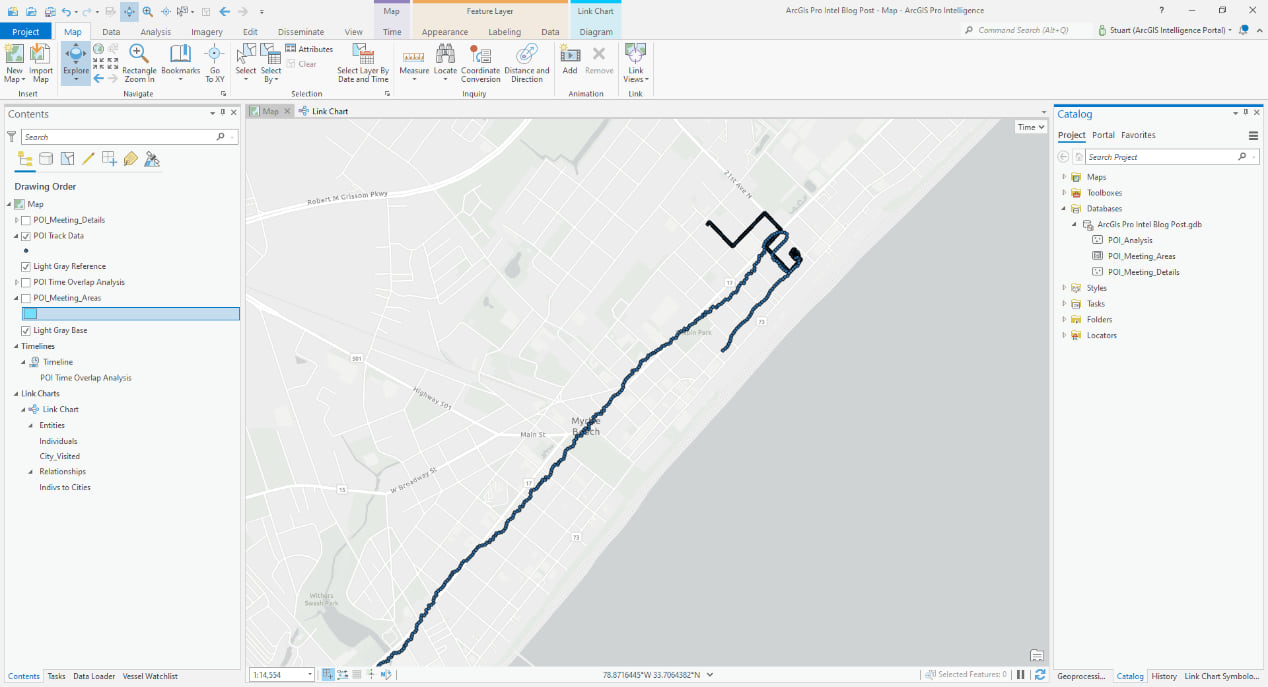

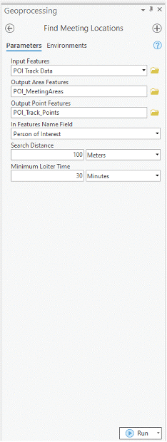

Adding the track data shows a few different tracks for a few different individuals of potential interest. Using the Find Meeting Locations geoprocessing tool, we can pass specific parameters to identify if any of these individuals have met for at least 30 minutes within 100 meters of each other. This will return a polygon feature class and point feature class highlighting any area these individuals have met in for the specified amount of time and within the specified distance.
Set parameters to locate individuals using the Find Meeting Locations geoprocessing tool in ArcGIS Pro Intelligence.

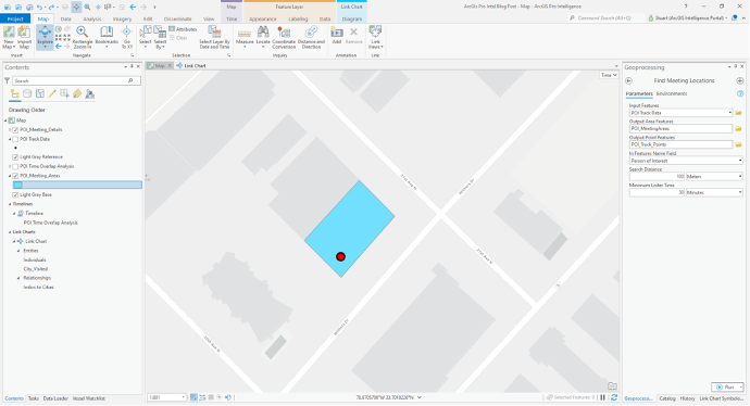

After running the tool, the results clearly show two individuals met in this motel for at least 30 minutes and were within 100 meters of each other. There is still required work by law enforcement to launch operations to investigate the possibility of human trafficking, but we have narrowed their focus to this specific area so they can concentrate their resources effectively.
With the Find Meeting Locations geoprocessing tool in ArcGIS Pro Intelligence we are able to narrow down a place of interest for investigation.
