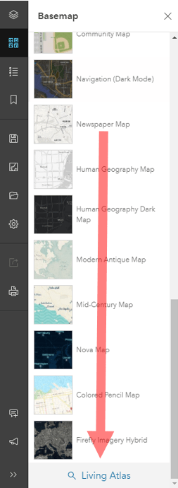

Discover basemaps from ArcGIS Living Atlas of the World
Map Viewer Beta now allows you to easily access basemaps from ArcGIS Living Atlas of the World. Containing hundreds of basemaps, including historical maps, reference maps, and more, ArcGIS Living Atlas is a tremendous resource for finding the right basemap.

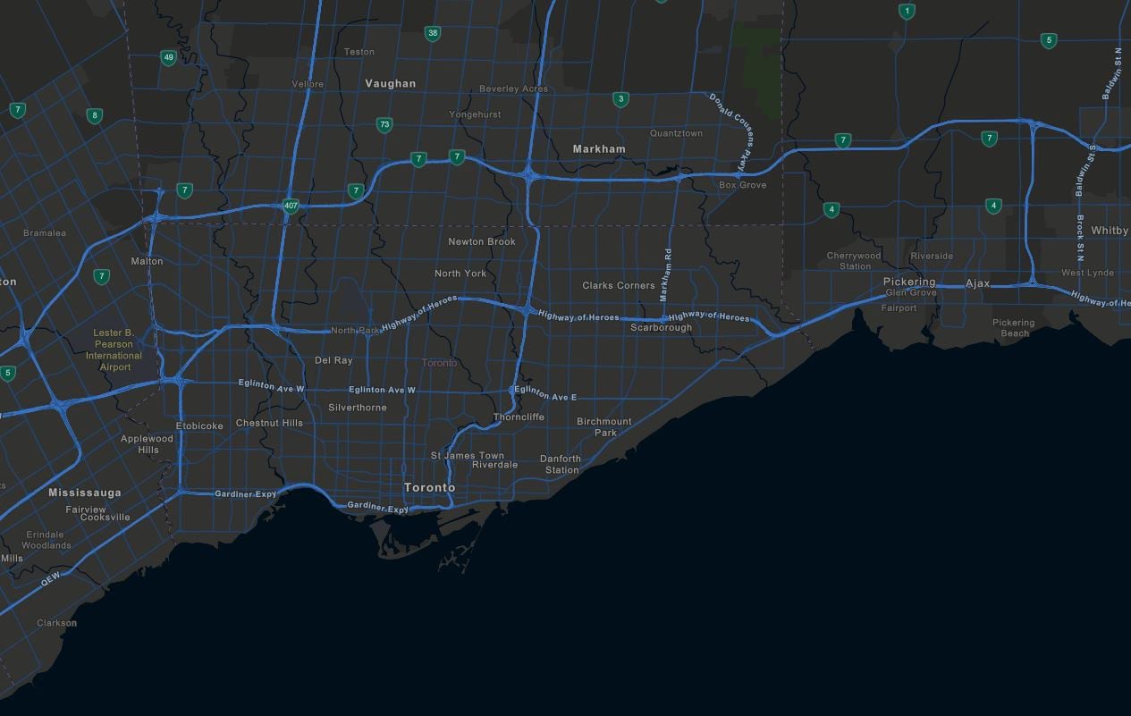

Here is an example using the city of Toronto, which is commonly rotated in local maps.
Toronto rotated
The city of Toronto rotated.

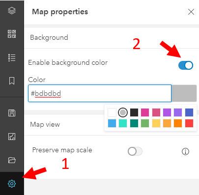

Background color is another useful feature now available in Map Viewer Beta. It can be used on its own or it can be used in combination with blending. For example, you may need to set a background color for areas the basemap doesn’t cover. The background color could be part of the overall thematic focus of the map or it could be a color that fits in with organizational themes.
Background color can be configured from the map properties button on the map contents toolbar on the left.
Background color
Configure the background color for your map.

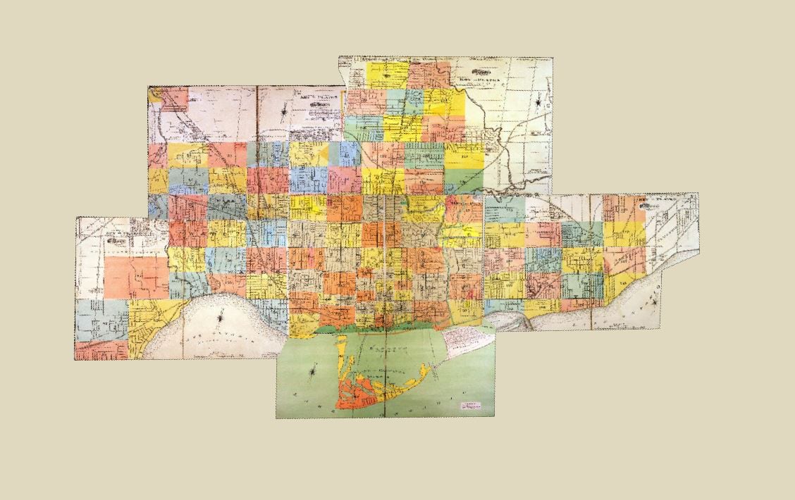

Here is a straight-forward example using a historical basemap of Toronto. The extent of the basemap is limited to the city of Toronto. Rather than displaying a white background, I adjusted the background color to fit with the map a bit better. For workflows where you intend the map to be embedded in a website, consider adjusting the background color to fit the color scheme of the site.
Map with background color configured
Map of 1913 Toronto with background color configured.
