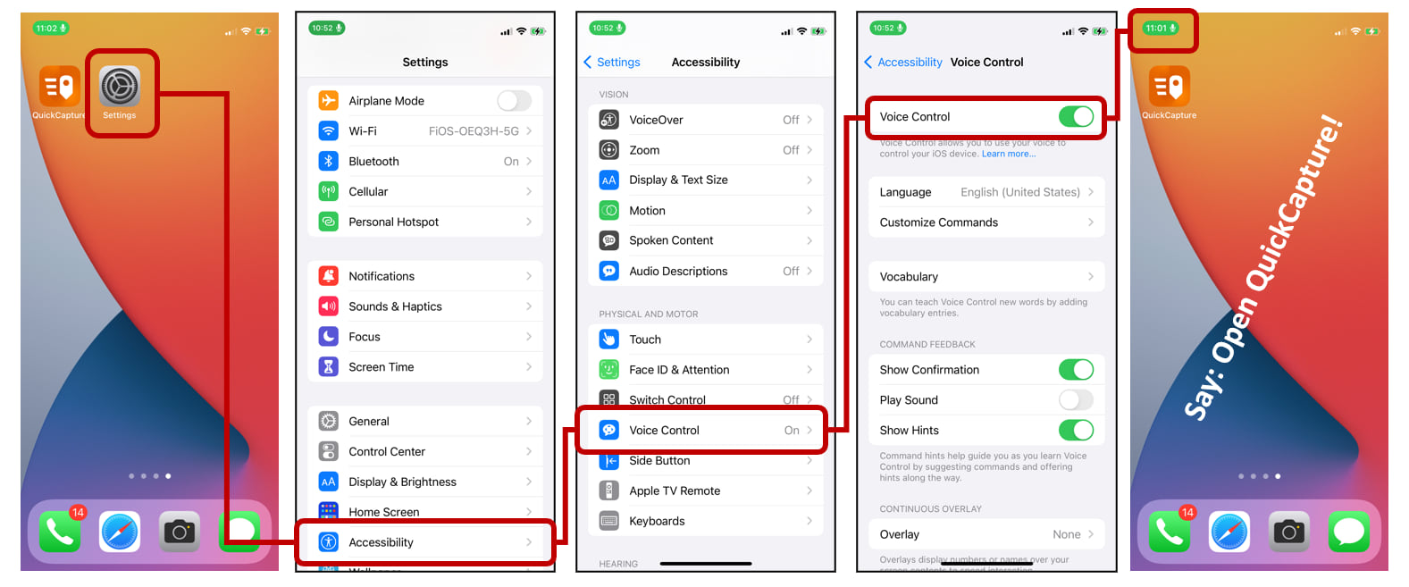

To configure your iOS device to use Voice Control:
  • Go to Settings
  • Tap on Accessibility
  • Tap on Voice Control
  • Turn on Voice control (A file download may be required at this moment)
  • Go back to the Home Screen
At the top-left corner of your phone, in the status bar, you will see a blue microphone icon indicating that Voice Control is actively listening to your commands. If the microphone icon is grayed out, say “Wake up” to activate Voice Control.
Now say, “Open QuickCapture” to launch the QuickCapture app.
To open a QuickCapture project from your the My Workspace page, say “Tap” followed by the name of your project.
To collect data, say “Tap” followed by the label of the button you want to tap.
Say “Go home” to return to the home page on your phone.
Follow instructions in this image to enable voice control in iOS
