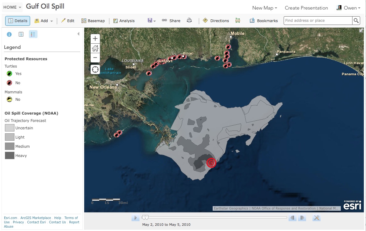

Step 1: Create a web map with a time-enabled layer
You’ll need to start by making or finding a map that has at least one layer with temporal data like this web map of the 2010 Deepwater Horizon oil spill in the Gulf of Mexico. If you are new to time-enabled layers you can learn more about publishing and configuring time on layers.
Once you add a layer with time you’ll see a time slider at the bottom of the map that controls how the time data is displayed.

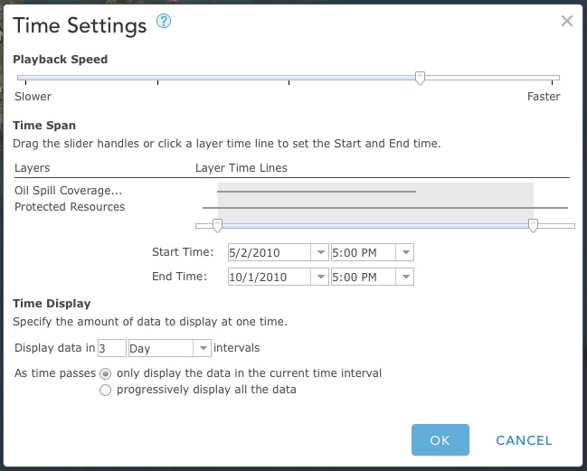

Click the Configure  button on the time slider, click Show advanced options, and configure the time span and time display for the map. These settings control the overall extent of time shown by the slider and the time window shown on the map (learn more about configuring time settings in a map).
When the map layers and time settings are configured, Save the map.

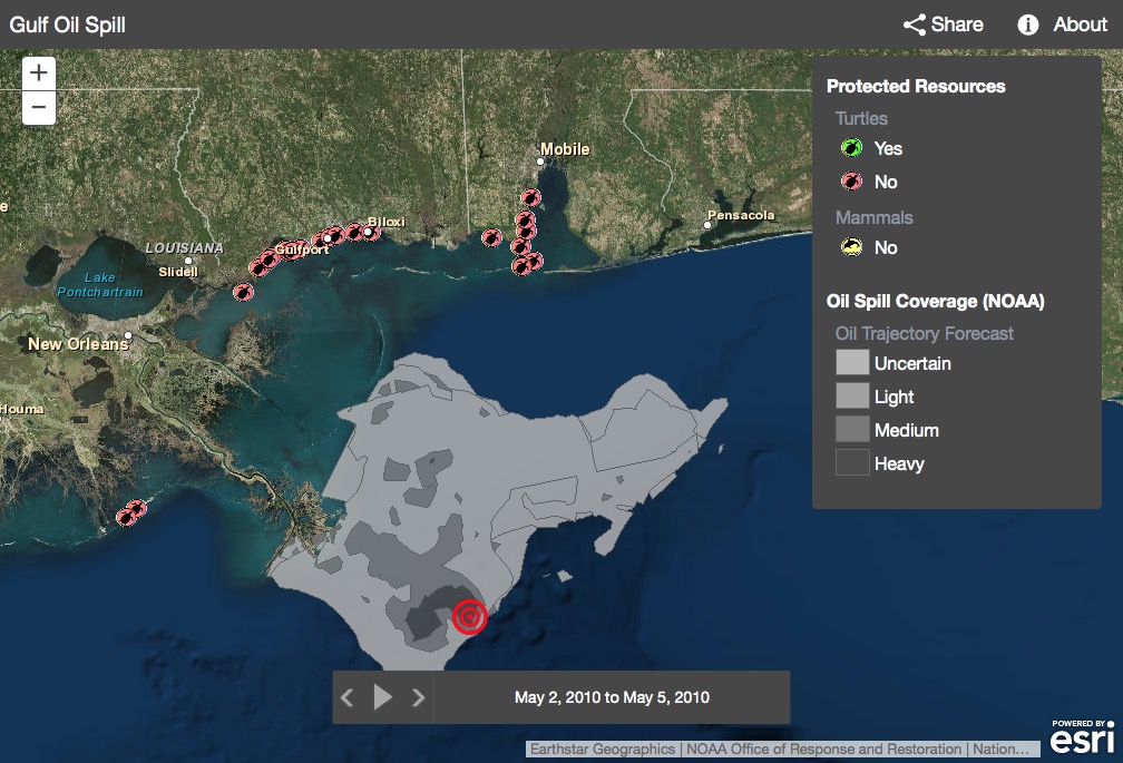

If the app is available, you’ll see something like this once you finish creating the app.

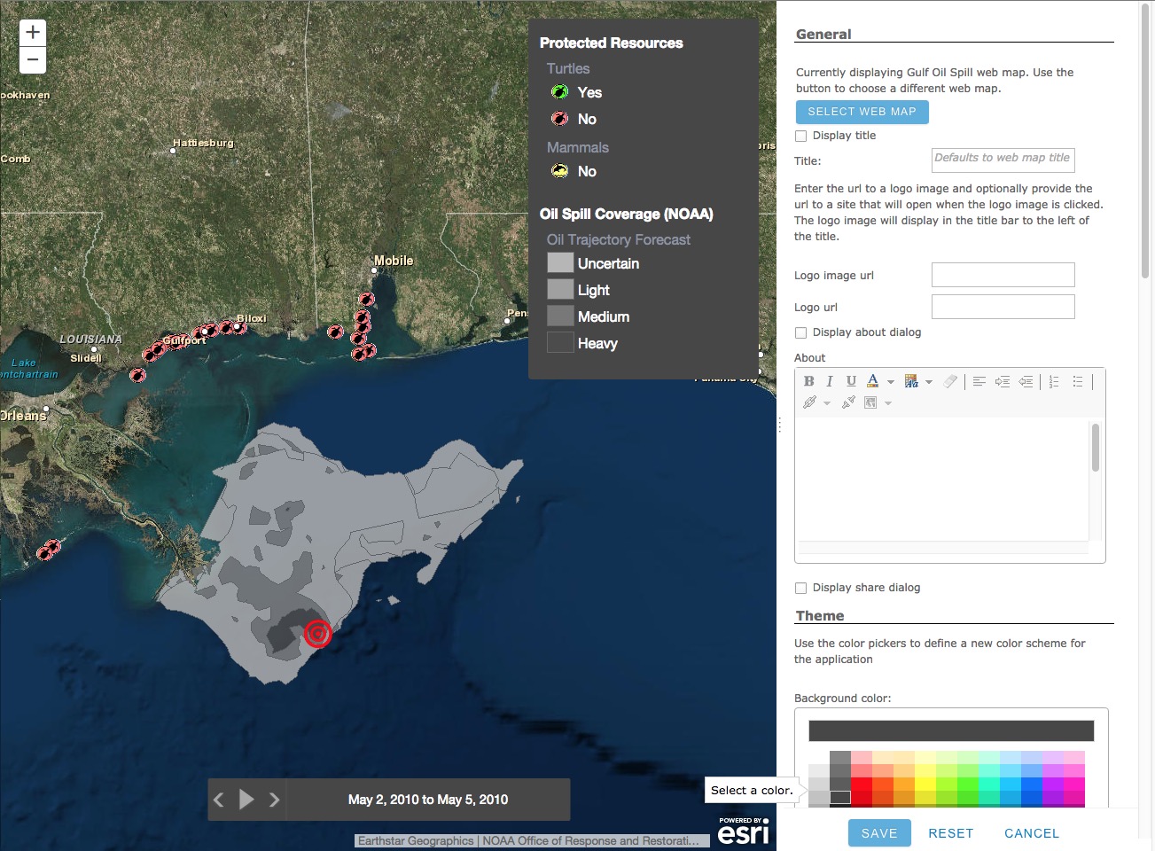

Now you’ll use the configuration panel to adjust how your Time Aware app looks and behaves. The configuration panel should be visible when you first create the app, but you can always access it by going to the app’s item page and clicking Configure App.

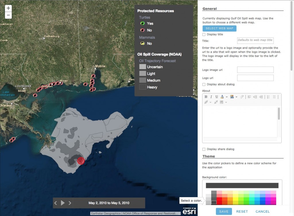

When embedding the Time Aware app in a Story Map it’s best to turn off Show Title, Display about dialog, and Display share dialog in the General settings. If you uncheck these three settings the header bar will be removed, which works best for embedding this app in a Story Map.
The default dark grey theme pairs well with most Story Maps, but you can choose different theme colors for the legend and time slider if you like. There are also configuration panel sections to tweak the Time Display, Map Tools, and Search options for the app.
Once you’re done configuring, don’t forget to Save your configuration changes.

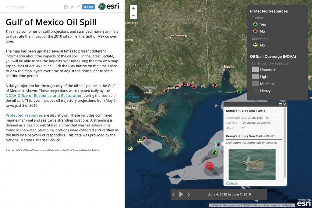

Here is a simple example of a Time Aware app in a Map Journal.
