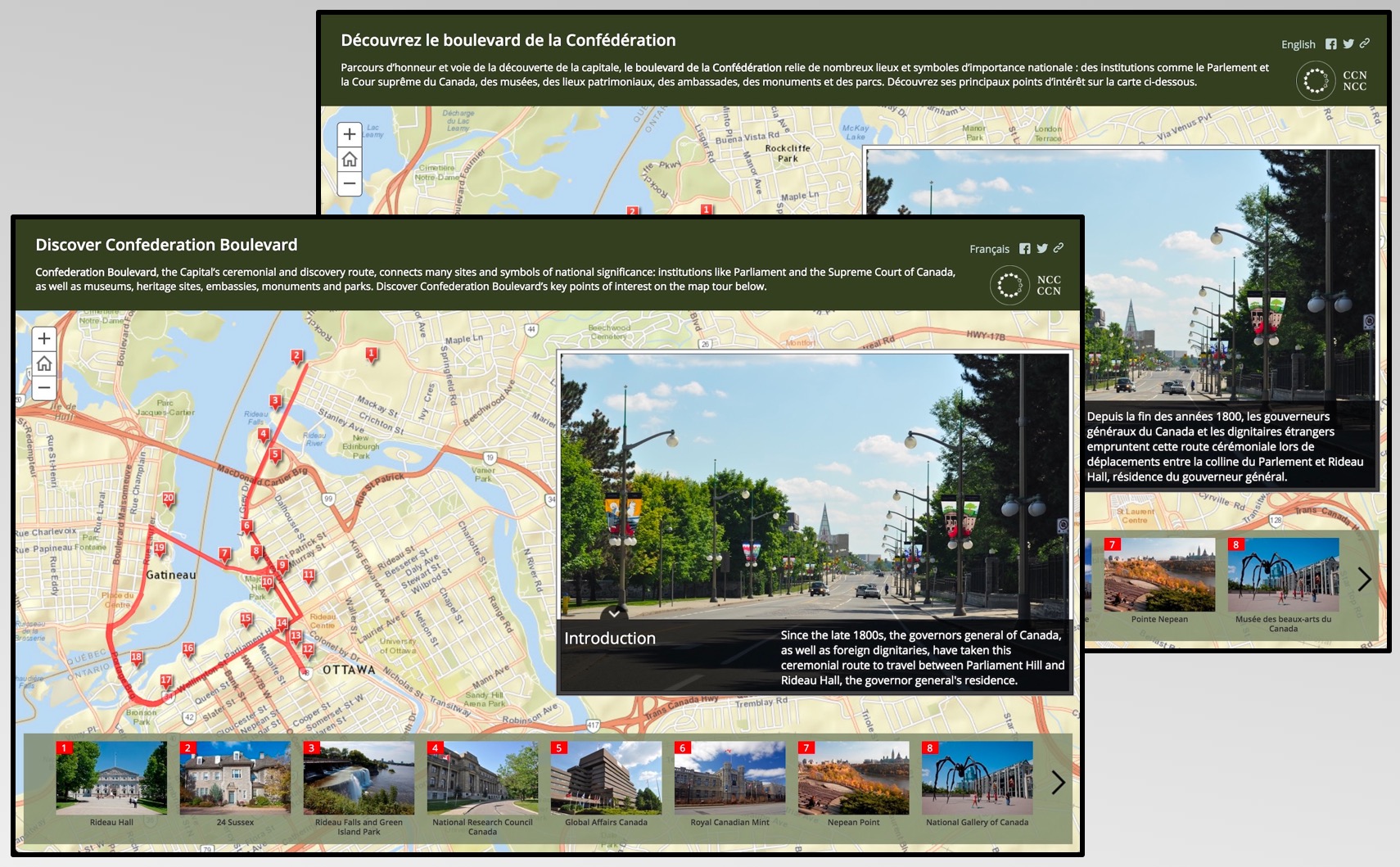

Authors sometimes need to publish a story map in more than one language to effectively reach everyone in their intended audience. For example, employees of governments with two official languages may be required to publish content in both languages. Below is a Map Tour created by the National Capital Commission in Ottawa (available in English and French). Readers can click the link in the top right to load the story in the other language.

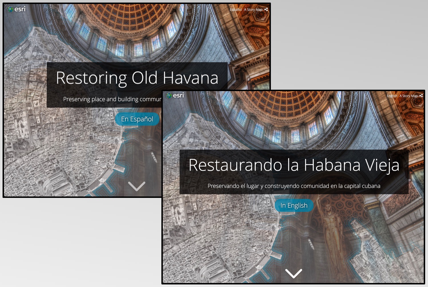

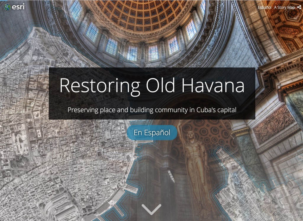

In some cases, the topic of a story may suggest that it should be made available in multiple languages, such as this story by Esri’s Story Maps Team about the restoration of Havana, Cuba (available in English and Spanish). In this case, there is a blue button on the cover that readers can use to read the story in the other language.

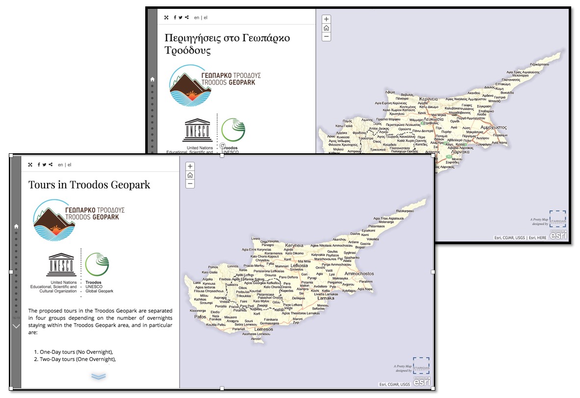

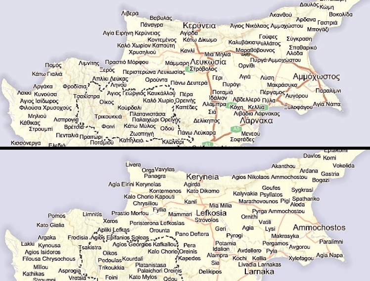

  2. Create alternate, translated versions of all media elements from the original story. For infographics or charts, be sure to translate any labels or text. For maps, be sure to consider translating labels and pop-up content. Here’s a story from Staridas Geography that’s available in English and Greek that uses different label layers for each language (see screenshots below).

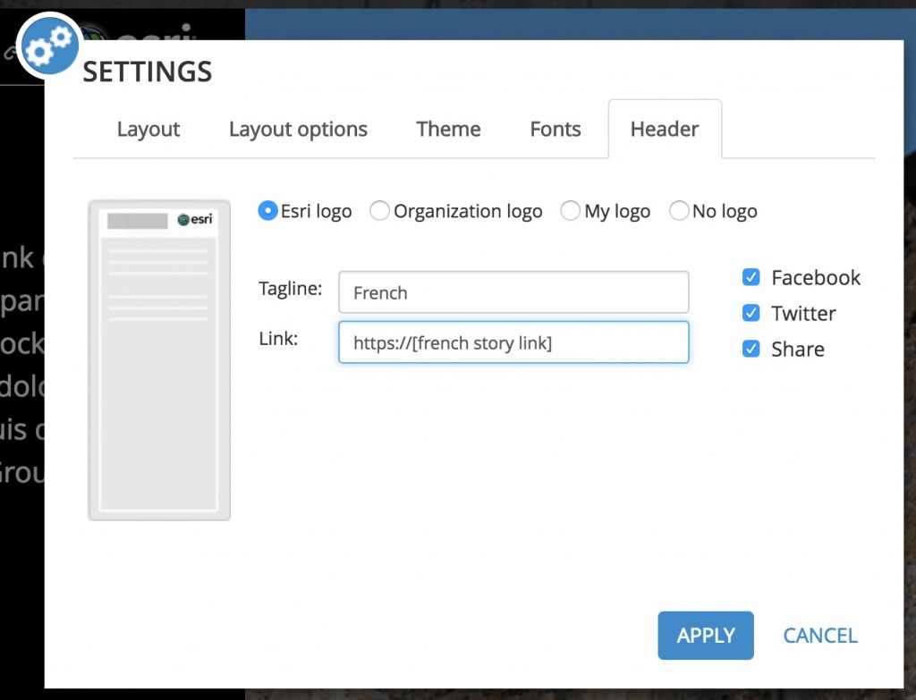

The easiest way to link the translated versions of a story is to use the tagline or header link. The header link usually shows “A Story Map” and links to the Esri Story Maps website, but the text and link are configurable. In each version of the story you’d enter the language of the other translation as the tagline and then enter the link to the other story.
For example, let’s say you have a story that you created using the Story Map Journal app and wrote in English. Then you created another Map Journal for the French translation. For the English version of the story you’d open the Map Journal builder and go to Settings > Header and change the tagline to “French” and the link to the URL of the French story. Then you’d do the same thing in the French version of the story to point the header link to the English version.
This works well if your story is available in two languages. The Map Tour about Ottawa mentioned at the beginning of this blog post is a example of this technique.

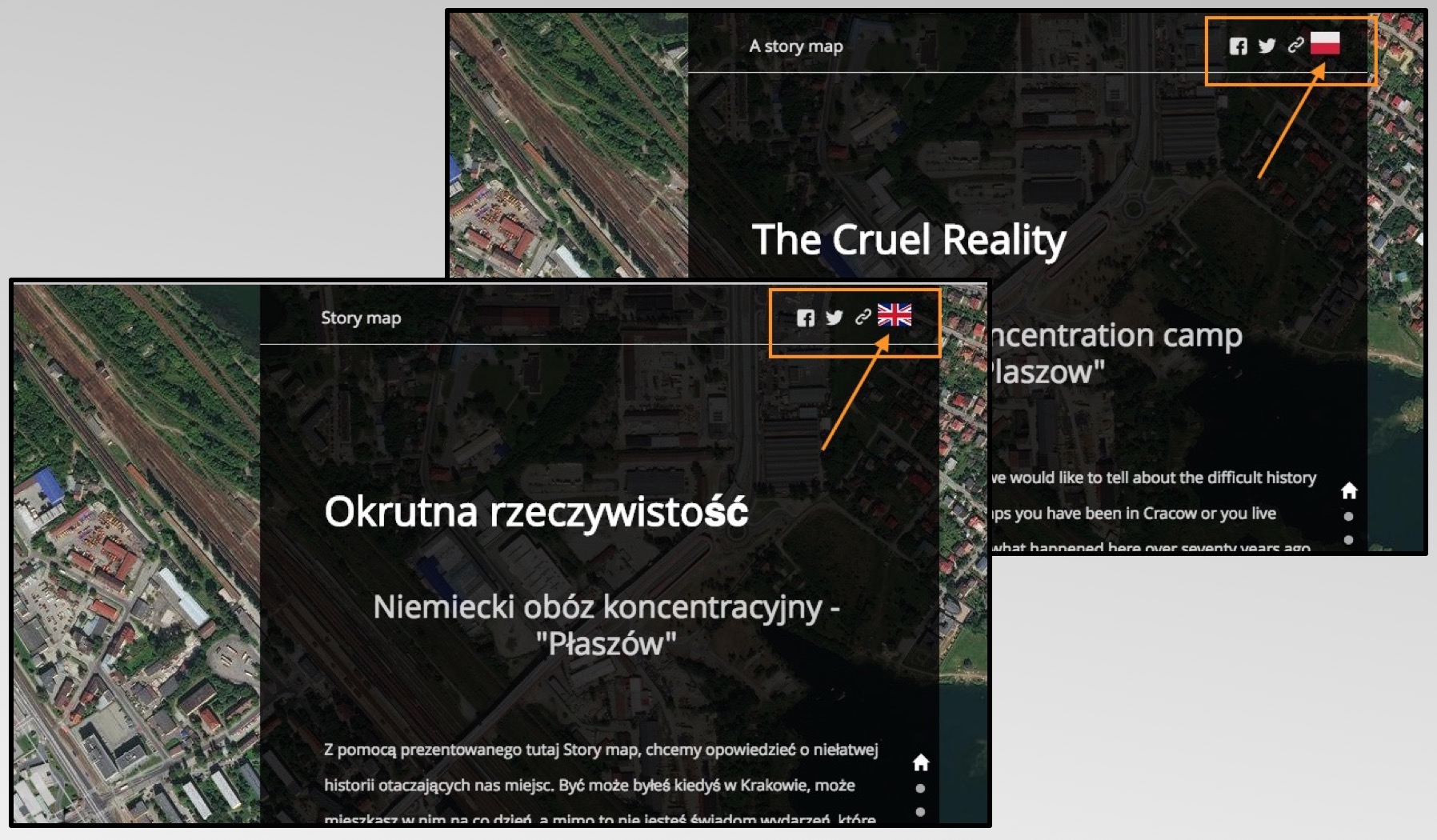

You can also use the logo to link between translated stories. The Cruel Reality is an example of a story that’s available in English and Polish and flags are used to indicate that a translation is available. Clicking the flag loads the story in the other language.

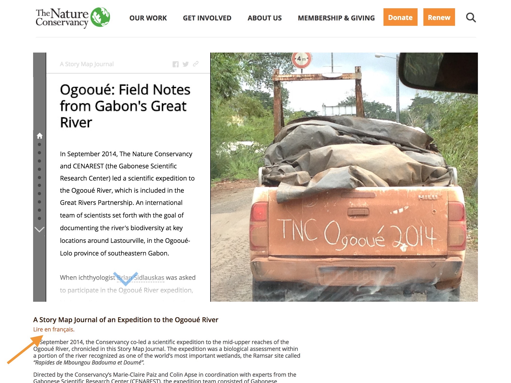

Add the story maps to a web page on your organization’s website (custom)
You can also add translated story maps to a page on your organization’s web site. Here’s an example of this from The Nature Conservancy for their Map Journal story about the Ogooué River in Gabon.
Add a button on the cover to switch languages (custom)
Because Esri’s Story Map apps are open source, you can download the code from GitHub and modify it to create a custom language switcher, like the button on the cover of the Havana story mentioned above. If you want to know how to add a language switch button to a Cascade story and get the sample code, see this article on our Story Map Developers’ Corner blog.

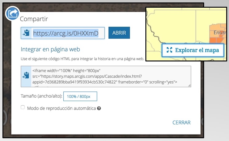

Translate the user interface text
After doing the work to translate your story narrative, you should also make sure the user interface text of the story map app is translated. This includes components like the “Explore Map” button in Cascade and the Share dialog.
When linking to your story, for example from the header link, include the locale URL parameter at the end of the link so the text of the story map app’s user interface also appears in the same language as your story. See this blog post for more information about this technique.
