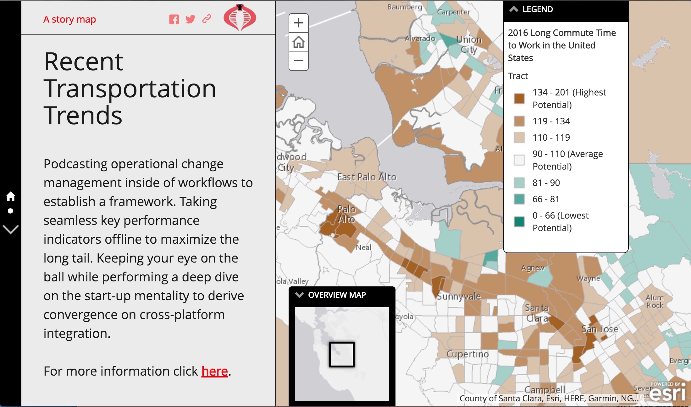

  • Story Map Cascade and Shortlist support the shared theme logo only because these apps don’t have the ability to customize colors.

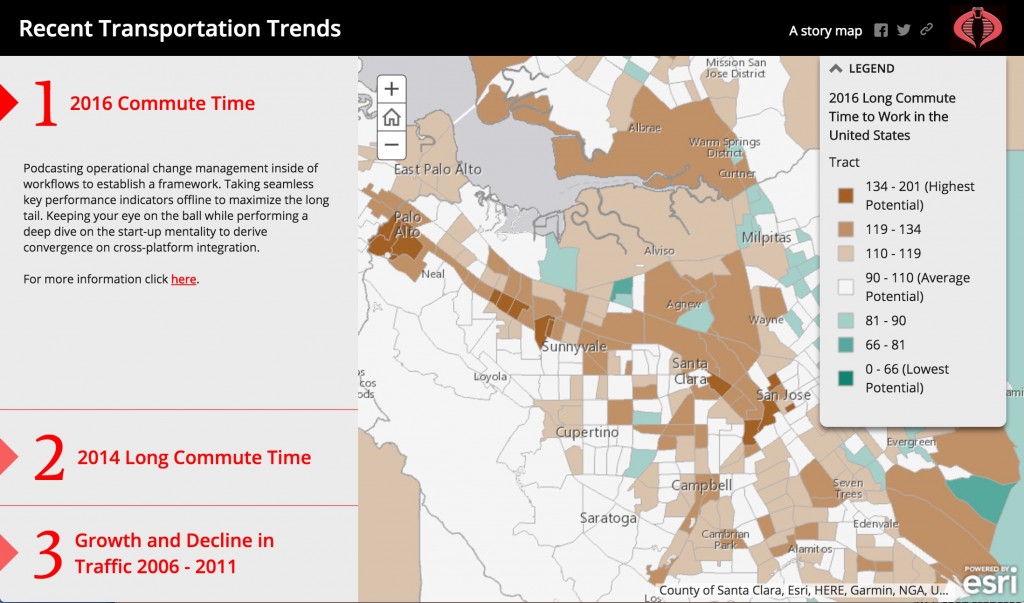

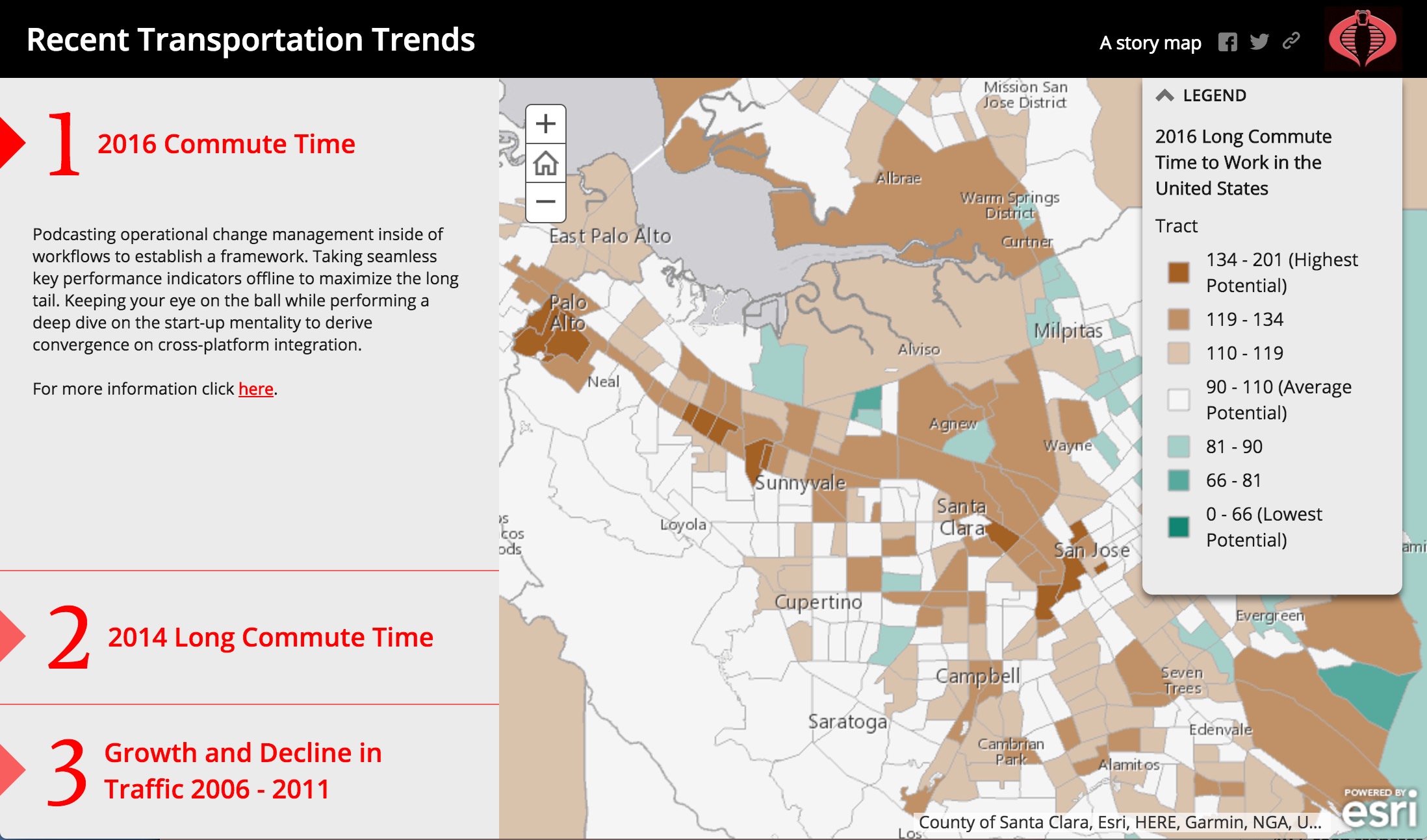

  • For new stories, the theme colors and/or logo are applied to your story when you launch the builder.
  • For existing stories, you can choose to apply the theme colors (if supported) and logo independently, so in any story you can use either one, both, or neither.

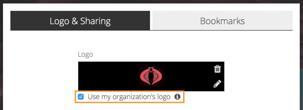

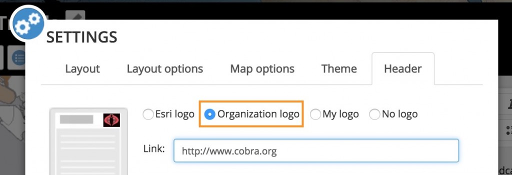

To apply the shared theme to a story you have already created, go to Settings and choose to use your organization’s logo. It’s also recommended to configure a link to your organization’s home page so that readers will be directed there if they click on the logo in your story.

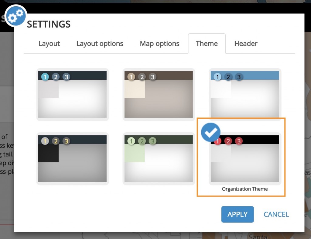

Then, if your story is a Map Series or Map Journal, you can go to Settings > Theme and select the Organization Theme to apply the theme colors.

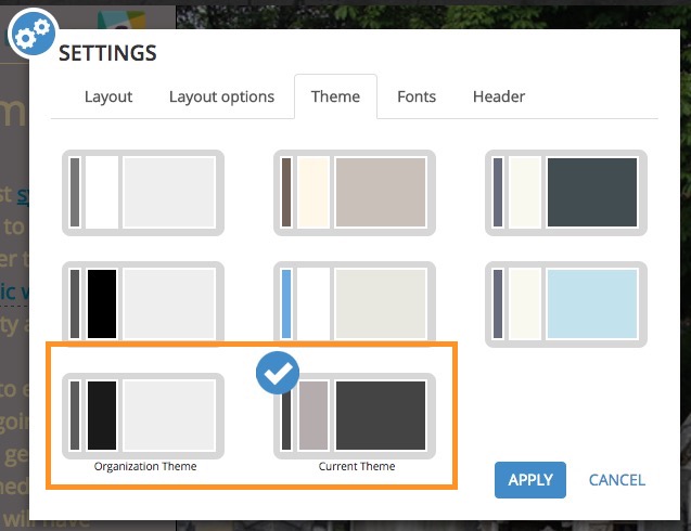

If an administrator changes your shared theme after you have applied it to one of your stories the story will not automatically change to reflect the new theme. The next time you open the story builder you will see Organization Theme and Current Theme in Settings > Theme. The Current Theme is the theme currently applied to your story (the old shared theme).
To update your story to use your organization’s latest shared theme, choose Organization Theme, apply the changes, and save your story. If you apply a different theme to your story and save it, the Current Theme will remain available only for that builder session; it will not be available next time you load builder.
