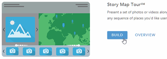

Step 2. Launch the Story Map Tour builder.
One way to launch the Map Tour builder is to click the Apps tab at the top of the page, scroll down to find Story Map Tour, then click Build.

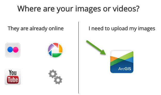

Step 3: Choose ArcGIS to upload your images.

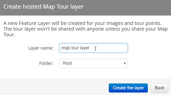

You will be prompted to specify a feature layer name. Enter the Layer name, then click Create the layer:
Note: You must be a Publisher or in another role with privileges to publish hosted Feature Layers. Please contact your ArcGIS administrator if you do not have these privileges. This option is also unavailable for those using a public account.

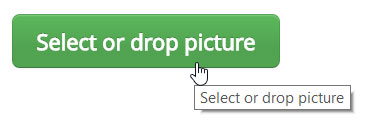

Then drag and drop a local image, or click Select or drop picture to browse and select it.
Your images will be optimized and automatically stored as attachments for each point in your tour, one for the featured image and another for the thumbnail.

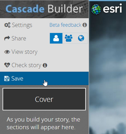

Step 3: Add a title to your Cascade cover section, then Save.
Once your story map has been saved, you will be able to add locally stored photos.

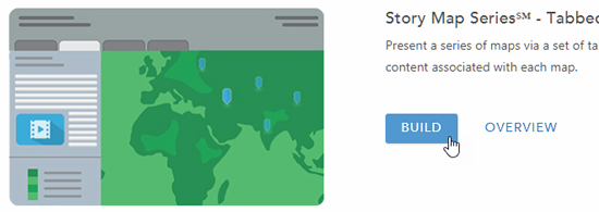

Step 2: Launch the Story Map Series builder.
One way to launch the Series builder is to click the Apps tab at the top of the page, then scroll down and look for Story Map Series, then click Build.
Step 3: Add a title to your Story Map Series, then click the arrow to advance.

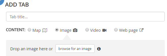

Step 4: Add photos.

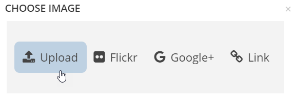

Anywhere you can add images, you’ll be able to upload local files. For example, when you add a Tab, choose Image and then click Upload.
To add local images, drag and drop them onto the box, or click browse for image to locate and add them.
Images are automatically optimized and stored with your Story Map Series. No special privileges are needed, and this option also works for public account users.

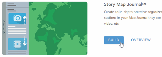

Step 2: Launch the Story Map Journal builder.
One way to launch the Journal builder is to click the Apps tab at the top of the page, then scroll down and look for Story Map Journal, then click Build.
Step 3: Choose a layout (Side Panel or Floating Panel), add a title to your Story Map Journal, then click the arrow to advance.

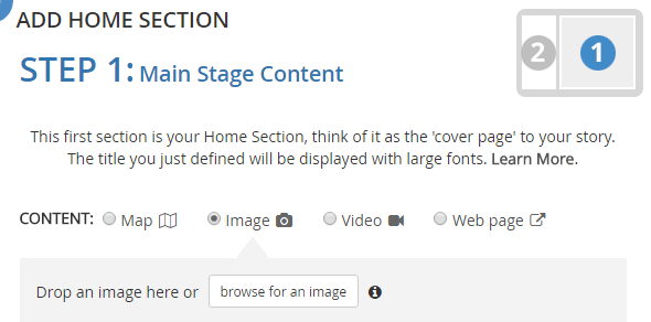

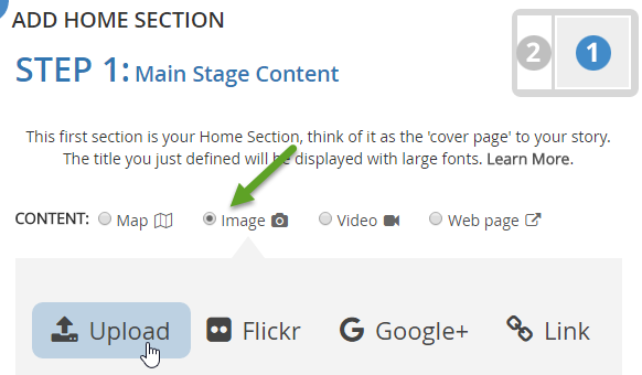

Step 4: Add photos.
Anywhere you can add images, you’ll be able to upload local files. For example, when you add Main Stage Content, choose Image and then click Upload.

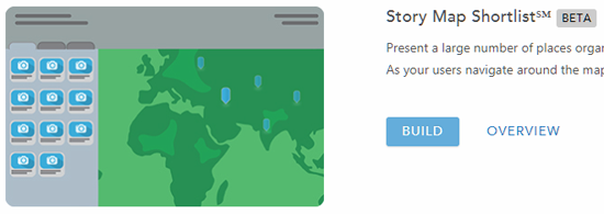

Story Map Shortlist
Story Map Shortlist enables you to present a large number of places organized into tabs based on themes, for example, food, hotels, and attractions. As your users navigate around the map, the tabs update to show them just the places in their current map extent.
Step 1. Sign in to your ArcGIS account.
Go to the Story Maps website at storymaps.arcgis.com. Sign in using your credentials.
Step 2: Launch the Story Map Shortlist builder.
One way to launch the Shortlist builder is to click the Apps tab at the top of the page, then scroll down and look for Story Map Cascade, then click Build.
Step 3: Add a title to your Story Map Shortlist, then click the arrow to advance.

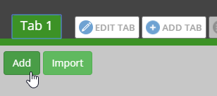

Step 4: In this mode, you can either Add or Import images to be placed on the map. Click Add.
Step 5: Click to browse, or just drag and drop to add a local image.
If you click to browse, choose Upload to add your image.
Images are automatically optimized and stored with your Story Map Shortlist. No special privileges are needed, and this option also works for public account users. When editing an existing Shortlist, you can follow the same general procedure to add local images.
