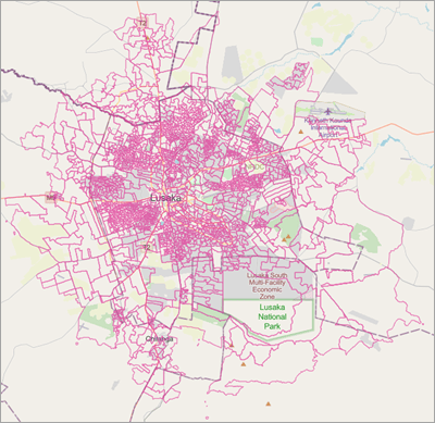

Map of sample EAs in Lusaka Zambia
Lesson sample EAs in Lusaka Zambia
Using Survey123, the lesson demonstrates how to start with existing EAs and create a survey that can be used to update these EAs for the next census.

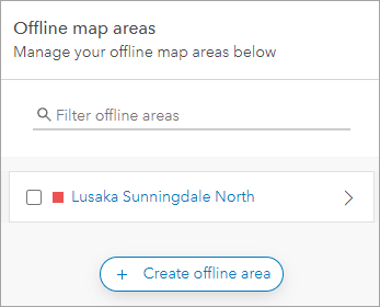

With offline areas in the webmap, the person using the survey will have the option to download these areas ready for when they go offline.
Screenshot of ArcGIS Online settinsg showing available offline area for the webmap
Offline area ready for use in the survey

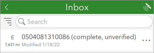

Whilst completing the survey, fieldworkers have the option to check a box to say they are complete. With this check made, the record will be identified in their inbox as ‘complete’. Office staff checking records also have an option to check a box that say the record is ‘verified’, and this too is shown in the inbox.
This lesson demonstrates how to use these ‘complete’ and ‘verified’ statuses in the inbox to order records for viewing. Taking this a step further in your own surveys, consider adding an Inbox query to only show records that meet a desired criteria. For example verification_status=’Returned for field checking’ would only show records in the inbox that the fieldworker needs to check.
Screenshot of inbox that shows one record
Inbox showing record that the field worker has marked as complete, but has been unverified by office staff

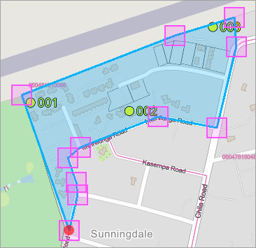

Polygons that represent existing enumeration boundaries are an important starting point for a pre-enumeration survey, but it is essential that these boundaries can be re-drawn to match the updated household information. When new buildings are added, a boundary may need to be made smaller to accommodate the denser population.
New boundaries can be drawn directly on a map in the survey, using the existing boundaries and building points as a guide.
Screenshot of survey that shows EA polygon on a map
New EA boundary created where there is no existing boundary
