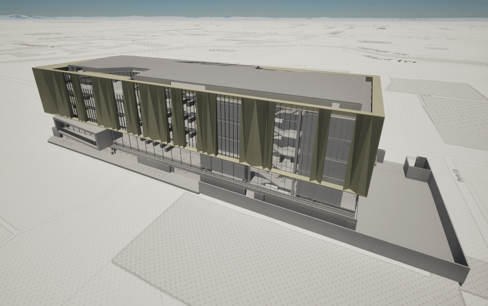

Building scene layer representing the Turanga Library in Christchurch, New Zealand (building data provided by Christchurch City Council).
Opened in October 2018 and covering approximately 10,000 square meters over 5 floors, the Turanga Central Library in Christchurch, New Zealand is a good example of a complex, modern structure digitally designed and recorded in great detail. It has been published as a building scene layer, derived from an original Revit Model by Christchurch City Council, enabling us to use the new tools in the latest release of the Maps SDK for Unreal Engine to explore the building. For example, by filtering out the primary aspects within the architectural discipline such as the walls, floors, ceiling, and roofs we can show all the interior aspects and various adornments.

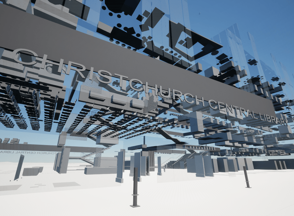

Filtered building scene layer (building data provided by Christchurch City Council).

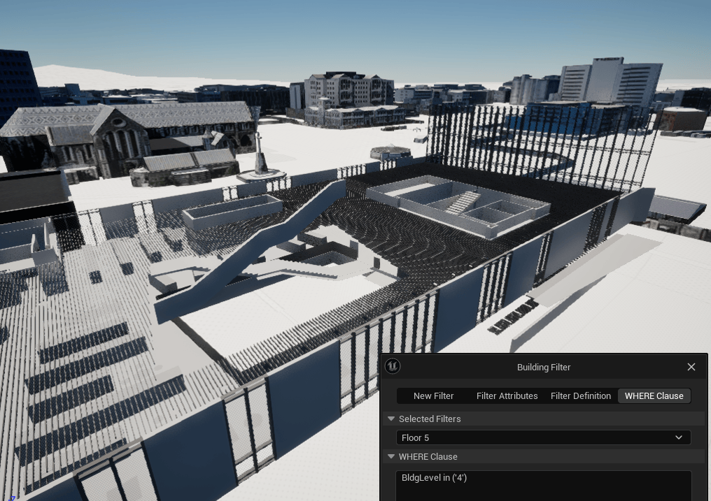

In addition to filtering by discipline and category, these new UI tools enable you to create custom filters based on SQL expressions. Here we’ve used this capability to filter the entire building by the building level and show just the content for a single floor.
