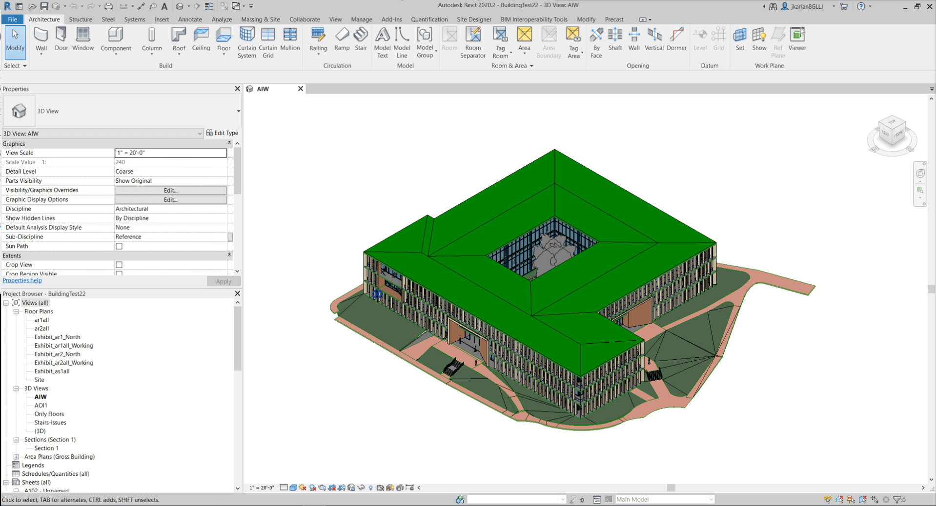

First, let’s make sure your model is ready in Revit.
1. Open up your Revit Model
2. To Geolocate your model in Revit, go to the Manage tab, select Coordinates, and go to Specify Coordinates at Point. Input your Coordinates of your project site.
      • For a more in depth description on adding in your Coordinates, check out this blog here.
3. When you’re finished, go to File and Save as a Project. This will save your model as an .rvt file.

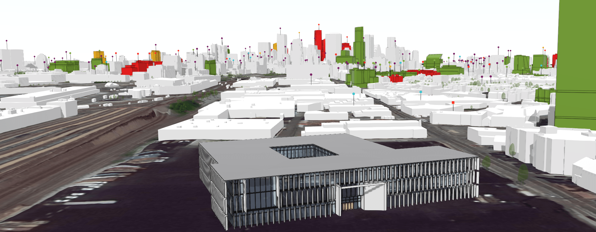

Finally, we’re now able to add the BIM model into ArcGIS Urban to view it with the surrounding context.
1. Open your ArcGIS Urban Model.
2. Press the Add Button and select Projects.
3. Draw in the new Project Polygon and press Add Project.
4. Fill out some information like the Name, Description, Status, etc. Press OK.
5. Select the new Project, go to the Options button and choose Configure.
6. Go to the Scenarios Tab and choose a Scenario.
7. Under Design Visualization, choose your uploaded Scene Layer and press OK.
8. Press OK again and go back into the Urban view.
