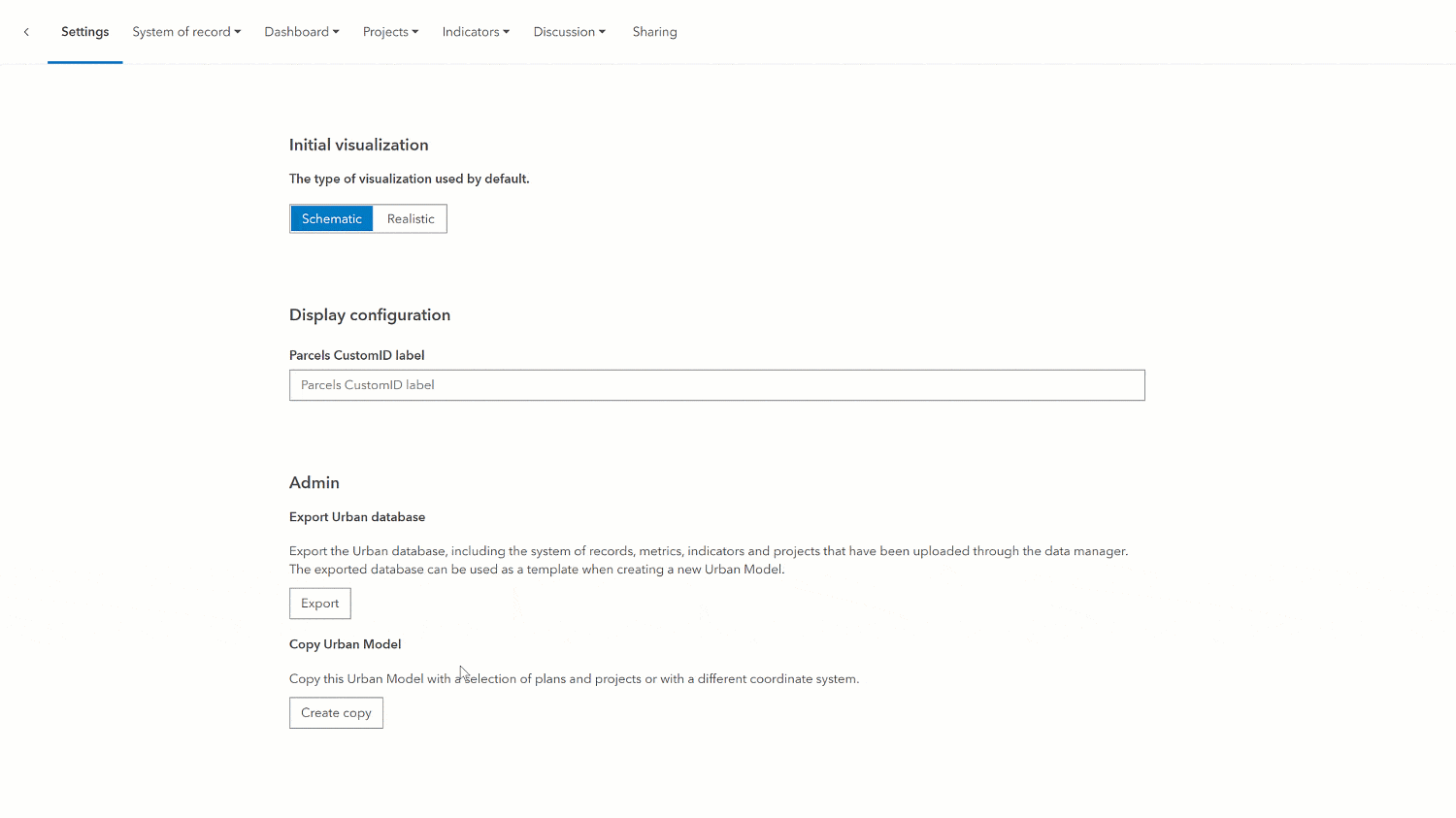

For existing urban models in Web Mercator you can create a copy to another coordinate system so you can benefit from the advantages of the coordinate system support without having to rebuild everything from scratch. After copying the urban model to another coordinate system, the existing urban model remains available as the original copy.
Copying an existing urban model with a selection of plans and projects.
When creating the copy, you can select plans and projects that you want to copy over to the new urban model. You can only copy plans and projects that you have access to and where the owner allowed for non-owners to save them as duplicates. Additionally, the copied plans and projects will initially be owned by you and do not carry over sharing settings. You can make use of the report to reset ownership of plans of projects after copying.
Alternatively, you can also only copy the urban model without plans and projects and then ask owners to copy their plans and projects to the new urban model individually. In this step, the plans and projects will be converted to the coordinate system of your new urban model, but the ownership does not change.
You can use the step-by-step guide in the Copy an urban model section in the documentation to copy your own models.

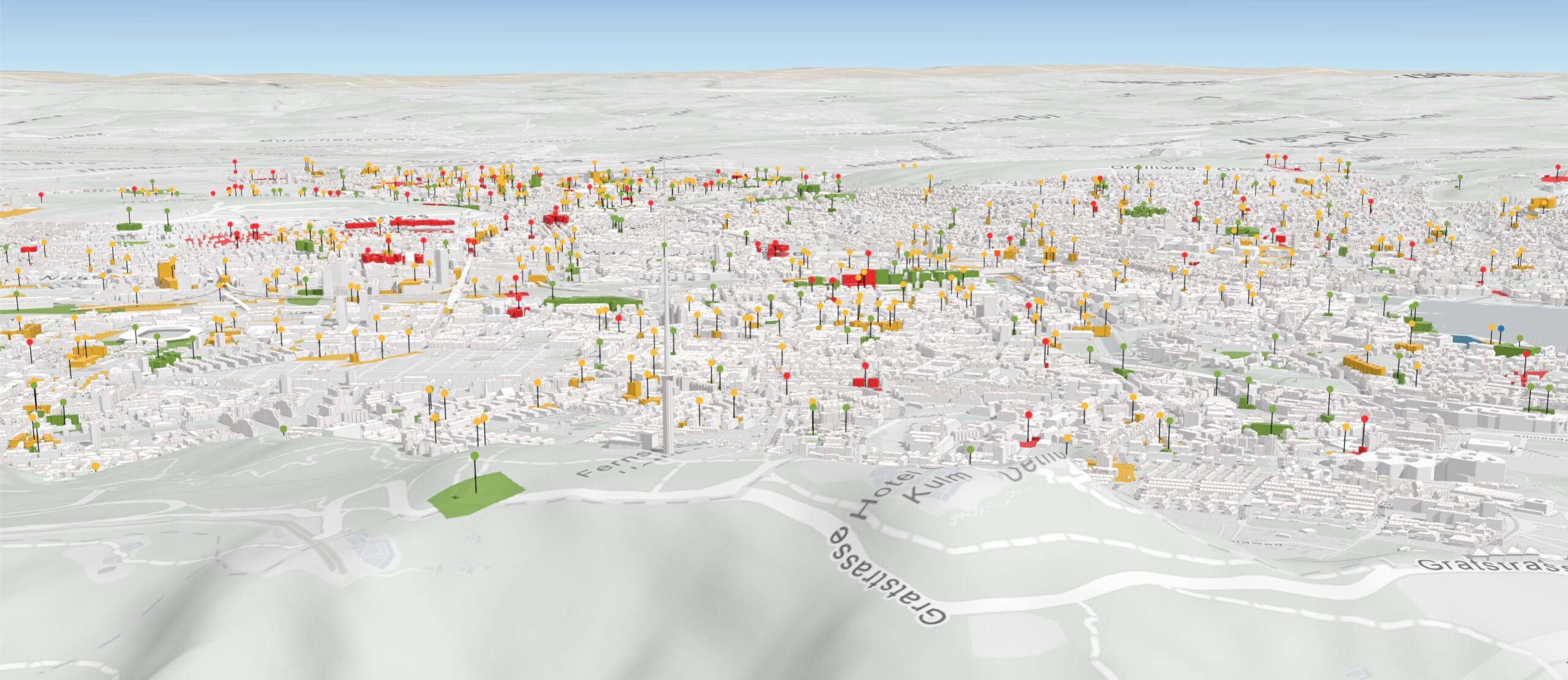

Example of an urban model for Zurich in CH1903+ LV95
For our example of the city of Zurich, you can create a copy of the Web Mercator urban model in the projected coordinate system. After copying, you will need to replace the Web Mercator 3D base layers in the data manager as they need to be in the same coordinate system as the urban model. The new urban model is now in the CH1903+ LV95 coordinate system and is displayed in a local scene in Urban.

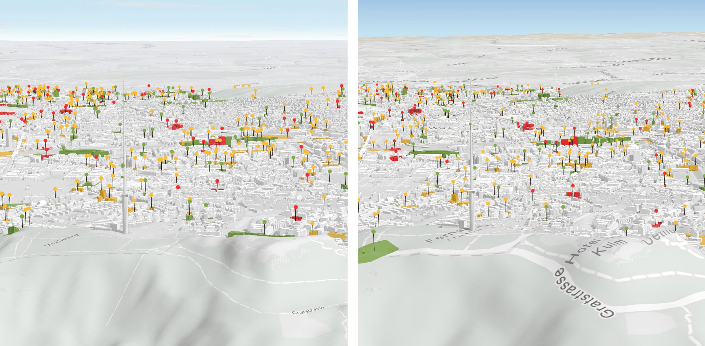

The global urban model of Zurich (left) next to the local urban model of Zurich (right). Visually, there are only slight differences.
