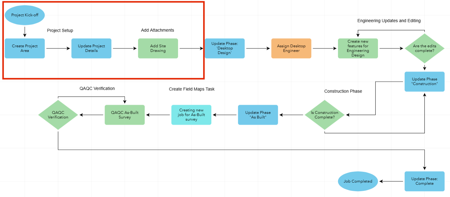

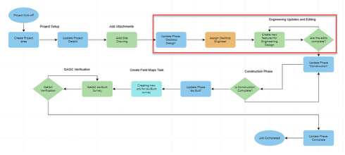

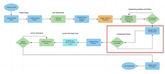

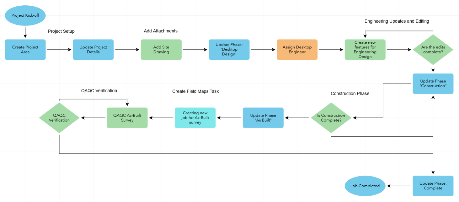

Workflow Manager Diagram 1 – New Meter Installation
In our workflow, we have two job templates (with their own sets of steps and assignments) that we will be using to perform and track the work. The parent job template will walk the user through the creation of the new Meter Installation project, assigning an engineer to add the new assets into the GIS, and then walk through the construction steps. Once construction has been completed, the workflow will create a child job using the second job template to assign a mobile worker to go and do a new meter verification task. While this is being performed, the parent job will be placed on hold waiting for the task to be completed. Once the new meter install has been verified, the job is routed through a QAQC process in ArcGIS Pro.

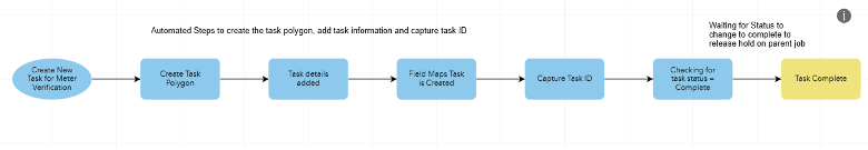

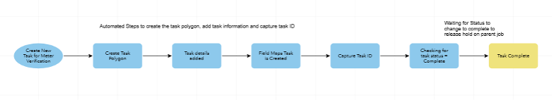

Workflow Manager Diagram 2 – Verification of New Meter Build

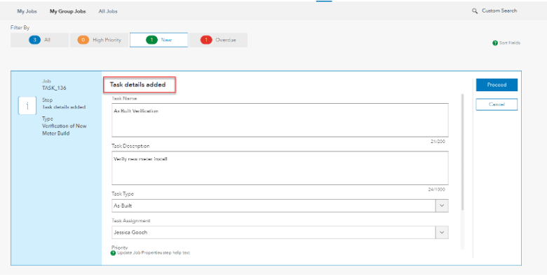

This child job consists of steps to create a New Meter Verification task* in ArcGIS Field Maps and assigns it so the field worker sees it in their list of work. Once the task is completed, this job will close, and the parent job will resume carrying out the remaining job steps.

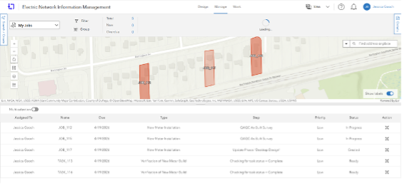

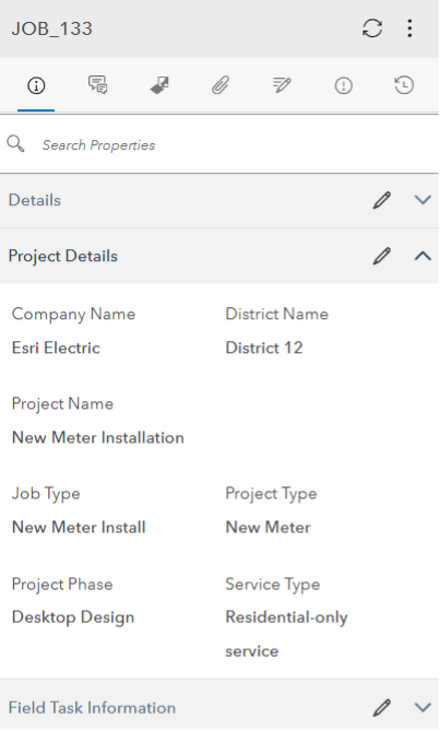

In the Workflow Manager web app, we can view and manage all of the jobs that are a part of our Meter Installation project. On the Manage page, we can easily view the list of jobs that have been created, see the assignee, job name, priority, due date, and more.

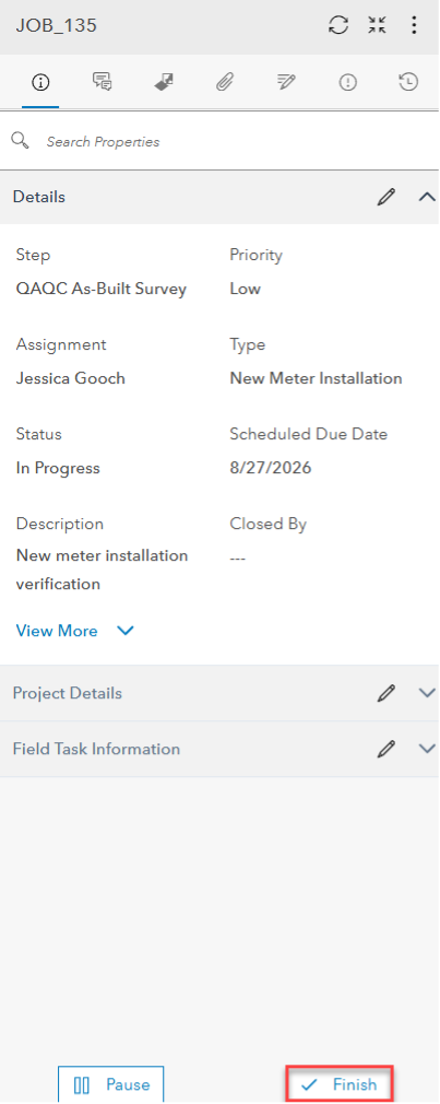

If we open the panel on the right hand side we can also view details about the job, project, and the field task information.

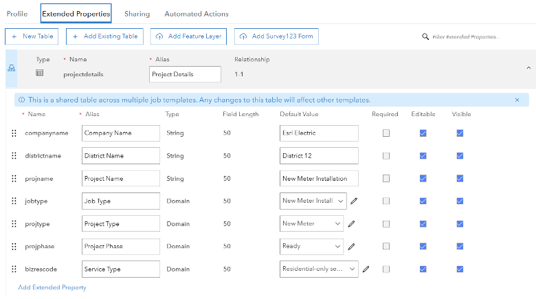

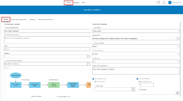

The Job details are set in the Design page under the Profile tab of the New Meter Installation job template.
And the Project Details are set under the Extended Properties tab.

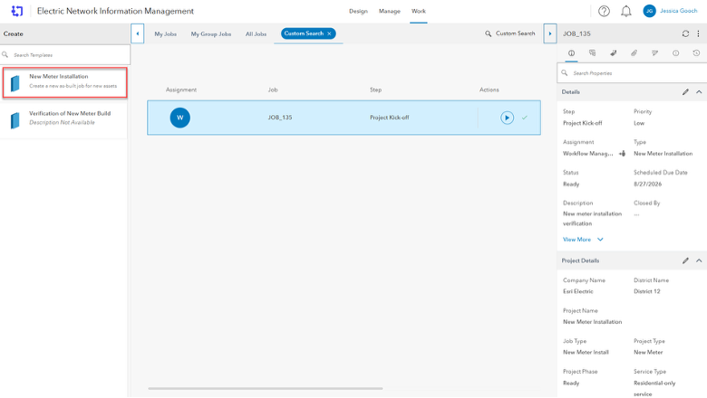

Opening the Work page, we click on New Meter Installation. This creates a new job, JOB_135. We will follow this job throughout the workflow. On the right-hand side, we see all of the important details of the job and the project.
We outlined earlier, where the Job and Project details are set up.
Kicking off the New Meter Installation Job
We are now ready to begin the job, and we start with the Project Kickoff step.

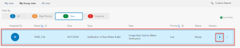

When we first start a job, we need to go to My Group Jobs to find the job because as we can see by the W this job is not assigned to a person, but to a group. To begin the job, we need to click the start button to move on to the next step.

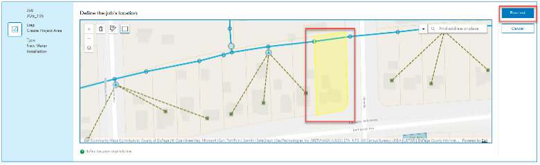

Create a project area
Once the kickoff step has been run, the job gets assigned and the Create Project Area step is now active.

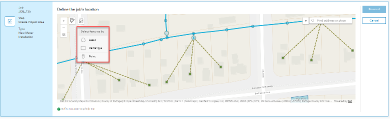

When creating a project area you can either select a parcel on the map or draw in a polygon. In this case, we will select the parcel that is associated with the new meter installation and create the job area.
Using the select tool, we select the parcel where we need to add a new meter and click Proceed.

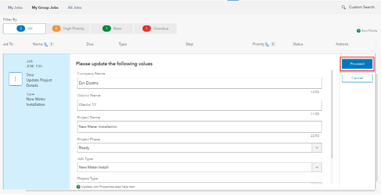

The next step is to verify or update the project details. If changes are needed, we can update, and if things are ready, we can click proceed.

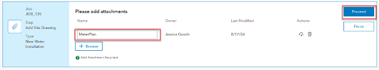

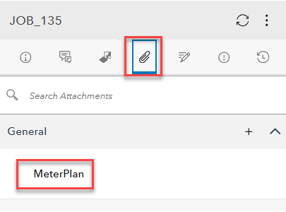

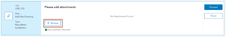

The next step allows the user to add any important documentation to the workflow. We have set up this step to allow for PDF documents to be attached. We click the Browse button to navigate to my document, which in this case is a PDF meter plan.
And then click Proceed.
Any document that is attached to the job can be accessed in the Job Details under the attachments button pane at any time.
Once validated that the required documents have been attached, we can move on to the next phase of the project which is the Desktop Design.

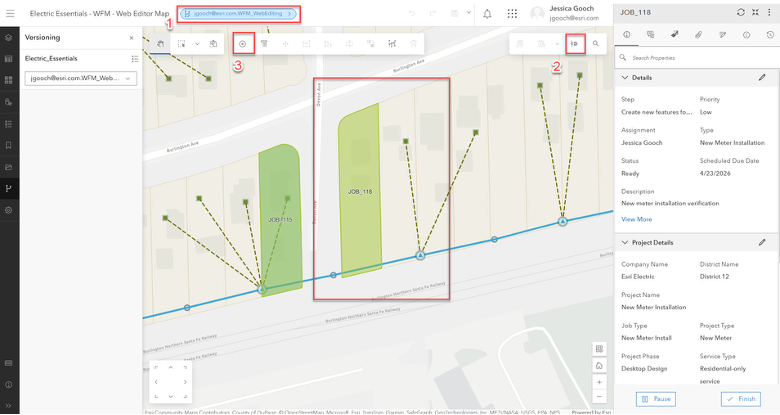

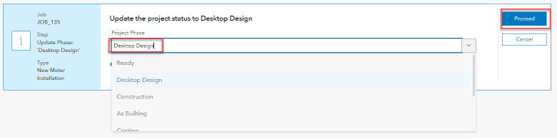

Desktop Design – Engineer
As these Meter Installation projects have multiple phases and can take weeks to months to complete, being able to identify which phase any given job is in is very important. At this stage we will be moving from the Project Kickoff phase to the Desktop Design Phase.
Let’s choose the project phase Desktop Design and click proceed.

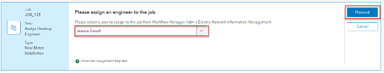

We now need to assign an engineer to add the new meter design. Once this job gets assigned to the engineer, they will then see this in their list of jobs to be completed.

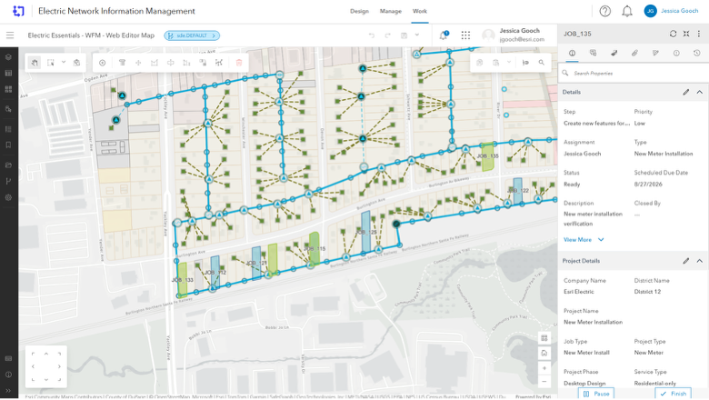

Use Web Editor to create the new features.

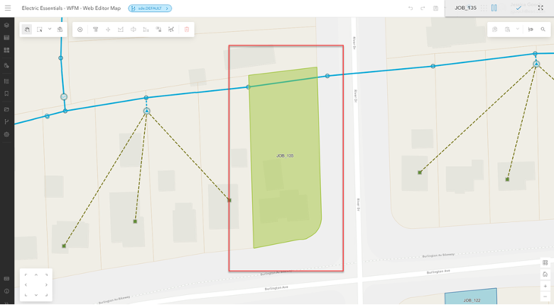

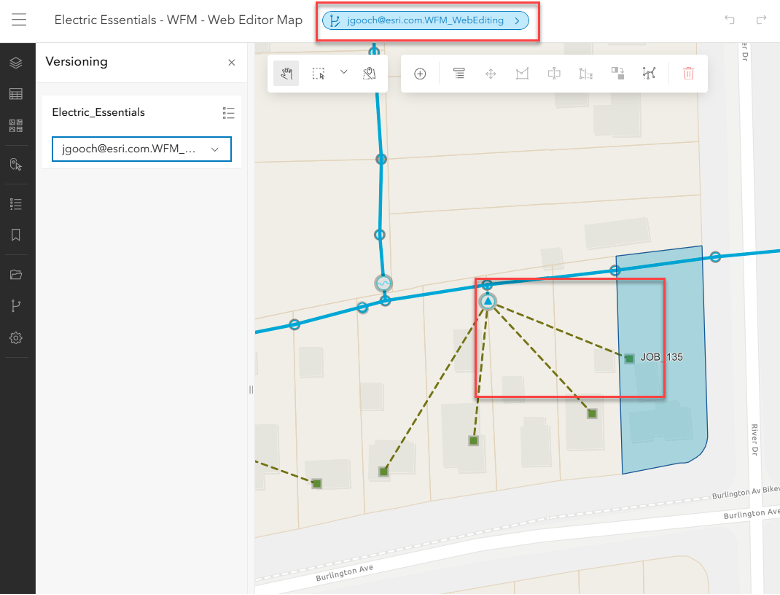

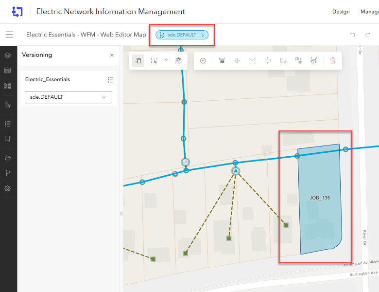

Next, we open the ArcGIS Web Editor to the map where the Engineer will then be able to add in the new meter and service line.
This step has been configured to open our editing map by using the Open Web Page step to link to ArcGIS Web Editor* and editing map.
*In this workflow we are linking directly to ArcGIS Web Editor and map, you could also create an ArcGIS Instant App using the Web Editor Template in ArcGIS Online and ArcGIS Enterprise 12.1.
The Engineer will now use this application to add in the new meter and service line.

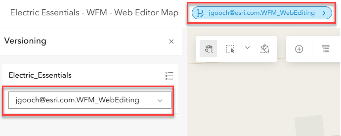

We can see what version of our database we are editing in – as seen here by the title
As it is best practice to not edit in Default, we can switch to and editing version:
Click where it says sde.DEFAULT and then search for the version you want to use; in this case it will be the WFM_WebEditing version.

First, we’ll zoom into the job location.

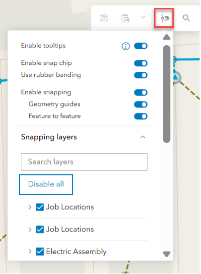

Next, Let’s enable snapping.

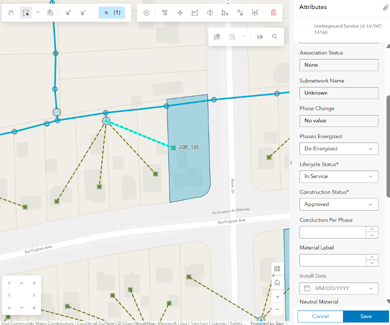

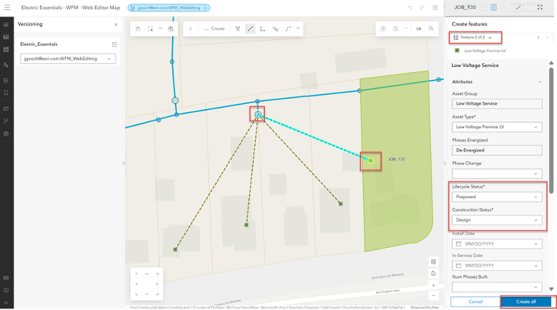

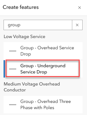

This web map has been configured with Group Templates to make editing and adding in repeating features easier. We click the Create button and search for the editing template we want to use.
1. Search for the editing template to be used.
2. Draw the new service by snapping to the transformer and drawing the line to the corner of the house.
3. Update attributes of each feature – in this case there are two features. As this is a Utility Network, we have updated the Lifecycle Status and the Construction Status to be Proposed, Design.
4. Click Create All.

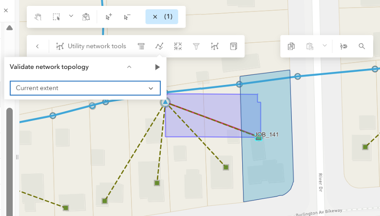

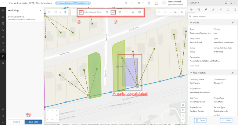

Validate the Edits and save.
5. Open the Utility Network toolbar.
6. Click Validate Edits.
7. Click Save Edits.
8. Click Finish to move to the next phase of the Workflow Manager project.

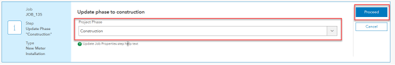

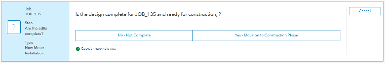

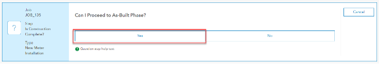

Now that the design has been completed, the job moves on to the Construction phase, where the workflow asks to double-check that you are ready to move on. In this case, we would click Yes – Move on to Construction Phase.
Construction Occurs
Seeing that construction of utility projects typically occur over a period of time, tracking each phase of work is vital to a utility organization. This type of data can be tracked in a dashboard for visibility across teams and key stakeholders. Because we are tracking progress over time, it is important to always keep the phase of the project updated. We are again asked to update the phase in the next step.
During construction of the new assets the team follows the design that was given to them. When installing new assets, sometimes the design vs. what is built changes. This could be due to an obstacle in the way such as a rock, tree, or ledge or it could be a property boundary or some other unforeseen thing on site. This is why the next step is critical.

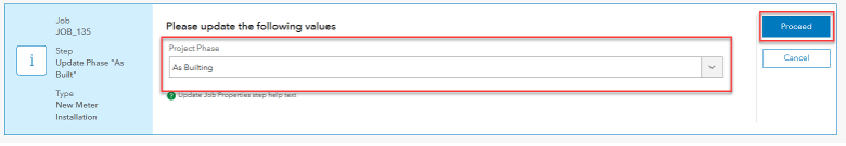

Once construction has been completed, which could take days to weeks or longer the workflow needs to proceed to the As-Built phase for the field work and verification process.

In this stage the workflow uses a child workflow diagram that will create an ArcGIS Field Maps task. While that task is being completed, the parent workflow is on hold, waiting for the child workflow to be completed.
This is done inside the “Creating new job for As-Built Survey” step.

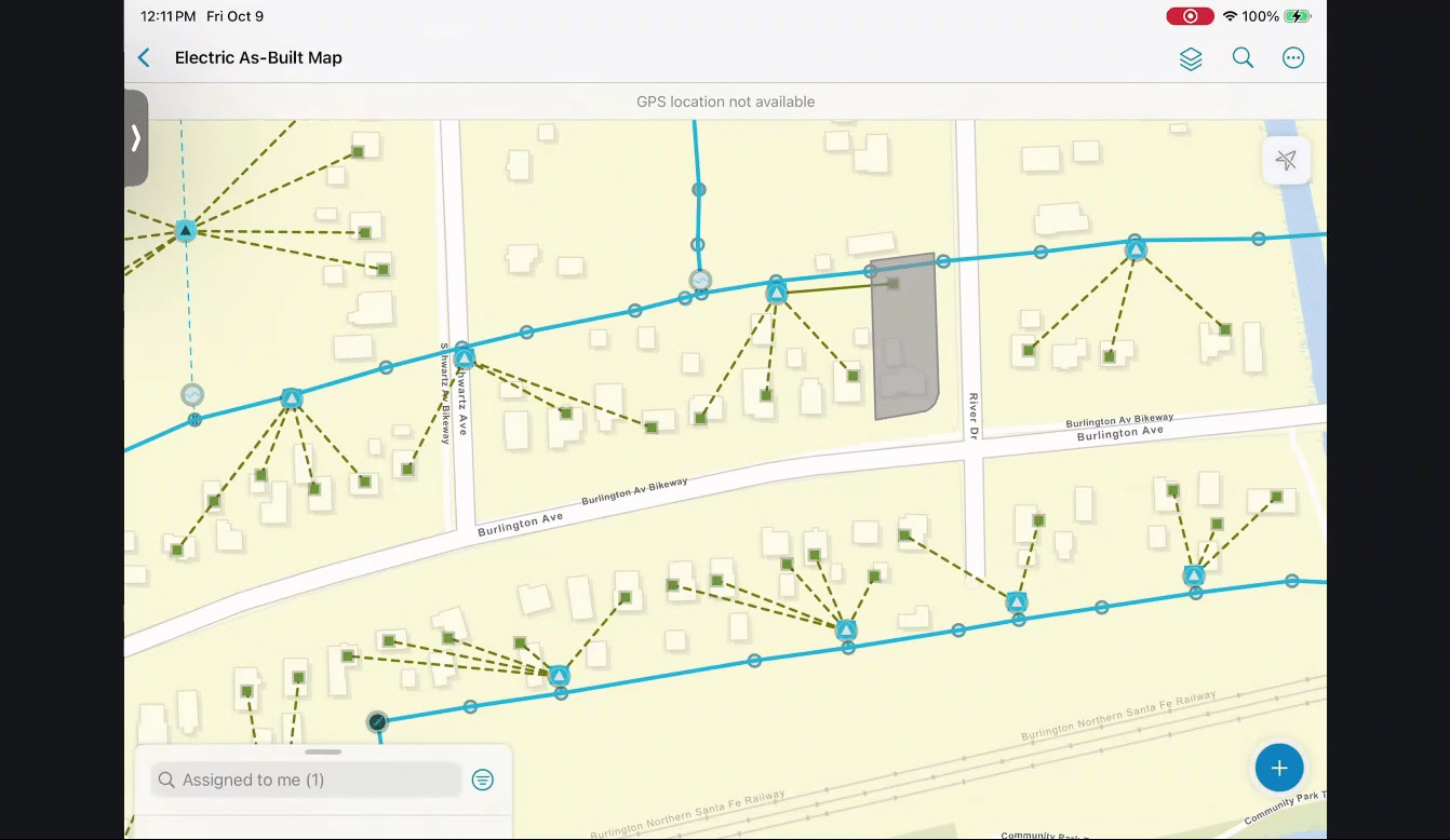

Once the new task has been created, the field worker can use ArcGIS Field Maps to access their list of tasks that need to be completed.
The field worker now can verify the design of the new meter installation with the as-built location where the construction team placed the new meter and service.
Using the app, the field worker has identified that the location of the as-built is different than the design and can indicate that on the map.

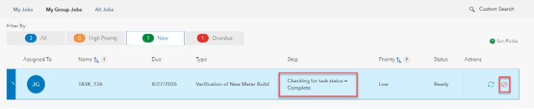

Now that the as-built location has been identified as needing to be relocated, the field technician clicks Finish, and the task disappears from the list.

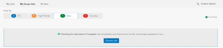

The Verification workflow is dependent on the task status to change to Complete. Once that happened, the job will automatically close and the hold will be released on the parent job.

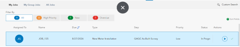

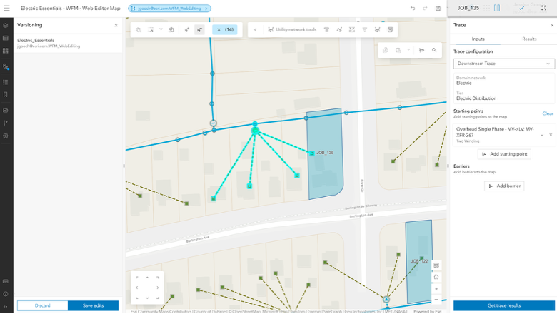

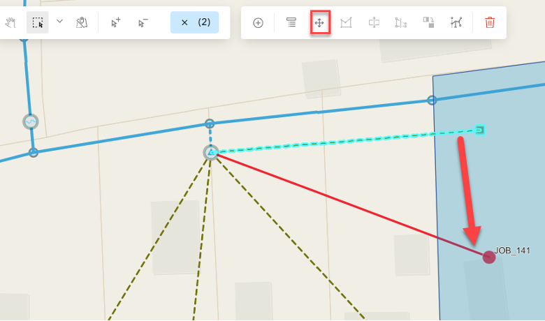

As part of the QAQC process, the GIS Analyst will open the next step in the process, which will provide the user with the Web Editor again. In order to view the new assets and complete the workflow we need to change the version from sde.DEFAULT back to the editing version.
First we need to update the attributes of the line and service meter and their location to add them to the network.
Then, we need to move the assets to the location of the as-built verification.
And validate our edits.

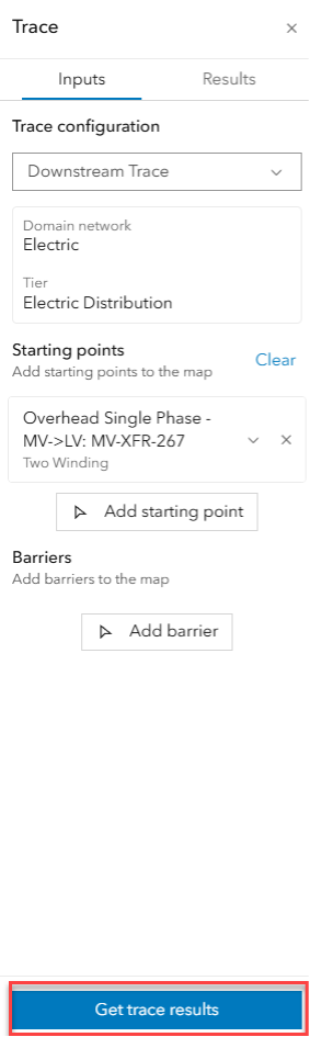

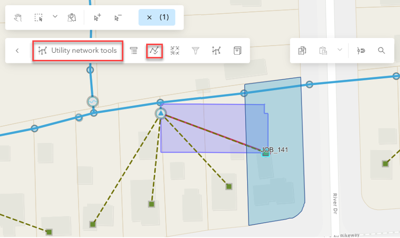

Finally, to check for connectivity we will run a network trace downstream from the transformer to ensure connectivity.

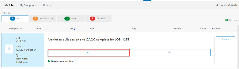

Now that we have finished our QAQC we can click the Finish button for this step.
We verify that the as-built design and QAQC are done for this job.

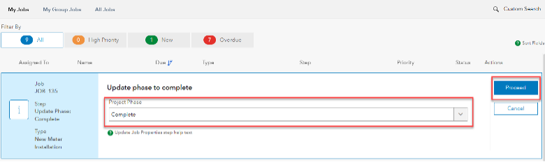

We change the phase to complete.

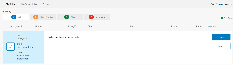

Now, the job has been completed.
Click Dismiss job and it is removed from the list.
