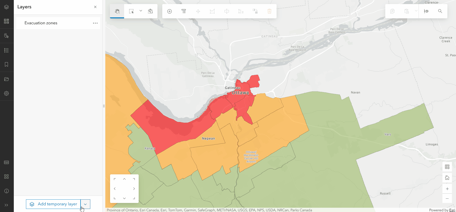

Gif shows a user browsing for a layer in their content and adding as a temporary layer to Web Editor
In this example, a terrain slope layer is temporarily added to provide context while editing flood evacuation zones.

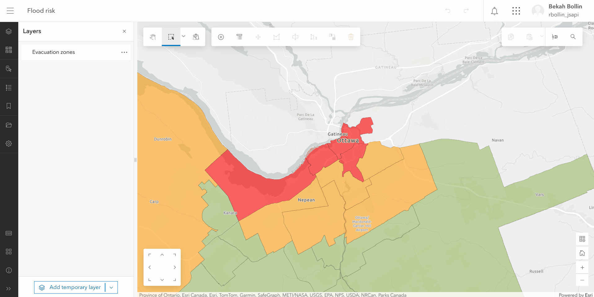

Let’s take a look at a real world example. Imagine you work in Public Safety, and you’ve been tasked with managing a public-facing map of evacuation zones during an emergency flooding event. A colleague sends you a shapefile with additional evacuation zones that need to be added to the map. With the new capabilities, you can:
  1. Add the shapefile to your map as a temporary layer
  2. Review and select the new evacuation zones
  3. Copy and paste them directly into your evacuation layer

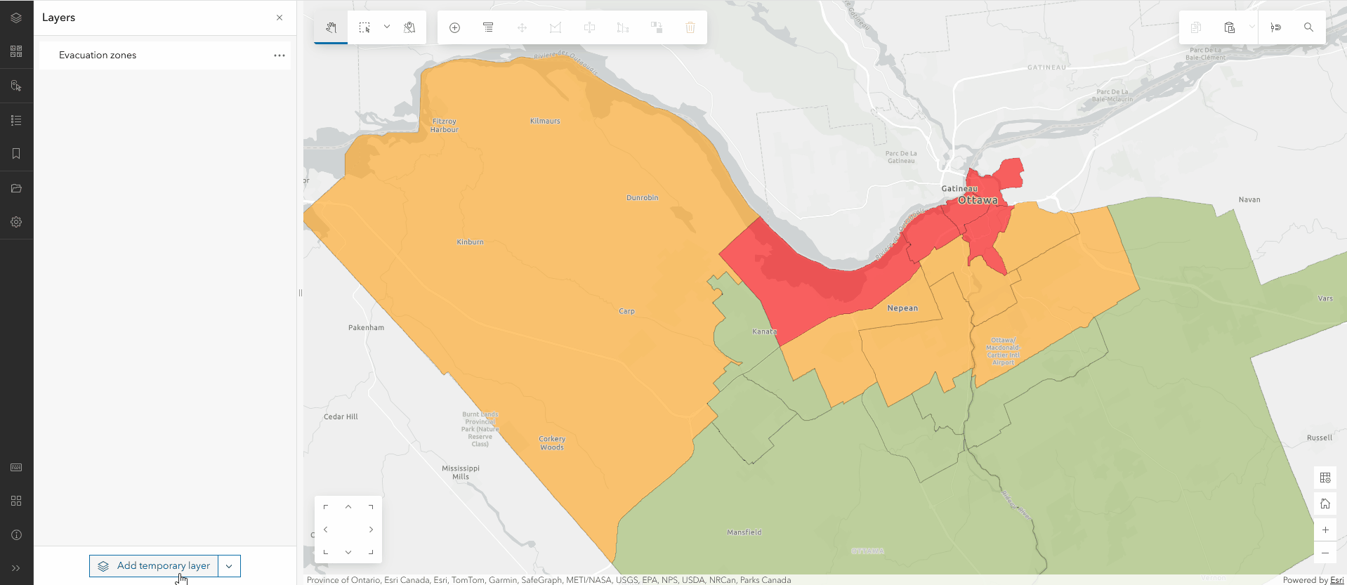

GIF shows a user adding a temporary layer to a web map, copying the featurs and pasting into their own layer.
There you have it: a simple and efficient way to copy and paste external data without making changes to your web maps. You can take this workflow a step further by creating a tailored Web Editor Instant App. Customize what capabilities and tools are available so your editors get the same powerful editing experience inside a focused, shareable app.
