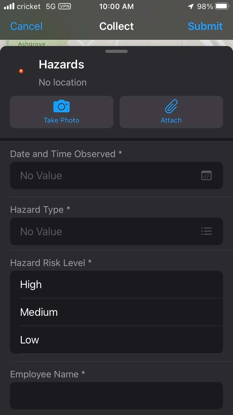

The workflow is fairly simple: a series of question steps ask whether field mitigation of the hazard is required, or GIS updates are needed, then a supervisor reviews steps along the way. The field workers are using ArcGIS Field Maps to submit their observations with a simple form as shown below:
Field Maps empty hazards collection screen
The field worker can capture responses for these entries in Field Maps and use them to automatically populate certain steps or the workflow path can be directed without any user input.

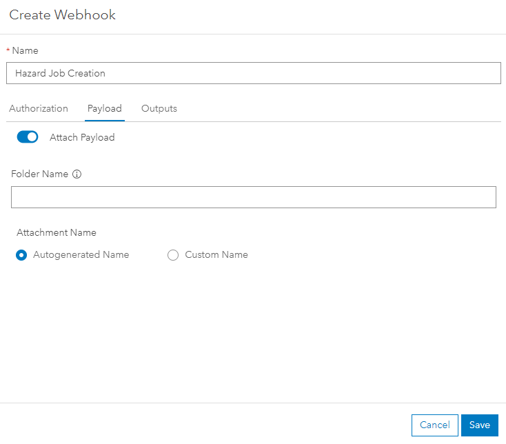

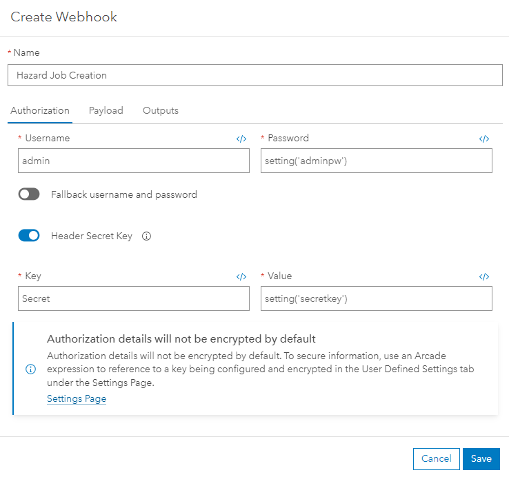

Creating the webhook receiver is fairly simple: enter authorization information, choose to attach the webhook payload as an attachment on the job, and configure outputs. In this case, we must check the Extract Changes check box to ensure changes are added as output values for the job.
Workflow Manager create webhook dialog, authorization tab
Workflow Manager create webhook dialog, Payload tab
Workflow Manager create webhook dialog, outputs tab

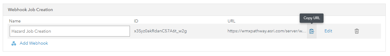

Once complete, the changes can be saved, and the URL can be copied for the next step.
Workflow Manager created webhook, copy URL button

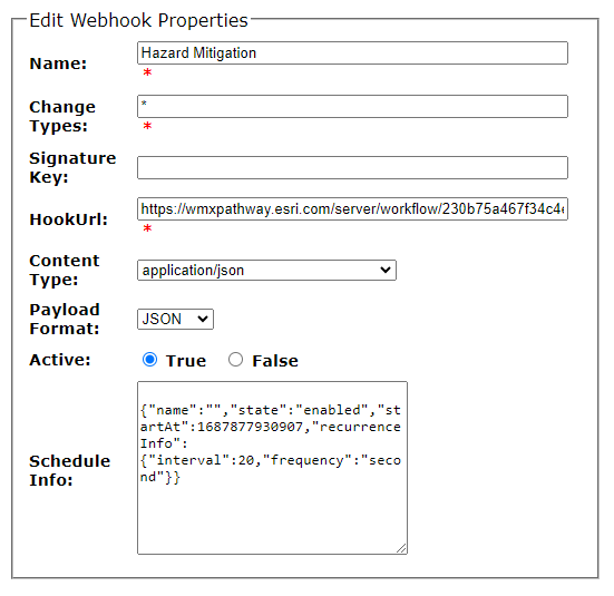

At this point, the webhook can be created in ArcGIS Server. We’ll use the URL copied from Workflow Manager as an input in this process.
ArcGIS Server feature service webhook setup, properties dialog

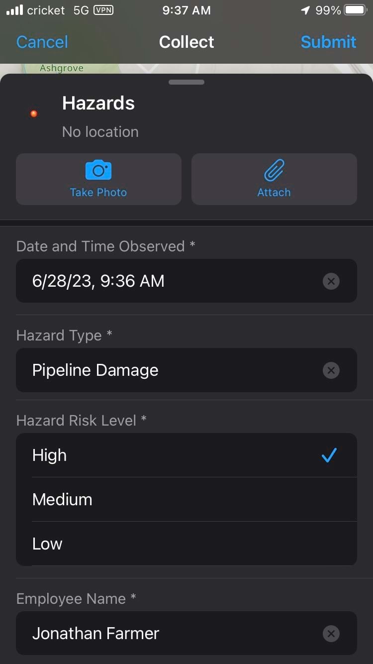

In ArcGIS Field Maps, a new hazard issue is recorded and submitted.
ArcGIS Field Maps hazards application, filled out

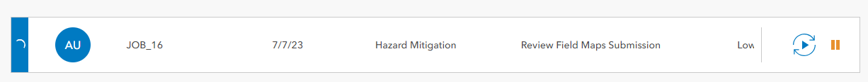

In Workflow Manager, a job is created and the first step runs automatically for us to review the submission.
Workflow Manager job tile for created job

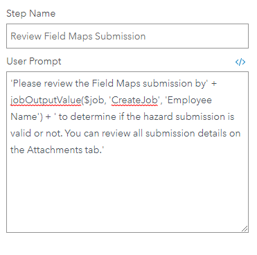

In this workflow, we’ve used the output values from extract changes to insert text into the first step for the job’s assignee to review and determine if this is a valid submission or not.
Workflow Manager manual step with Arcade

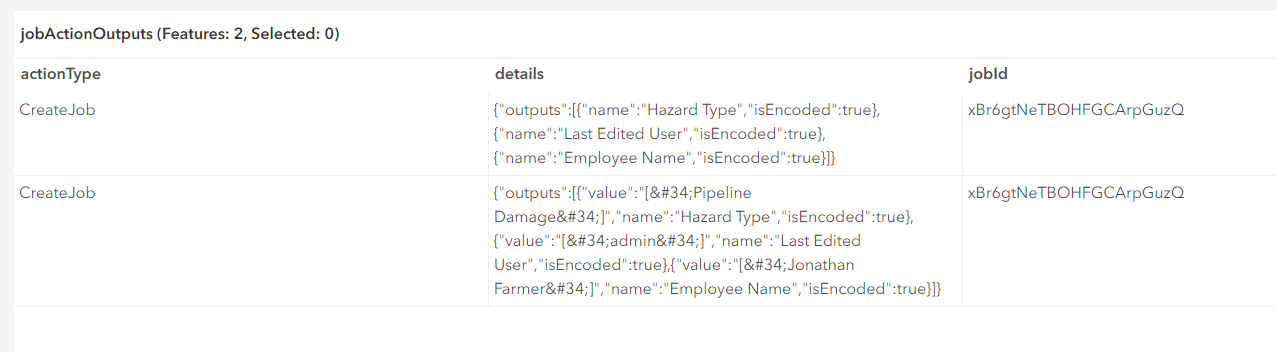

These output values are found in the jobActionOutputs table in the hosted layer.
Note: You must have output values configured on the webhook in order for these entries in jobActionOutputs to be present. If you’re not sure how to configure the output values for your webhook request body, you can view the documentation for the endpoint or configure the webhook to attach the payload to the job and fire off a test, where you can then use that information to configure the output values.

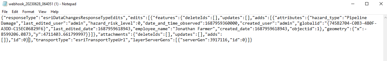

The raw extract changes payload is attached to the job as well since we specified that during webhook receiver creation.
Note: The first step in your workflow must be run before the extract changes attachment is added to the job. If the first step is a manual step, you will need to run that step in order to see the second attachment on the job.

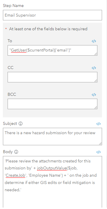

Workflow Manager Send Email step with Arcade
The Send Email steps utilize Arcade to pull information from the extract changes’ output values to dynamically display information that is relevant to the email recipient. You can start to see how extract changes can be valuable when working with feature service webhooks in Workflow Manager. We won’t go through this entire workflow in this blog but let’s take a look at the automated workflow example mentioned earlier to see how these extract changes output values can be used there.

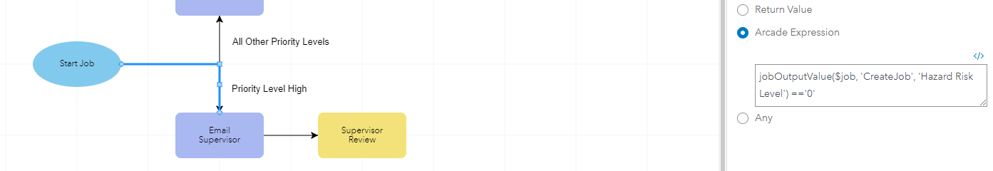

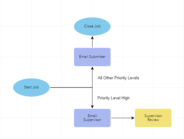

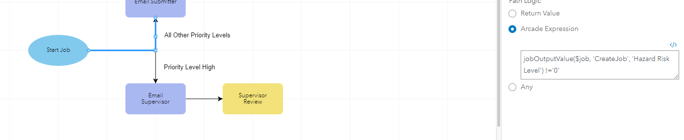

As mentioned earlier, the workflow above had a manual review process and used the extract changes’ output values as inputs to steps to produce dynamic text for each submission and job. Another use-case for extract changes’ output values is to use them to drive the workflow one direction or another. In the following example, we can direct the workflow down a path determined by the priority level of the Field Maps submission.
Workflow Manager high priority path
Workflow Manager all other priorities path
This has the potential to run parts of this workflow completely hands off. When the Field Maps submission is received, the Start Job step will run automatically. If the priority level is a value other than High, an email can be automatically sent to the submitter notifying them that the job will be closed, and the job closed without a user ever touching Workflow Manager.
