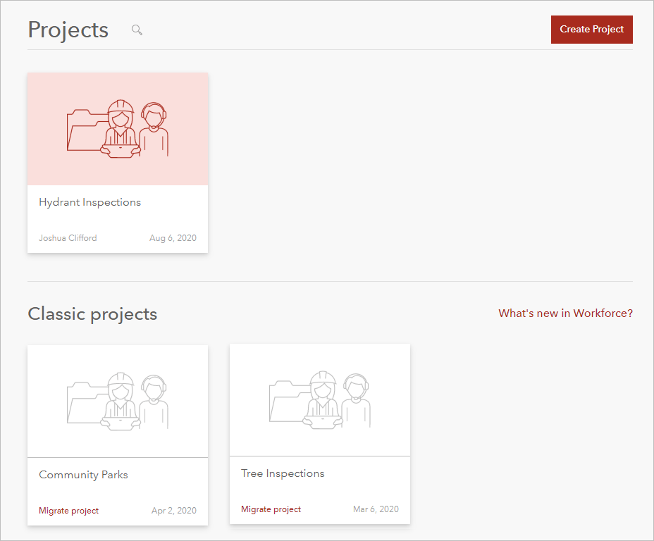

The August 2020 release of ArcGIS Workforce allows you to create projects that are enabled for offline use. Projects created prior to this release are now categorized as Classic projects and listed in the Classic section of the Projects page.
Project page displaying projects enabled for offline use and Classic projects
While you can continue to manage your Classic projects using the Workforce web app, clicking Create Project will only create projects enabled for offline use in ArcGIS Workforce. To create Classic projects for use in Workforce for ArcGIS, you must use ArcGIS API for Python.
