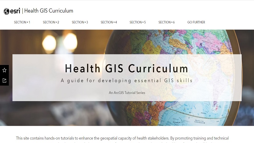

For more tutorials like this, see the Health GIS Curriculum, designed for enhancing and modernizing the geospatial capacity of health stakeholders. From essential GIS concepts to analytics, field work and collaboration, learners will gain a breadth of experience using GIS with multiple ArcGIS software products.
