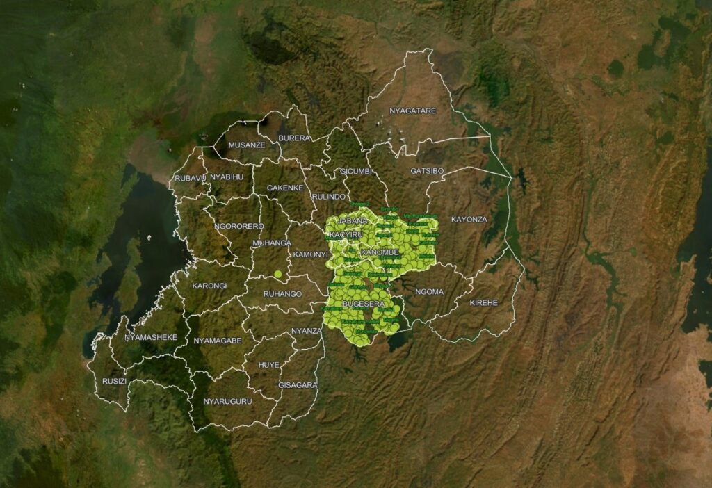

The initiative began with a pilot in one of Rwanda’s 30 districts. Although the work is still underway, the pilot is already demonstrating how a modern GIS can expose data-quality issues, improve field-data collection, and provide a stronger foundation for asset management and future network planning.
The implementation pilot area is one district out of 30.

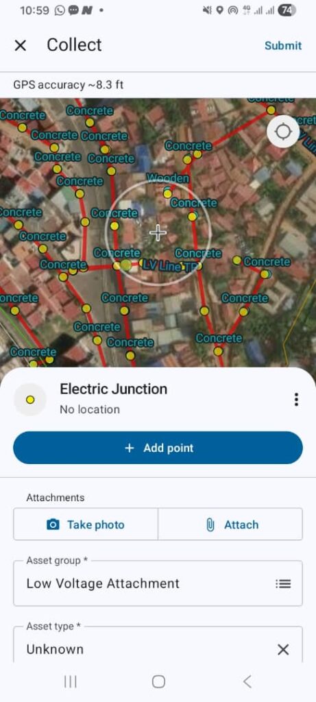

Using ArcGIS Field Maps and standardized data-collection forms, approximately 80 field workers began capturing network information in the pilot district. The new forms were designed to collect consistent details about electrical infrastructure, including poles, transformers, conductors, and other network assets, as well as information about asset condition that had not been consistently captured in the past.

REG leverages ArcGIS Field Maps for full system data collection.

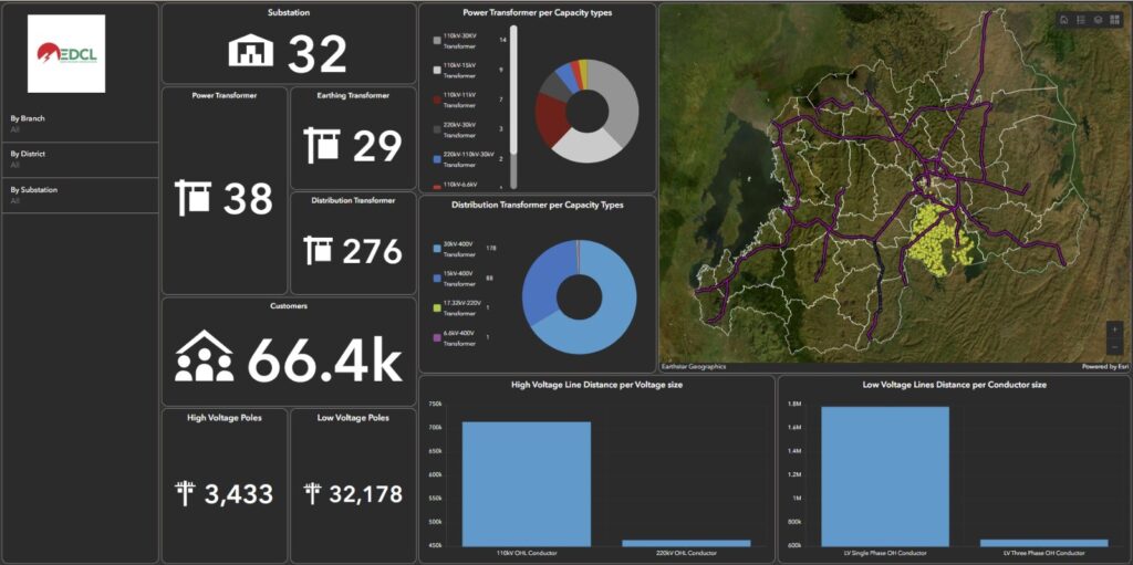

The information feeds into the enterprise environment and the ArcGIS Utility Network model, creating a common structure for the network rather than a collection of disconnected datasets. REG has also built dashboards connected to the data to support visualization and monitoring.

ArcGIS dashboard illustrates project progress.
The second collection effort has produced significantly better data. The team estimates that approximately 80 percent of the first district had been completed.
