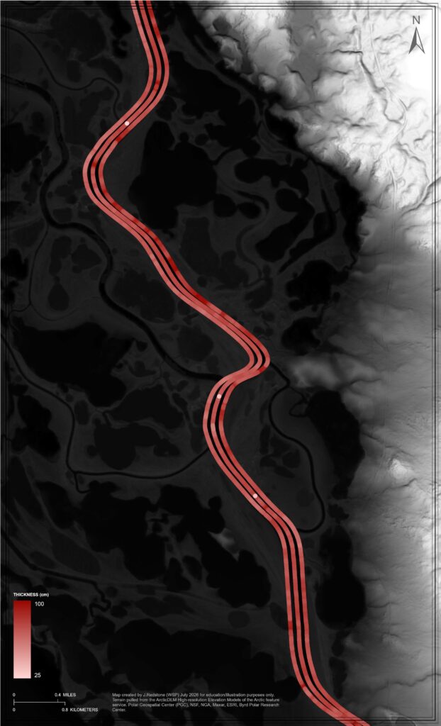

Terrain model combined with the ice road depicting an arctic GPR work area

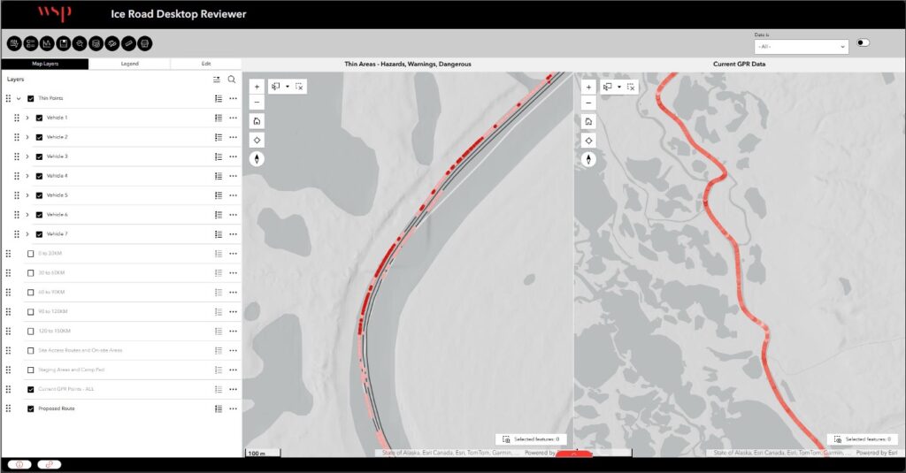

WSP’s Ice Road Desktop Reviewer app with GPR data indicating thin points and proposed route
After the process became more predictable, the team used ArcGIS Pro tasks to operationalize expert knowledge. The task pane in ArcGIS Pro embedded workflow documentation, processing guidance, operational checks, and step-by-step instructions into the analysis experience. Instead of relying on one person to remember and execute every detail, WSP created a guided process that enabled consistent execution by additional staff.

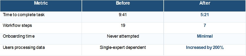

The new ArcGIS software based workflow reduced reliance on a single expert while improving consistency, repeatability, and scalability. The number of users processing data increased by 200 percent, allowing work to be delegated without sacrificing quality.
Operational results were measurable. The time to complete a representative task dropped from nine minutes and 41 seconds to five minutes and 21 seconds. The number of steps was reduced from 19 to 7. Onboarding, which had not previously been attempted because of the complexity of the process, increased by 200 percent.
