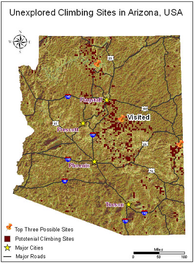

This is a map of unexplored climbing sites in Arizona.

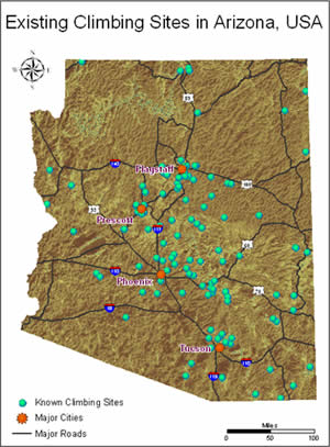

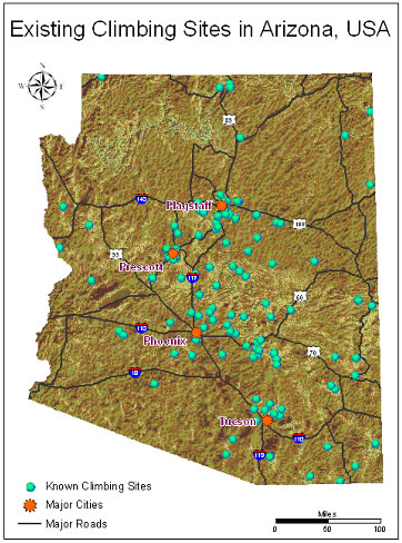

Using his knowledge of the various aspects of rock climbing and their importance, the group decided that an ideal climbing location possessed a limestone, dacite, or volcanic lithology; a height of around 1,000 feet; a location near a river, stream, or creek; and a maximum hiking distance of two hours from the nearest road. After collecting Arizona state and county boundaries, hydrology, transportation, property ownership, U.S. Department of Agriculture (USDA) Forest Service access roads and trails, lithology, and hillshade shapefiles, the group gathered a total of 127 known sites.

This map shows existing rock climbing sites in Arizona.
The team members then used ArcGIS to identify and analyze the distribution of known sites and pinpoint potential sites. They applied a ranking system to the potential sites, narrowing them down to the top three locations for the physical exploration needed to assess the quality of the rock surface. In Wildcat Canyon, the favored of the potential sites, the team members surveyed two separate areas using a handheld GPS unit. Comparing the locations of the projected sites with the actual sites, they found that site A was offset by 7.4 miles from the actual site, and site B had a difference of 2.5 miles. While both sites had the correct requirements based on the ranking system, Scully determined that the quality of the rock was highly suitable for further investigation.
