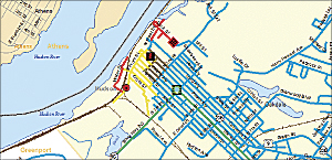

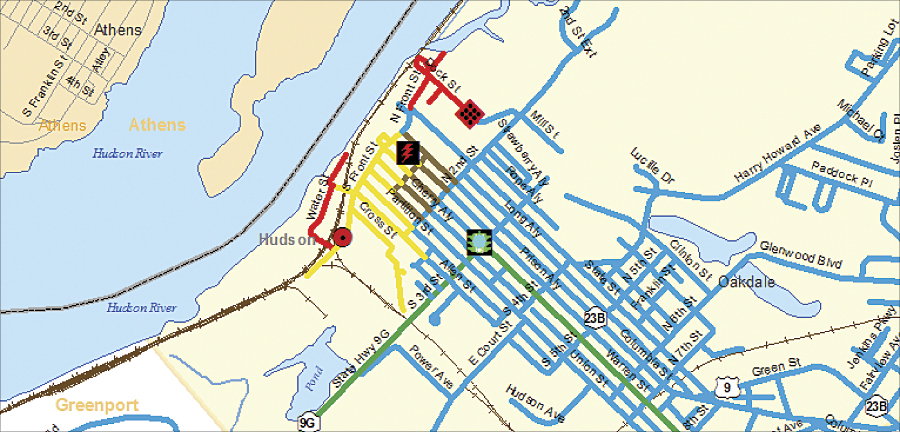

  see enlargement
The New York State DOT's ArcGIS Server environment provides complete road status and damage assessment information to emergency operations staff in its main office, regional office, and emergency operations center.

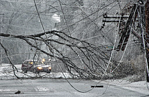

  photo of ice storm
Weather can seriously affect New York State road conditions.

The first true test of the Road Status/Damage Assessment tool came in December 2008 when an ice storm severely crippled New York's Capital District and surrounding areas. Columbia County was hit especially hard with downed trees and power lines, effectively shutting down much of the state and local highway system. The emergency operations center (EOC) began sending out assessment teams with RSDA on Sunday, December 14. Comprehensive information on the status of the highway system, as well as detailed damage assessments, was uploaded to the enterprise geodatabase, and the road status was continually updated during the week. Decision makers in the main office incident command center and the local EOC could easily view this information in the ArcGIS Server software-based RSDA Viewer.
The NYSDOT emergency operations center used information collected by RSDA to prioritize repair and cleanup work. The map-based view of damage assessments provided crews with a view of problems nearby, allowing more work to be accomplished on a single trip. The RSDA Viewer was provided (via Citrix) to Columbia County's EOC. By using the same operational picture at both locations, the state and county were better able to coordinate their response activities.
