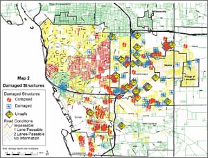

Although other places receive more snow, Buffalo has earned a reputation for the occasional severe snowstorm. Located at the northeast end of Lake Erie, Buffalo is a prime target for "lake effect" snow. As the prevailing winds cross the lake, they pick up moisture and dump snow when the frigid air comes ashore. On Christmas Eve, December 24, 2001, a classic lake effect storm pounded Buffalo and the surrounding communities. This storm broke records not only because of the amount of snow but also because it marked the first time Erie County utilized GIS for emergency response. The County used GIS for tracking and communicating the status of street conditions and storm-damaged structures and to inventory snow-dumping locations, as well as maintain a map history of the response effort. A Seven-Foot SnowfallEven though the residents of Buffalo and Erie County are accustomed to dealing with significant amounts of snow, a seven-foot snowfall presents an enormous challenge. Fortunately the storm began Christmas Eve. Schools were not in session, and many people were off work. These two facts spared the area from a real disaster. Stranded students and many more stranded motorists would have seriously complicated a bad situation. By the afternoon of December 28, it was clear this was no longer a snowplowing effort--it became a snow-removal effort. Six to seven feet of snow clogged roadways and collapsed roofs and even entire structures. Abandoned vehicles made roads impassable. Snowplows could not function in many areas. Neighborhood streets, and everything on them, disappeared under the snow. Travel bans went into effect throughout the region. In Buffalo, more than 70 percent of the streets were either totally impassable or had only one lane open. Applying GIS to the EmergencyThe magnitude of the snowstorm drew assistance from the National Guard, neighboring counties, even crews from Toronto, Canada. When coupled with the local highway crews, there was a lot of equipment available--the problem was where to deploy it. The County established an Emergency Operations Center (EOC) to coordinate the efforts.

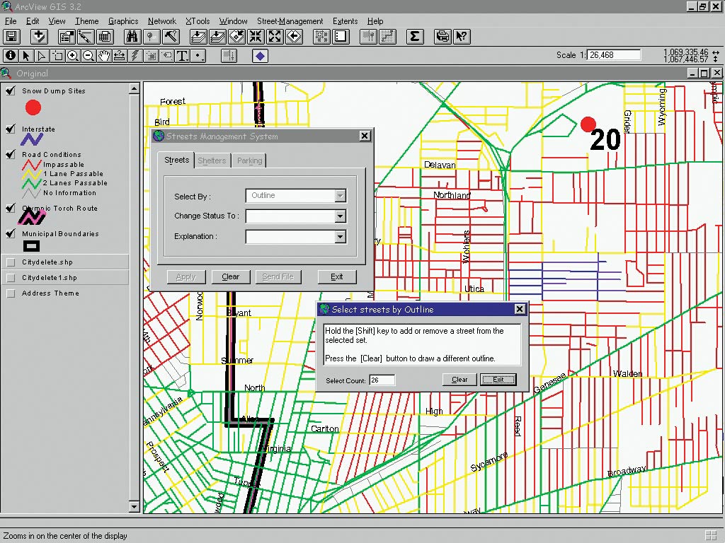

The New York State Department of Transportation (NYSDOT) set up shop at the EOC. While NYSDOT typically uses a five-level rating system for evaluating highway conditions, the decision was made to use just three levels for this emergency. Roads were color coded
The EOC sent out road assessment teams on four-hour shifts with paper maps and color markers to record road conditions and to report back to the EOC. EOC officials called the Erie County Office of Geographic Information Services to assemble a GIS operation at the EOC. Within hours, the office moved three computers, a large-format plotter, and a printer to the EOC. GIS personnel from several local public agencies and private firms were brought in to the EOC, in some cases by the National Guard in Humvees. This rapid response was due to a fortunate turn of events. Just weeks preceding the snowstorm, the GIS Resource Group of D'Alba & Donovan GIS Consultants (Williamsville, New York), an Esri Business Partner, and Mark Harris of GeoSnap (Lackawanna, New York) developed a Streets Management System for the City of Buffalo. This ArcView extension allowed users to rapidly assign a status (open, closed, restricted) and an explanation (construction, parades, plowing, etc.) to selected streets. Users could select individual street segments or draw polygons to select large groupings of segments. The group modified the tool to accept the NYSDOT red, yellow, and green road status, and the GIS was operational. Using the Streets Management System, GIS staff entered the NYSDOT assessment team data into the GIS and calculated the total miles of road in each category. The EOC sent the teams back out with fresh maps to continually reassess the conditions. With each update, NYSDOT, County, and City officials directed plow crews to the areas in need. This interaction between the ArcView application and road assessment teams continued 24 hours a day for the first five days. To help the crews haul the snow away, locations of snow dumpsites were entered into ArcView. This information was especially useful to out-of-town crews unfamiliar with the local streets. As damage reports came into the EOC from local emergency response officials, building locations were geocoded to display collapsed, damaged, or hazardous conditions (gas leaks, no heat, etc.). A complete history of the response efforts was mapped in ArcView. Plots were produced every five to seven hours and posted on the EOC walls. At the same time, PDFs were generated and posted on the Web for public officials. The resulting maps became part of the record reviewed by the Federal Emergency Management Agency (FEMA). While not yet final, local officials have estimated the cost of the snowstorm in excess of $30 million. Lessons LearnedThis experience underscored some important points.
