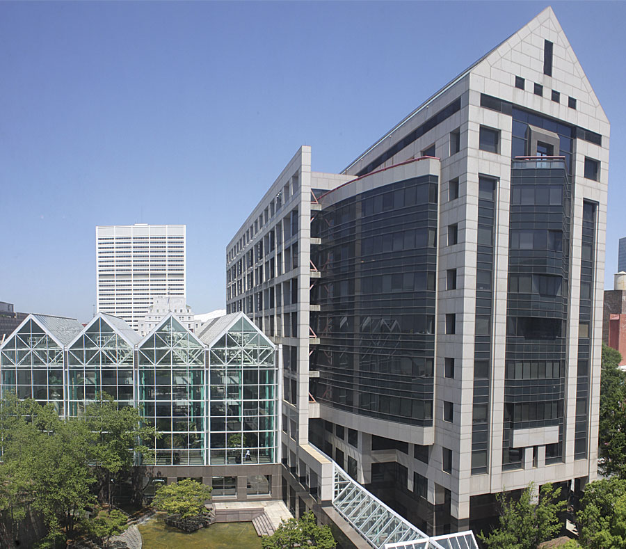

A 3D model of the interior of the Fulton County government center shows general locations in the buildings and includes two-way links to a very specific 2D floor plan map.

A 3D rendering of the Fulton County center made it easy for administrators to conceptualize changes to the building's exterior and grounds.
