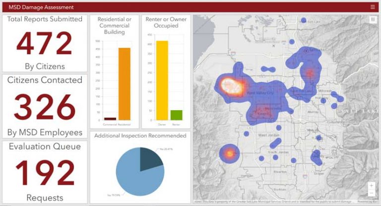

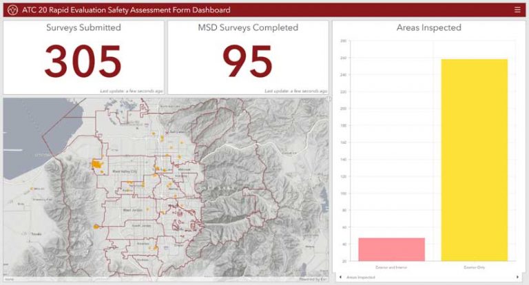

A dashboard provided up-to-date information on the progress being made in assessing damage using ATC-20 Rapid Evaluation Safety Assessment Forms.

MSD disseminated forms to the public within a few hours via MSD hub sites, social media platforms, news outlets, and municipal websites. These forms helped the MSD gather information quickly and provided better overall service. The Federal Emergency Management Agency (FEMA) requires inspectors to fill out an ACT-20 Rapid Evaluation Safety Assessment for each damaged structure to determine if the public can safely return to homes and businesses. [ATC-20, developed by the nonprofit hazard mitigation corporation Applied Technology Council, is the standard form for evaluating the safety of buildings after an earthquake.]
Within an hour, the ATC-20 paper form, available from the FEMA website, was converted to a live survey. Using mobile devices, each field officer could assess structures. Local authorities, who viewed real-time monitoring of the damage to buildings in the valley using dashboards, could make data-driven decisions about emergency response.
Izabela Miller, operations manager with MSD, said her team worked with emergency management staff to ensure the information collected was sufficient for determining whether in-person inspections of structures were necessary. Salt Lake Valley residents could submit requests for inspections, no matter where they lived.
“Nature doesn’t respect boundaries, and during an emergency, cross-jurisdictional local government cooperation should reflect that in the response,” she said. “Using Survey123 and our Damage Assessment Operations Dashboard, we were able not only to reach out to citizens but also to visualize where the damage hot spots were by using the heat map capabilities of ArcGIS Online applications.”
On July 9, 2020, FEMA officially declared the Magna quake an active disaster, making individual assistance available for residents in Salt Lake and Davis counties. As of August 2020, the agency had approved 47 applications from individuals that would provide $154,407 in housing assistance. The nationwide COVID-19 emergency has caused FEMA to use remote inspections to assess damage to homes in Salt Lake County.
Using ArcGIS Survey123 and ArcGIS Dashboards, MSD could reach out to residents and visualize the distribution of damage using the heat map capabilities of ArcGIS Online, displayed in the dashboard.
