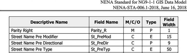

The model specifies how fields should be named, what data needs to be in each field, the field type, and the field width.
An excerpt from the Road Centerline attribute table description in the NG9-1-1 GIS Data Model.

The NG9-1-1 GIS Data Model calls for the street layer to have 52 fields and the address point layer to have 46 fields. Each of these fields will have to have a specific width, field name, and field type. Fields fall into three different categories: mandatory, conditional, and optional. Mandatory (M) fields must hold an attribute and cannot be left blank. Conditional (C) fields hold an attribute if that attribute exists. Optional (O) fields may or may not be provided.

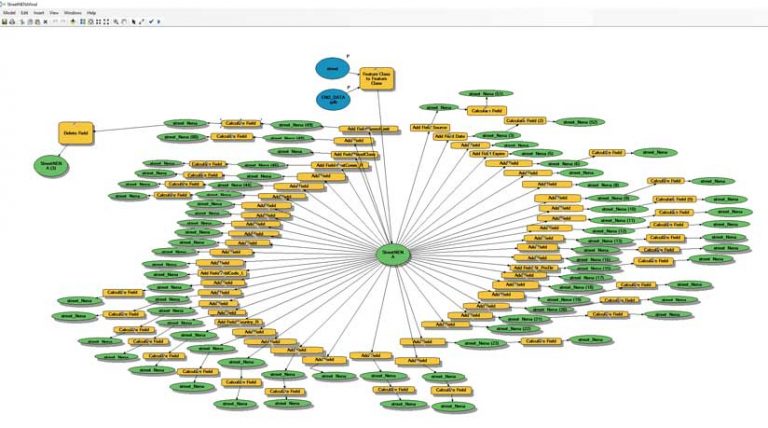

To add the new fields and populate them with data, you want to consider using a model. Since your model will be rather big and time-consuming to create, using ModelBuilder lets you slowly finish it. Your model will incorporate many Add Field and Calculate Field geoprocessing tools. Use he Calculate Field geoprocessing tool to calculate data for a newly added NG9-1-1 field using an existing field and modifying its format as required.
Where Do You Maintain Your GIS Data?
Once you are done building your model, you can run it on live data. If your data resides in an ArcGIS Enterprise environment, make sure to analyze and compress your data once the model finishes running. Making this many changes to your dataset will slow down your features when editing them in ArcMap or ArcGIS Pro. You may not be able to populate some fields using your model, so you will need to finish them manually. To maintain the best performance, make sure to run analyze and compress once you finish each field.
