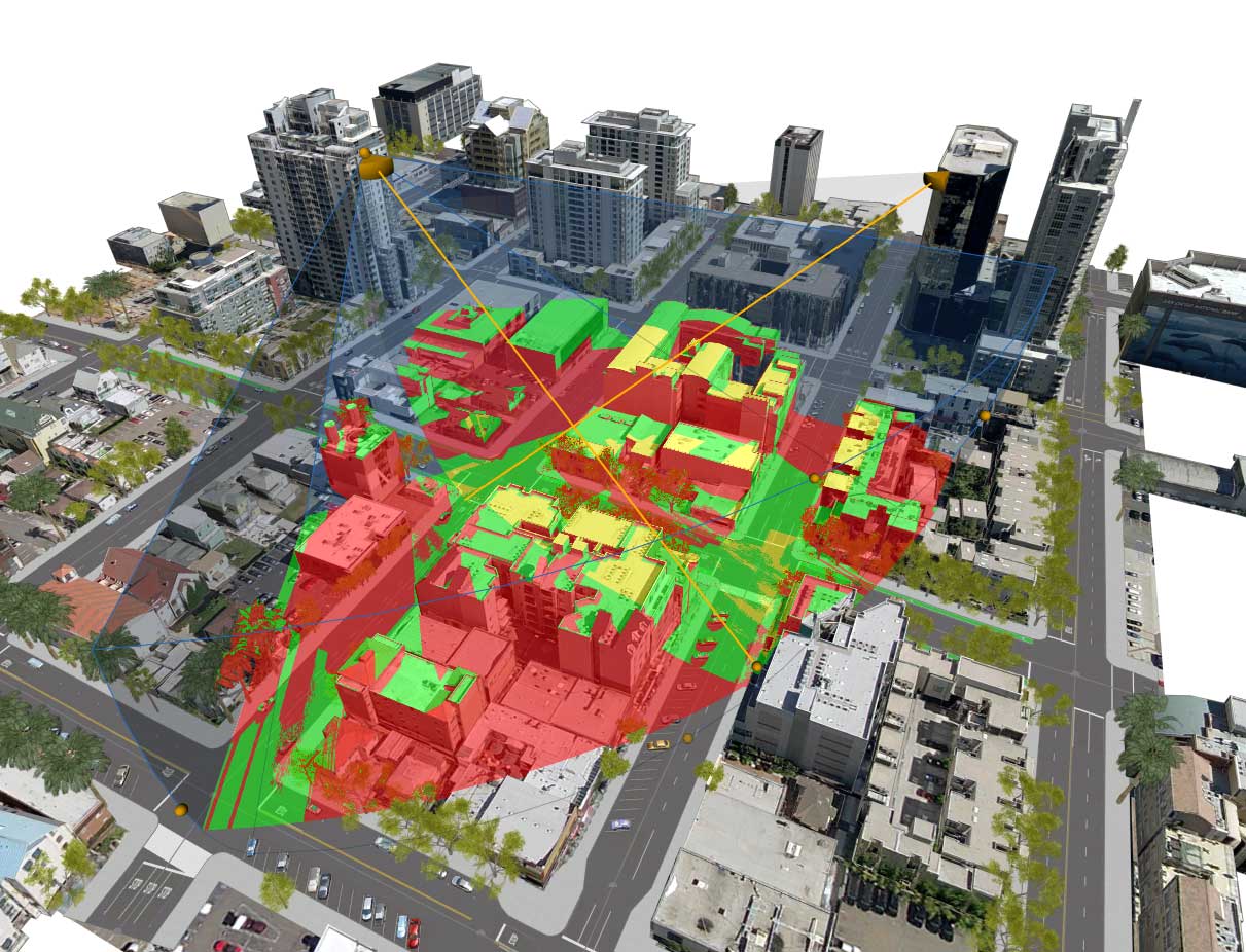

  2. Next, you’ll drop two points into the scene. The first point you drop will be the observer feature, or what point the viewshed will be created from. Click to start the viewshed tool and a line dynamically displays the Viewshed as you move it to set target, or the second point.
  3. After clicking on both of those points, your viewshed is created! You can edit the viewshed by clicking on either the observer or target points and moving them.
  4. Everything in green is what can be seen by the observer; everything in red represents what is within the viewshed extent, but not visible from the observer’s vantage point.
Note: you can create multiple viewsheds, and see how they interact with each other. Where the viewsheds overlap, the color will  be yellow.

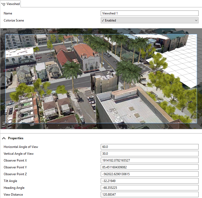

You can also edit your viewshed in the Inspector window. After you drop the two points to create the viewshed, you’ll see the object is added to the Scene editor. By clicking on the object in the Scene editor, the layer will become active in the Inspector. The Colorize Scene property allows you to choose whether you want to display the colorized visible or hidden areas in the 3D viewport. The preview shows the view from the observer point, enabling a more comprehensive understanding of the viewshed. You can also manually edit the View Distance, location, and angle of the viewshed in the properties section.

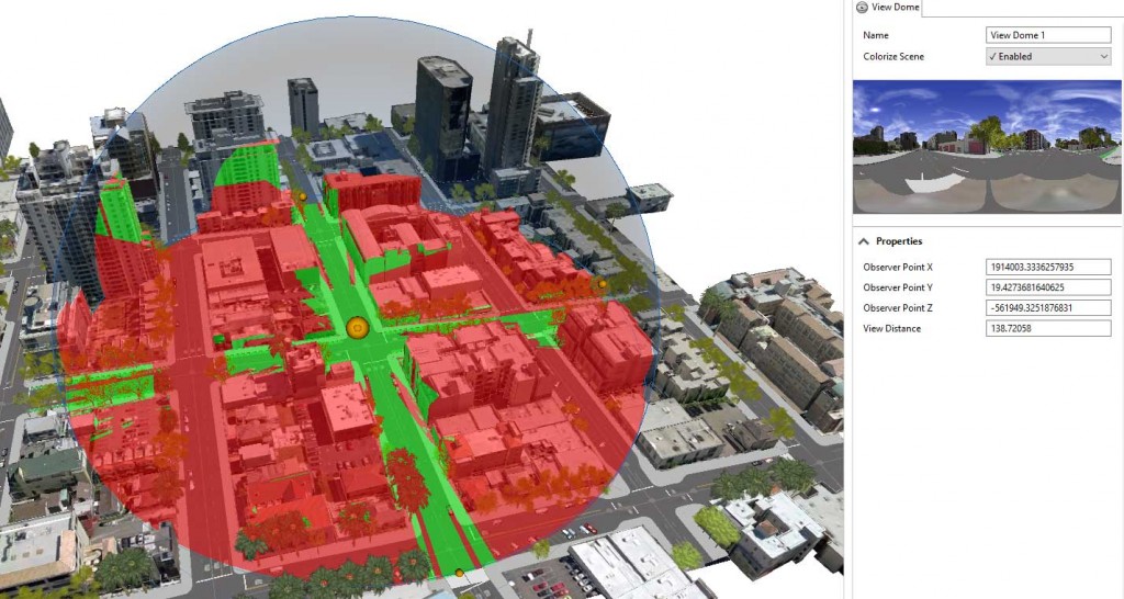

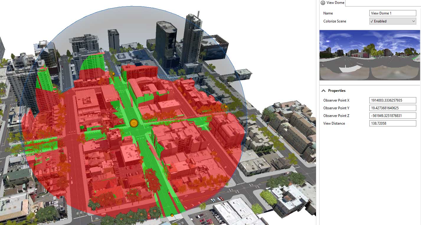

View Dome Tool
The View Dome tool gives you 360-degree visibility from a single spot, and can work with multiple points to show where visibility coverage overlaps. Both the Viewshed and the View Dome tools are designed to easily allow you to identify visible and non-visible areas of your 3D model from one or multiple observer points. You can quick edit the observer point, point of interest, and the field of view in the 3D viewport using handles that become interactive when the scene object is selected. Manual control over these parameters is available in the Inspector, similar to the Viewshed Creation tool.
To create a View Dome, activate the tool on the top left ribbon in CityEngine, and click on anywhere in the scene to set the observer point. Once the point is set, you drag to create the View Dome. Once created, the View Dome is automatically selected, and you can directly adjust its properties, such as the view distance in the Viewport using handles or in the Inspector using input fields.

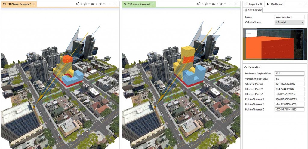

View Corridor Tool
The View Corridor tool can be used to determine which buildings interfere with a view corridor. View Corridors protect established views from a given observer against building development obstruction. To support this use case, the tool creates a protected view where any scenario building visible in the corridor is colored. This makes it easy for you to design your proposals to fit optimally into your city model, without disrupting the View Corridor.
Note: View corridors are designed to analyze scenarios. It is recommended to create scenarios first before creating the view corridor objects because only buildings in a scenario are colorized by the View Corridor.
To create a View Corridor, follow these simple steps:
  1. Activate the tool in the top left ribbon in CityEngine.
  2. Click a point in the viewport to create an observer point. This starts the View Corridor tool and a line dynamically displays the View Corridor as you move it to set the point of interest.
  3. Click again to anchor the point of interest in the View Corridor.
Once created, the View Corridor is automatically selected, and you can directly adjust its properties, such as the angles of view in the Viewport using handles or in the Inspector using input fields.
