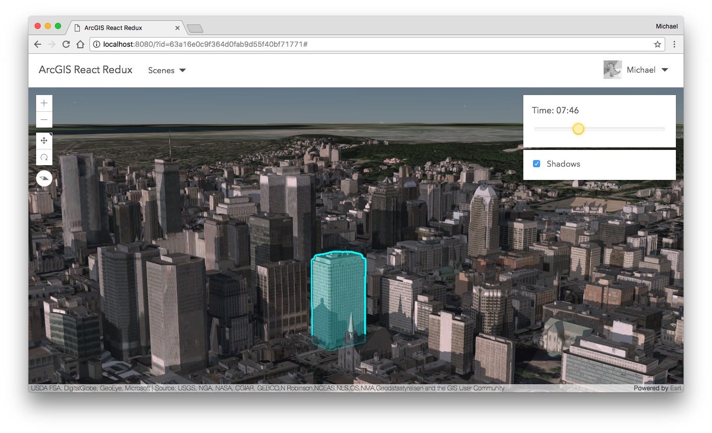

To demonstrate the basics, I created a demo app that lets users sign in with their ArcGIS Online account and open a scene. I added a simple selection tool (Ctrl to select multiple features) and a simple sun position slider.
The source code and installation instructions are available on GitHub.
Demo App Screenshot

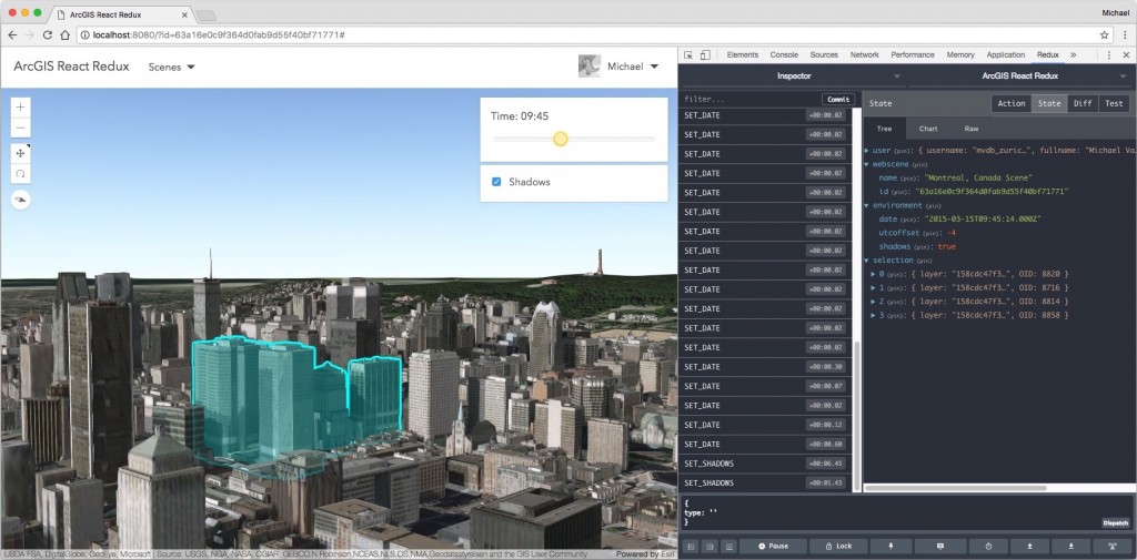

One of the greatest things about Redux is the Dev Tools Extension. This extension lets you inspect the application state live as it updates, and it lets you dispatch actions from the console. This is great for rapid prototyping: you don’t have to build a UI to test a feature.
Redux Dev Tools Extension Screenshot
For example, when developing the sun position slider, I first implemented the SET_DATE action, and added the corresponding environment updates in the SceneView middleware. I could then try to change the sun position by dispatching SET_DATE actions from the console, and see the state update accordingly. Once that was working correctly, I implemented a range slider component to dispatch those same actions.

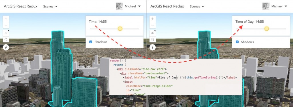

Hot Module Replacement exchanges, adds, or removes modules while an application is running, without a full reload. This has numerous benefits for development:
How it works: when a module is updated, the front end is notified and downloads the changes. For components, the application DOM is refreshed with the updated component. For reducers, the application store replaces its reducer with the updated reducer.
Hot Module Replacement Example
Looking closer, refreshing the DOM would inevitably reload the SceneView after each component update. To prevent this from happening, the SceneView is created and stored in the middleware. In fact, the middleware stores both a SceneView object and its container element. On refresh, the existing container is automatically attached to the refreshed React component.
