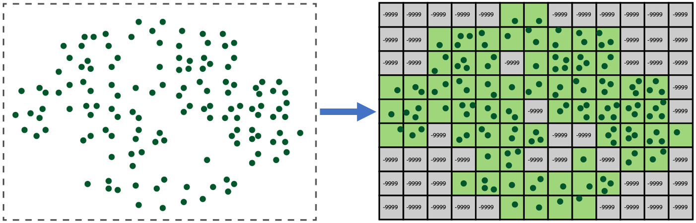

When you create a space time cube, it is always stored as a rectangle representing the extent of your data (or an extent provided by you when you create the cube).

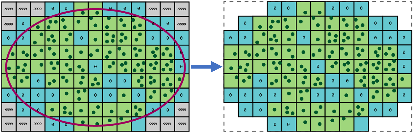

When summarizing a variable within each bin, if a location has ever had data before, empty bins within that location will be filled based on the method that you provide for the Fill Missing Values parameter. However, if a location within the rectangular extent has never had any data before, then that location is stored as a series of -9999 values, indicating that those locations do not have any data associated with them. When you then go on to do further analysis, for those Summary Variables that you filled with zeros, you are given the option to use a Polygon Analysis Mask. The Polygon Analysis Mask allows you to indicate places that could have had data, but did not. For instance, perhaps you have a very safe neighborhood that experienced no crime, but you do not want to leave it out of your analysis. The Polygon Analysis Mask allows you to indicate that anywhere within the mask, even if the location never had data, fill all bins at that location with zeros.

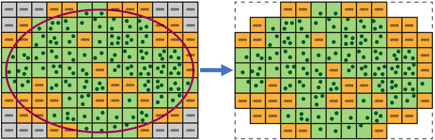

Without the fix, instead of using zeros to fill in locations within the Polygon Analysis Mask that never had data, the tools carry over the -9999 from cube creation. As a result, the value -9,999 is being used for analysis instead of zero. The fix corrects this issue and within the analysis appropriately converts the -9999 values to zeros. Note: You do not need to recreate any space time cubes. Rerunning Emerging Hot Spot Analysis or Local Outlier Analysis with the fix will correct the problem.
A cube is always stored as a rectangle representing the extent of the data. Summary Variables use -9999 as a null value in all locations that have no data.
Without the fix, when using a Polygon Analysis Mask, all locations that are included in the analysis that are stored using -9999 are being brought into the analysis using the value -9999, which greatly impacts the results of the analysis.
With the fix, when using a Polygon Analysis Mask, all locations that are included in the analysis that are stored using -9999 are brought into the analysis using zeros, which is the appropriate value for analysis.
