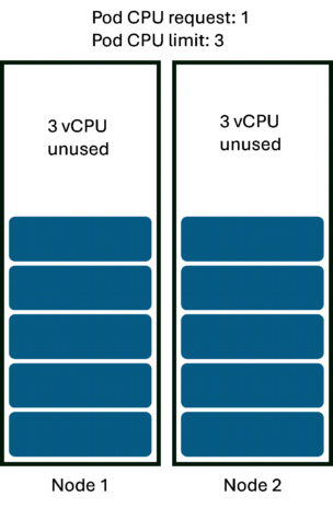

A request is a reservation for a certain amount of a resource, such as CPU or memory. A limit is a cap on resource usage. If a node has unused resources, a pod can use more than its request, up to its limit. When Kubernetes determines which node a pod should run on, it makes sure there are enough available resources to meet the pod’s request, but it does not look at the limits or actual usage.
When the requests are low, many pods can be scheduled on a single node. That can be good because it reduces the cost of the cluster. Imagine we need 10 replicas of a pod with CPU request of 1 and limit of 3. Our nodes each have 8 vCPU, so there is plenty of room to schedule the pods.
10 pods requesting and using 1 vCPU each, scheduled across two 8 vCPU nodes, with 3 vCPU unused on each node.
Two 8 vCPU nodes can accommodate 10 pods that each request 1 vCPU

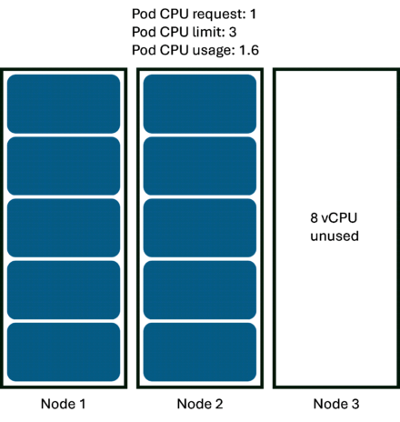

But low requests can also create what’s called a “node packing” problem. What if the pods each need to use 2 CPU to provide responses quickly enough to satisfy users? That’s below the limit, so pods are allowed to use that much CPU, but there isn’t enough total CPU on the nodes for that to actually happen. The pods’ CPU usage is throttled, and users are unhappy with slow responses.
We need a third node to have enough total resources to enable each pod to use 2 CPU. But just adding a third node is not enough. On two nodes, each pod has enough CPU to meet its request, so Kubernetes has no reason to move any of the pods to the new node.
10 pods requesting 1 vCPU and using 1.6 vCPU each, scheduled across two 8 vCPU nodes, with a third unused node
Low requests mean Kubernetes will not move the pods, resulting in an unused node.

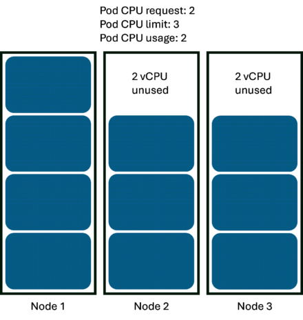

To avoid this problem, we should tune requests and limits based on actual usage. If we increase the CPU request to 2, Kubernetes will move pods to the third node to meet those requests.
10 pods requesting and using 2 vCPU each scheduled across three 8 vCPU nodes, with 2 vCPU unused on each of two nodes.
Increasing requests to 2 CPU forces Kubernetes to reschedule the pods across all nodes
