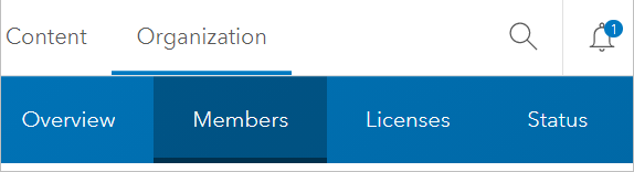

To get started, sign in as an administrator, click Organization at the top of the site, and click the Members tab to see a list of members in your organization.

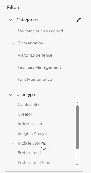

Now take advantage of the filters on the left to find the mobile workers. Under User type, select Mobile Worker to filter the list of members.
With only the mobile workers listed, you can quickly add the mobile workers to the group.

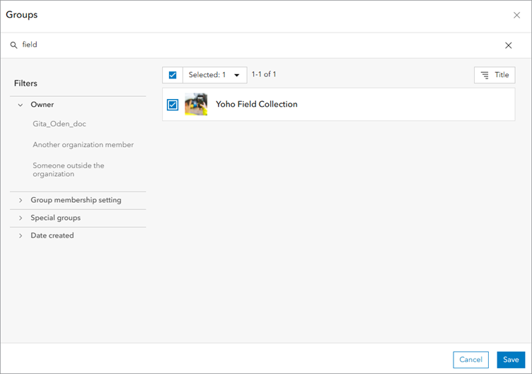

Check the box at the top to select all the mobile workers in the list. Then go to the More menu and click Manage group membership.
Search for the group, select it, and click Save.
The mobile workers are now members of the field collection group.

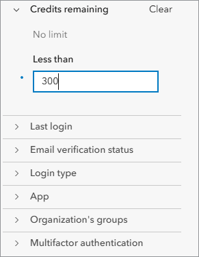

Now expand the Credits remaining filter. You want to find members who have fewer than 300 credits remaining so you can increase their allocation to 500 credits. Under Less than, type 300 and press Enter to filter the members list.

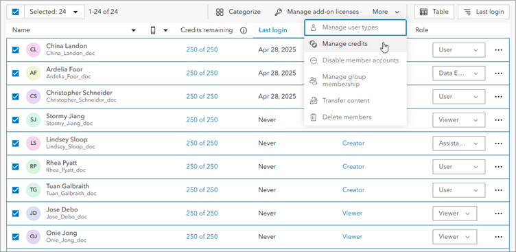

Select all the members in the filtered list using the check box at the top and click Manage credits.
Increase the credit allocation and click Save.

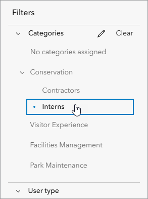

First, filter the members list using the member categories filter. In this case, you want to find interns in the Conservation department.

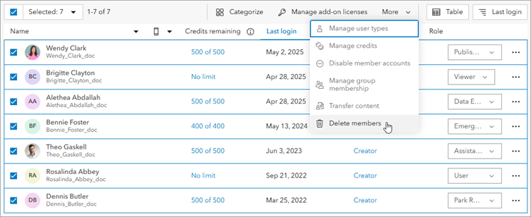

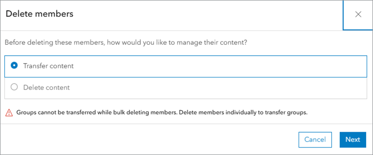

Now select all the interns in the filtered list using the check box at the top, click the More menu, and click Delete members.
You have the option of deleting the interns’ content or transferring the content to another owner.
Note: When deleting members in bulk, any groups owned by the members are automatically deleted; there is no option to transfer them to a new owner. To keep these groups in the organization, you must transfer them to a new owner before deleting the member accounts. You can see a list of group owners in the organization by clicking the Status tab on the organization page and clicking Groups in the status dashboard.
Transferring the interns’ content items to another owner will allow the organization to continue maintaining the content moving forward, so you’ll leave the first option selected and click Next.
